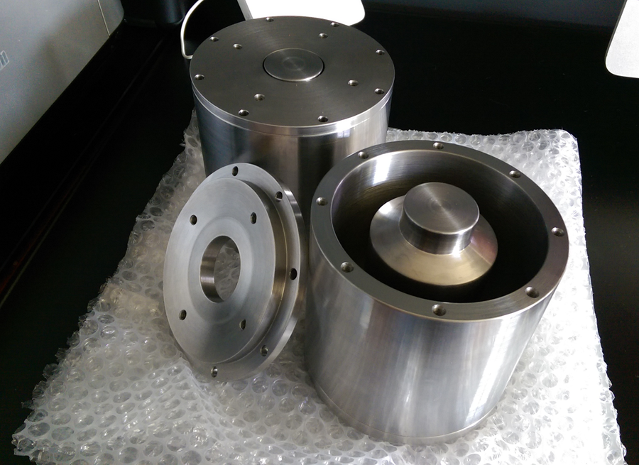

This is an exciting day for me - I picked these beauties up last evening (hope the attachment shows up). Thank you so much for sharing your designs, Hentai - and to everyone on this thread for all the inspiration it's provided. You guys are amazing.
Oh, Look great Gromper ! This is for midrange or tweeter design. How about the voltage to supply to field coil ?

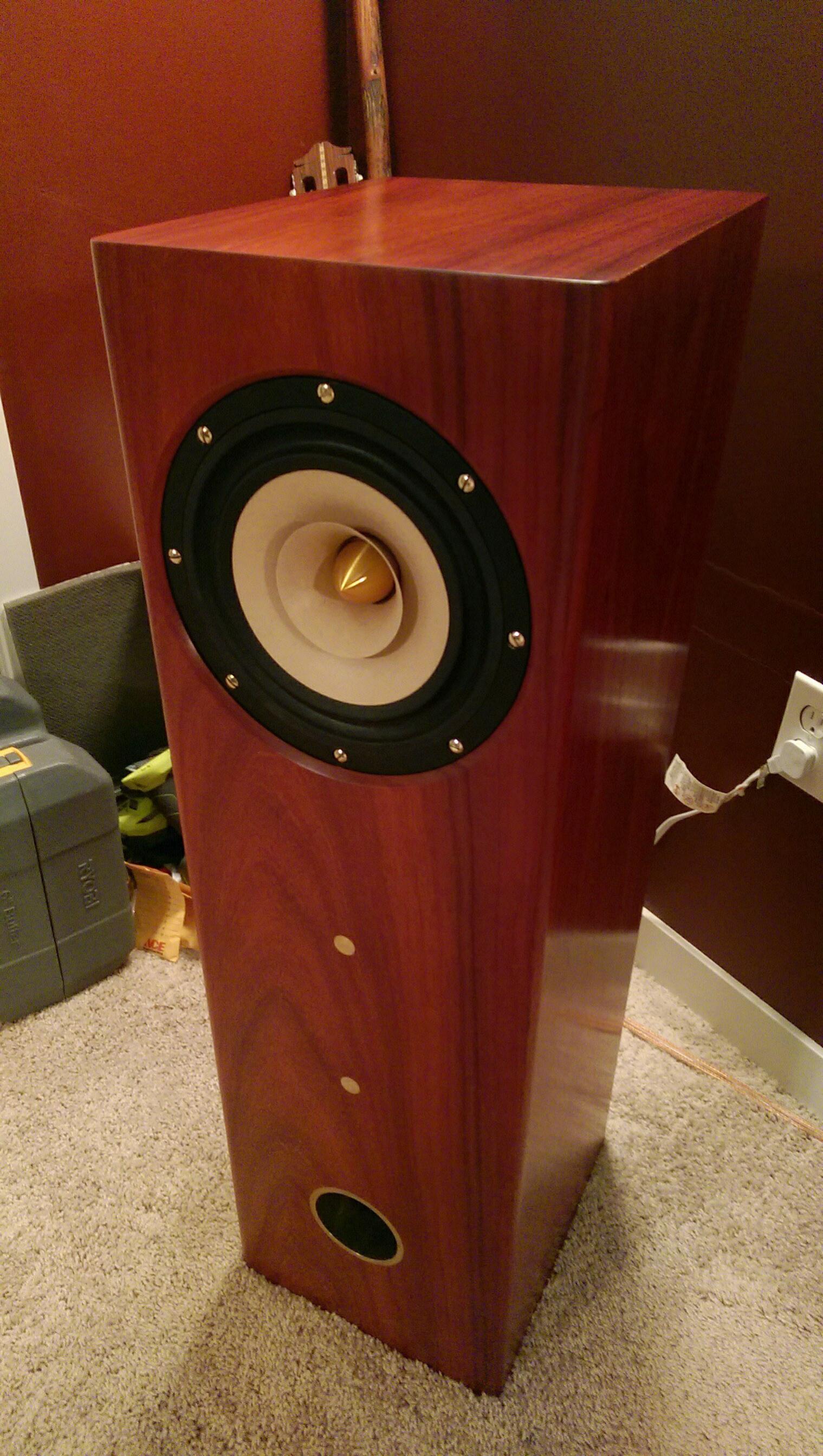

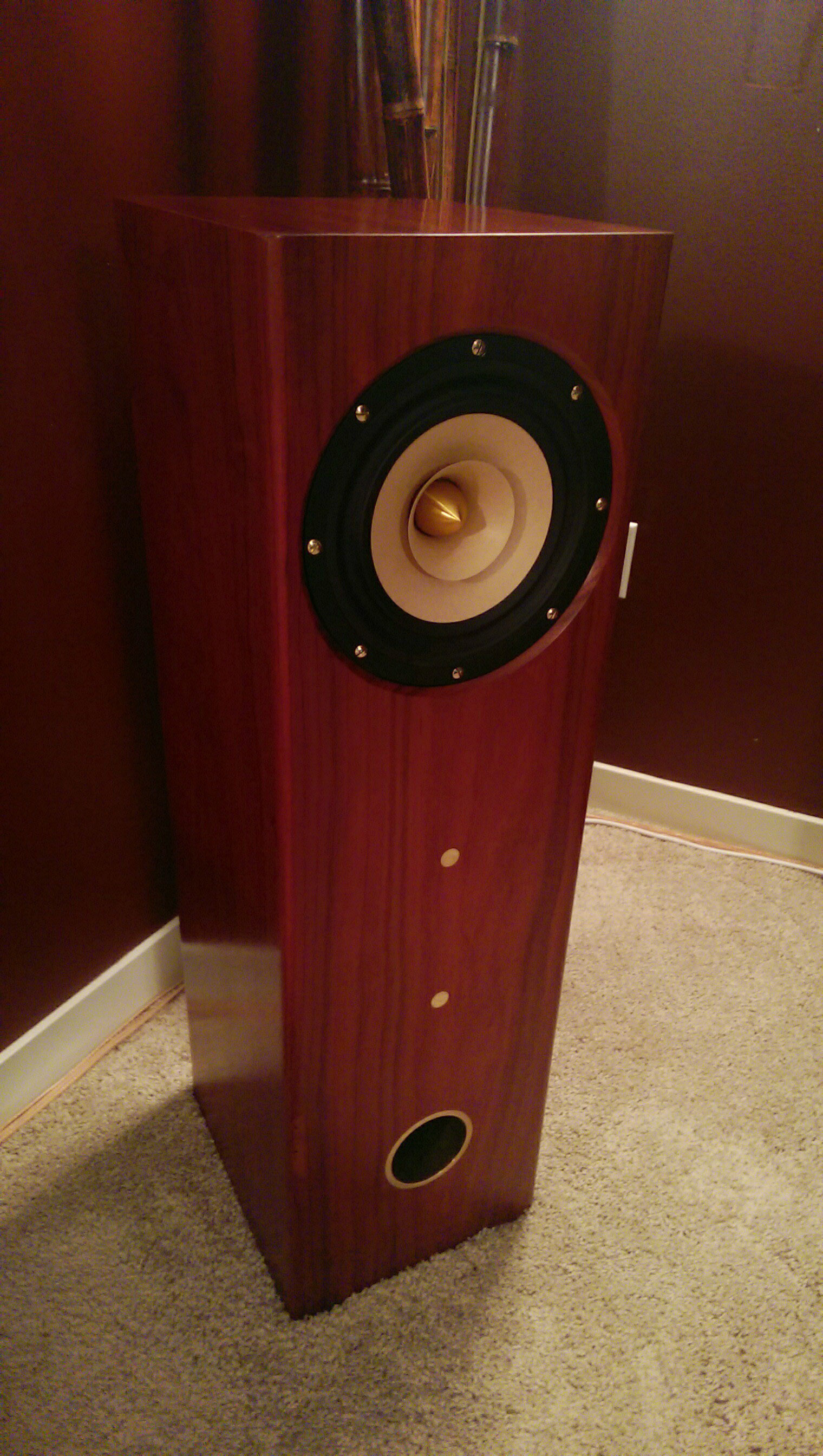

This was my last finished project, a set of speakers made with padauk, brass and Tang Band drivers. That's where my love of full-range drivers got started, and what led me to want to build my own.

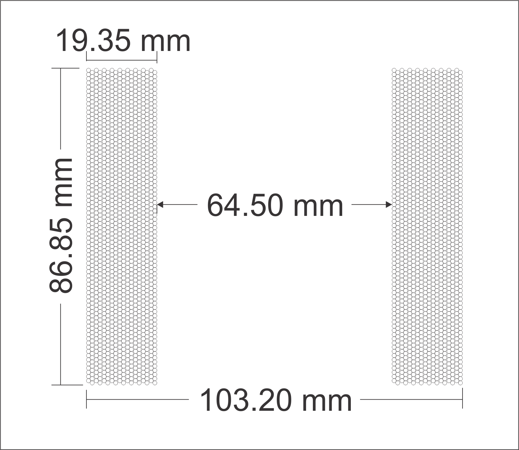

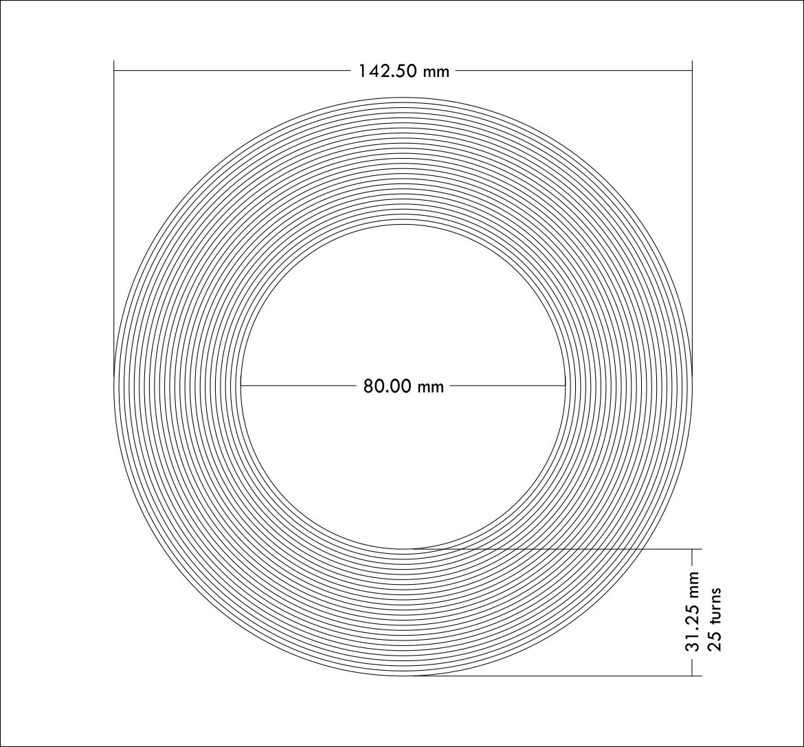

Hi guys,
Almost forgot about the field coil sketches. Gomper here is an example, which if i remember correctly will work well with that structure.
Very nice FieldCoil Adventure, will love to see more of your work.

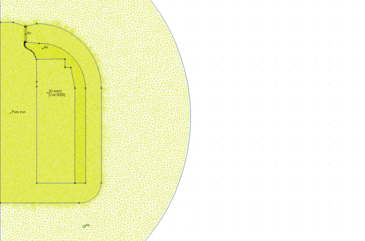

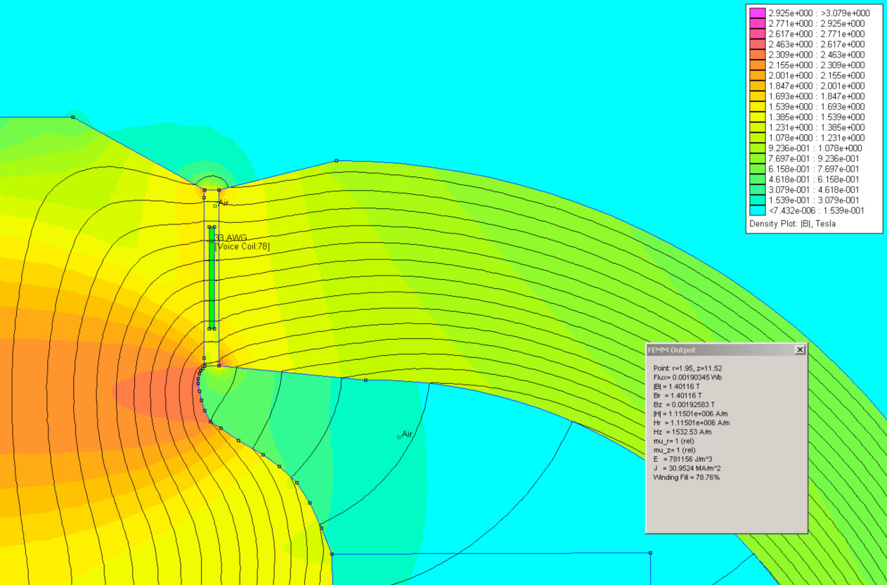

FYI: A field coil (driver) can be simulated in FEMM, here's an example:
FEMM will perform all the calculations for you:
Total current = 0.5 Amps
Voltage Drop = 22.0545 Volts
Flux Linkage = 20.9956 Webers
Flux/Current = 41.9911 Henries
Voltage/Current = 44.109 Ohms
Power = 11.0272 Watts
The voice coil can also be simulated:
Total current = 1 Amps
Voltage Drop = 6.4751 Volts
Flux Linkage = 0.110242 Webers
Flux/Current = 0.110242 Henries
Voltage/Current = 6.4751 Ohms
Power = 6.4751 Watts
Lorentz force (acting on the voice coil):
r-component: 0 N
z-component: -13.7351 N
For simulations of the air gap do not let the application choose the mesh size for the air in the gap, create a separate region of air in the gap and choose a (very) small mesh size (0.1mm or so) to achieve sufficiently high resolution.
regards,
Gerrit
P.S. For these simulations I used pure iron as the material for the motor but later I learned that pure iron in this context means electrolytically deposited iron which has to be annealed in a hydrogen atmosphere after machining, now I just use 'warm rolled steel' or 'cold rolled steel' in the simulations.

Hi Gerrit,
Indeed been using FEMM from the beginning. You are definitely right about mesh size for increased resolution but ofc it comes with the cost of increased simulation time. I usually run simulations first with default mesh size and when i am closer to what i like i increase it.
I am glad you brought it up as it reminded me that i havent showed yet some scripts i made for FEMM last year.
They are available on GitHub (link below) and one can use it to generate a motor structure based on user input data.
https://github.com/Taur-Tech/Project-Ryu---Loudspeaker-Drivers/tree/master/FEMM_Scripts
I invite everyone who wants, to contribute.
You can find a description in the repository and i also wrote an article last month for better understanding:
PROJECT RYU Lua Scripts for FEMM to aid Electrodynamic Loudspeaker Motor Design
So please guys use it, test it and if you find any bugs let me know. I will submit a revised version until summer.

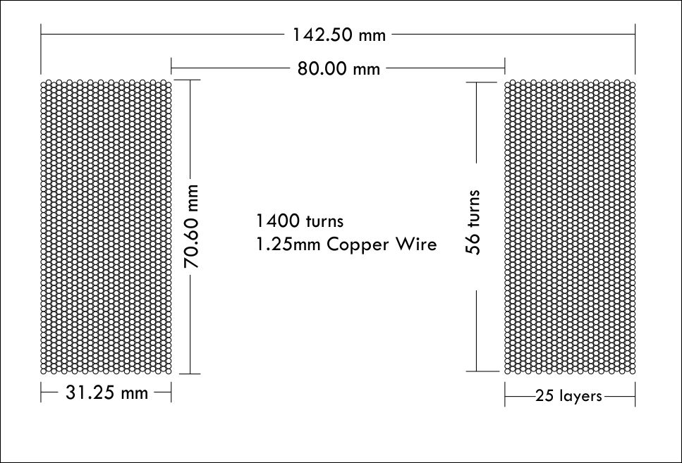

Gerrit, Hentai and FieldCoil, I can't thank you enough for all of your very generous feedback and recommendations. I have installed FEMM this morning and just cloned your repo a few minutes ago, Hentai. I'm somewhat familiar with Lua, and I'd of course love to reach a level of acumen in this endeavor to be able to make some useful contributions to your scripts.
Your timing with the smaller coil diagram is perfect, by the way. I was just at this moment working through what the conductor length would be for the coil using 1.02mm wire wound in 18 layers at an 86mm height.
