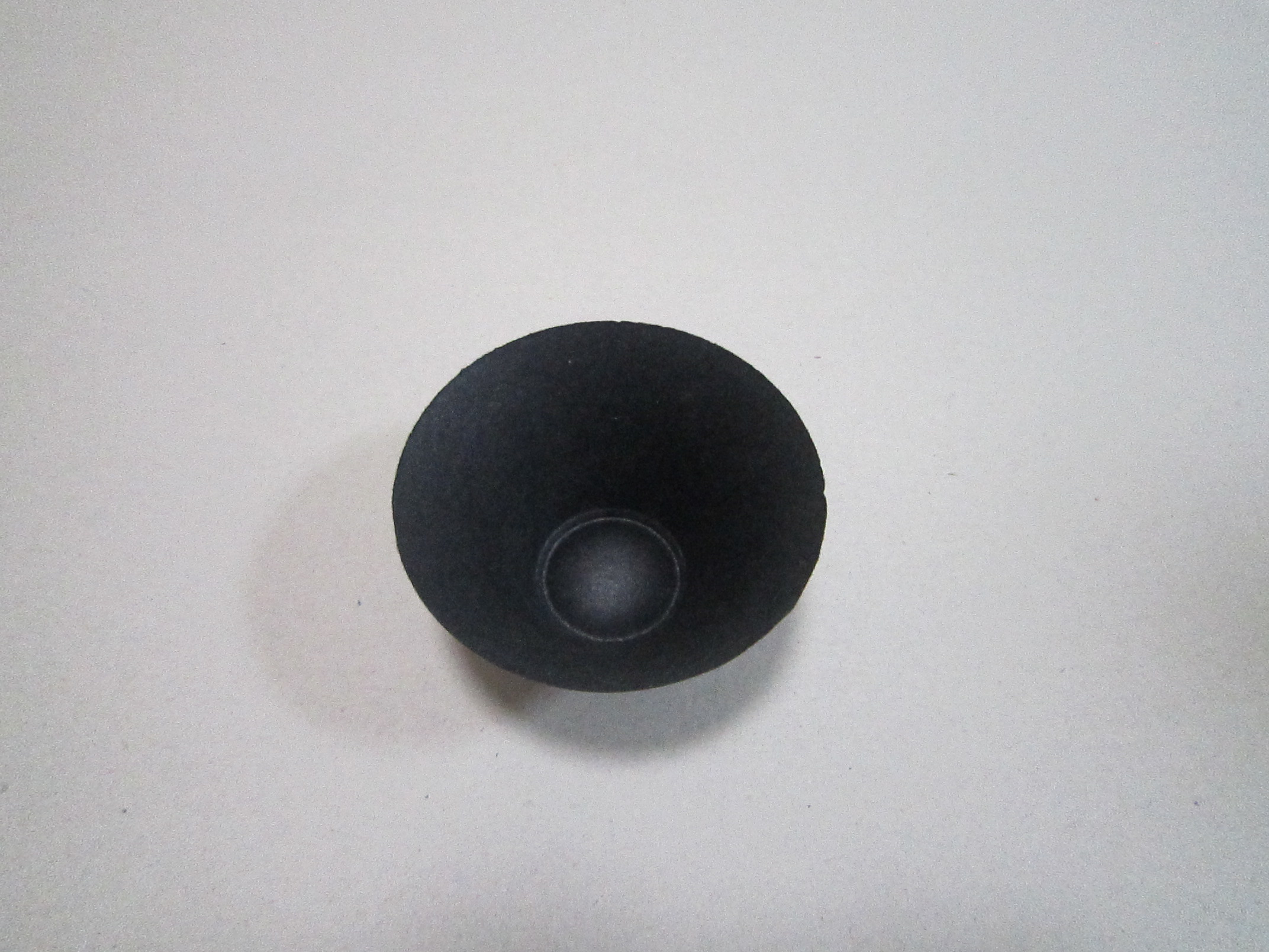

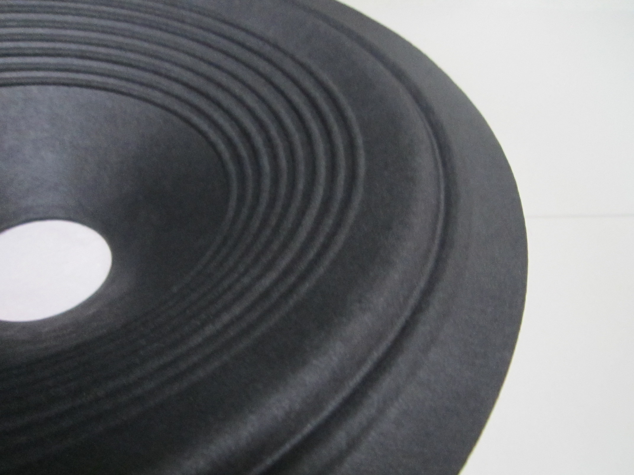

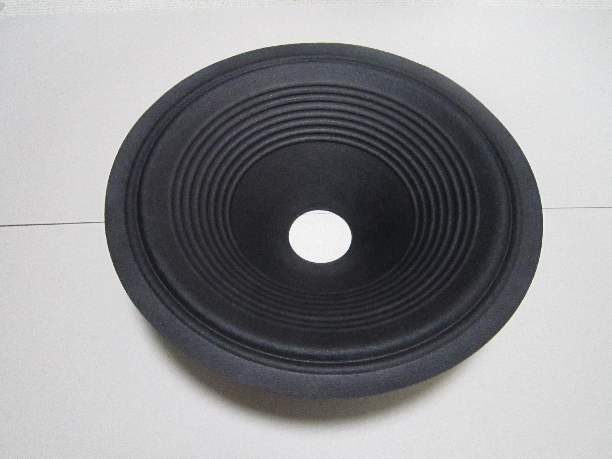

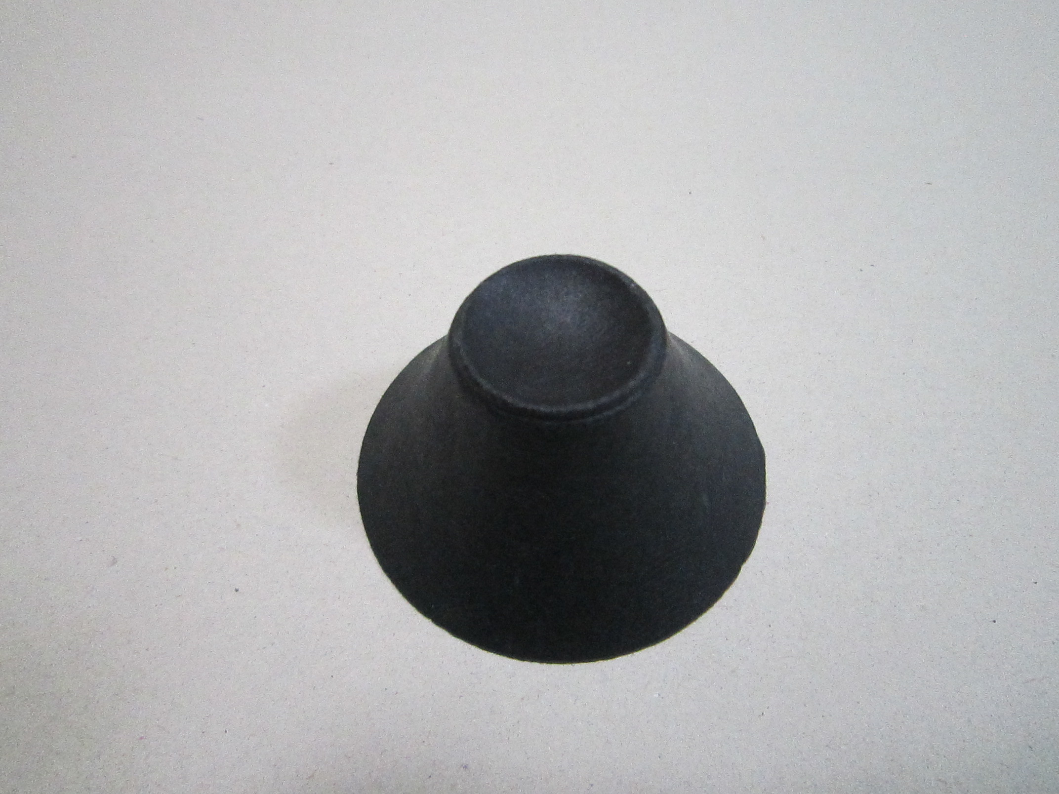

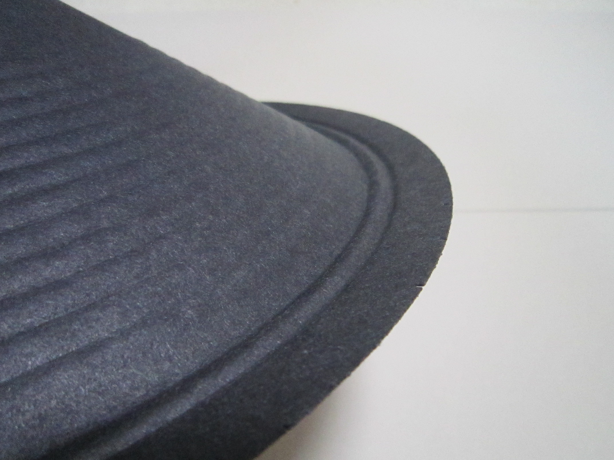

Hi there,
Sorry for the radio silence, it has been a very busy period.
With Project Ryu things are moving a little slower than i anticipated but it is moving forwards.

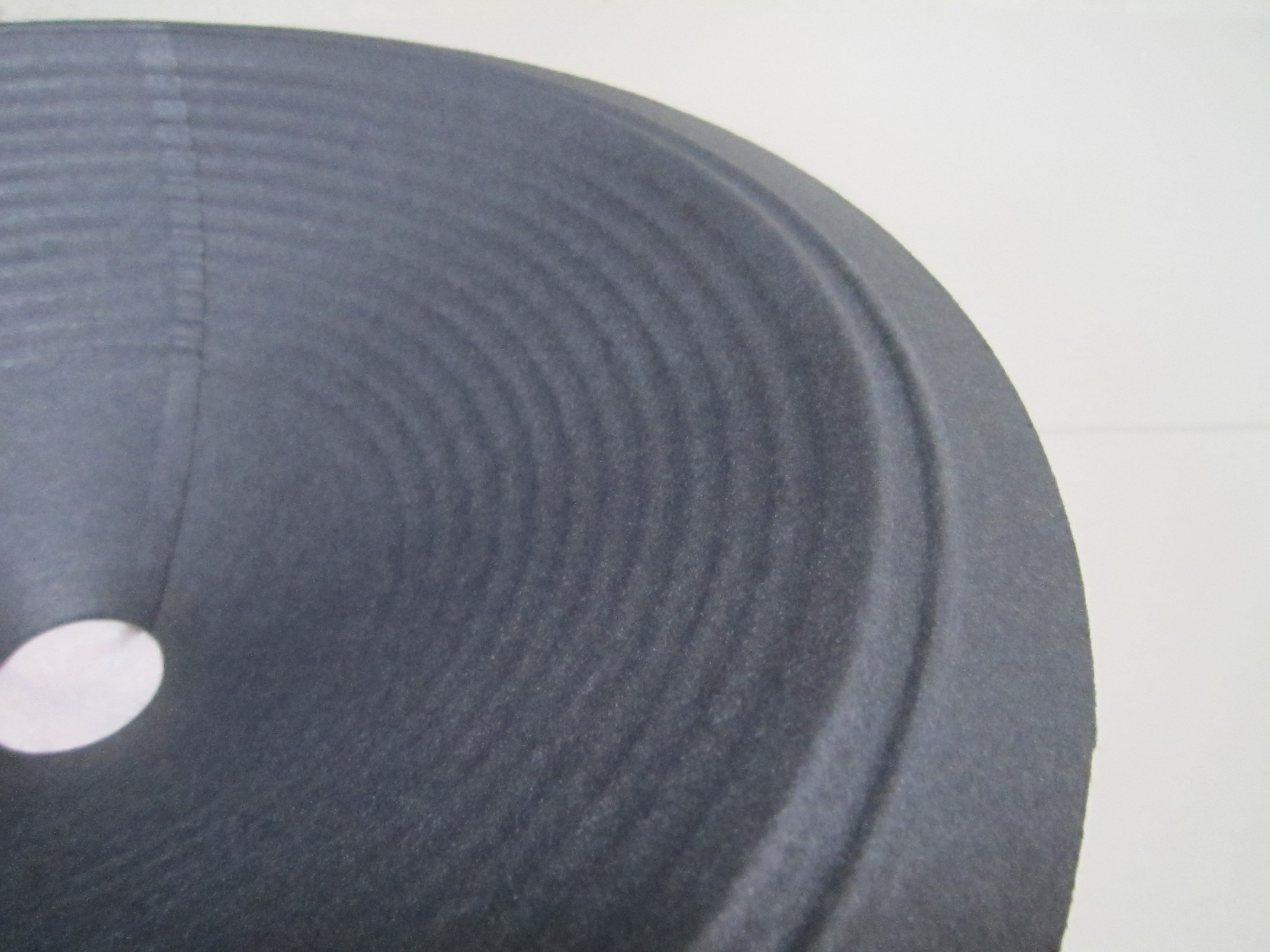

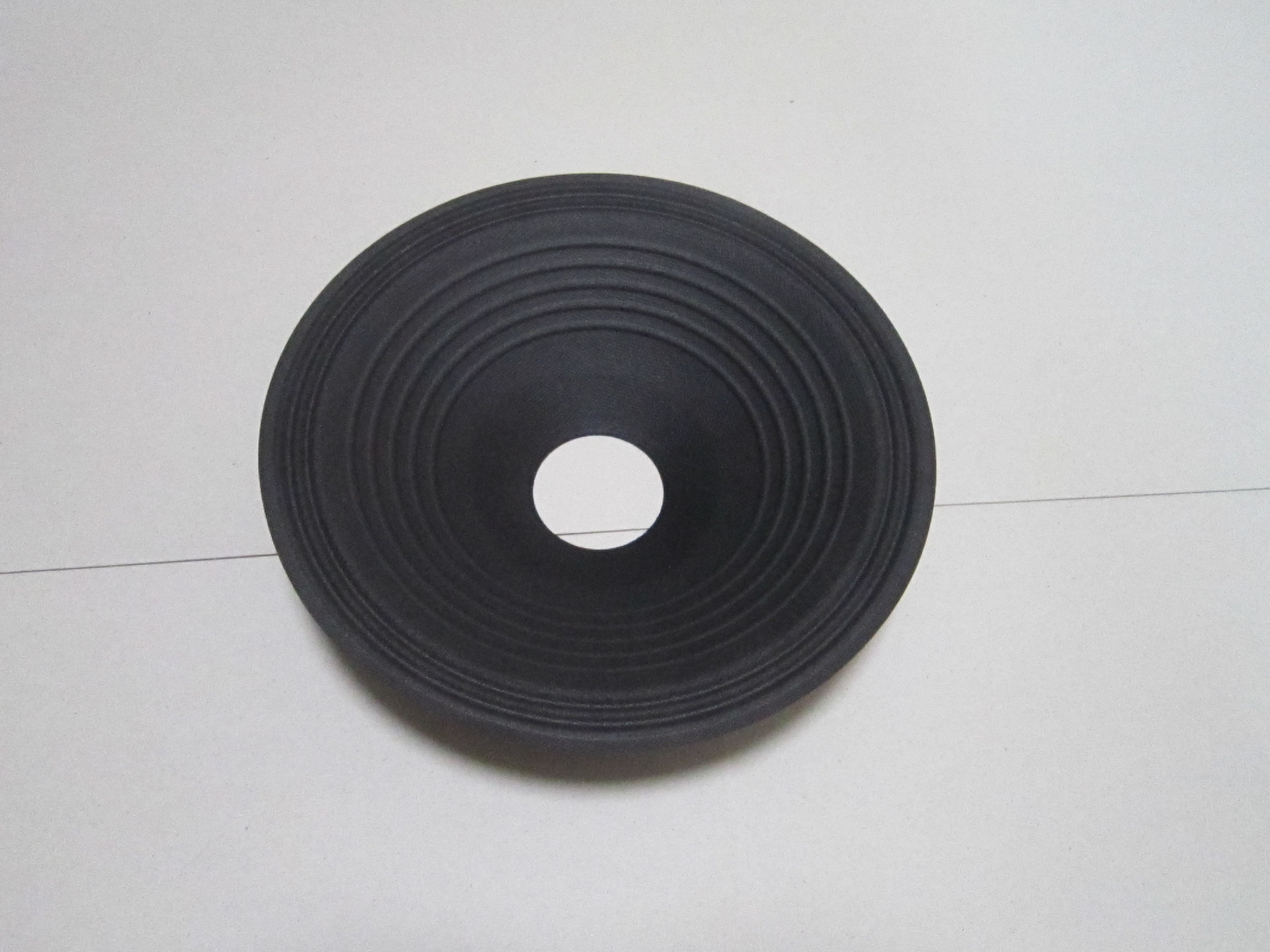

I can show you however the new cones which i am very happy with. Full paper cones very light, i have two version of 12 inchers and one version of an 8 incher since i thought maybe not everybody likes the big speakers.
The 12 inch cones have 12.1g and 14.6g *the darker one) respectively. The 8 inch cone has 4g.
There is also change in voice coil dimensions, for fullrangers i reduced it to 1 1/8".
I will still have the 2" voice coils for more power and usable range up to 10Khz.
Well, have a look at the pics and i will update again soon.

Nice shape of basket ribs to put some absorbing felt on it 🙂
Btw in relation to whizzer, spider, cone, and materials/shapes, I would look into Rullit creations for some inspiration, because anyone who has heard some better Rullits says that the HF is like ribbon tweeter and even surpassing it...

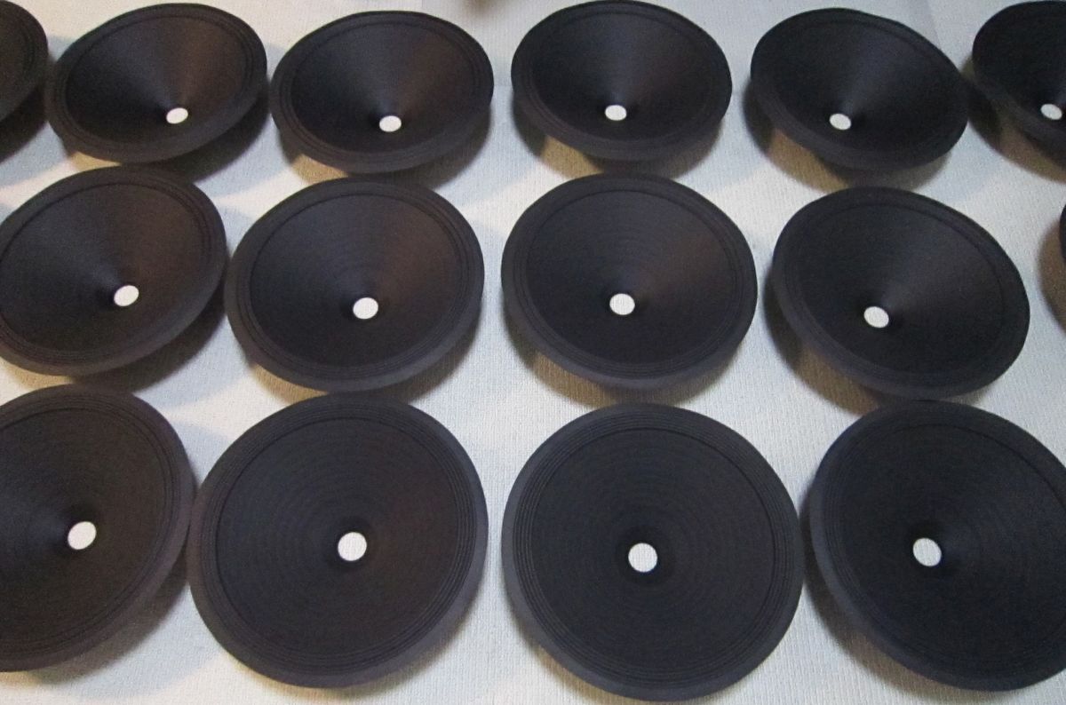

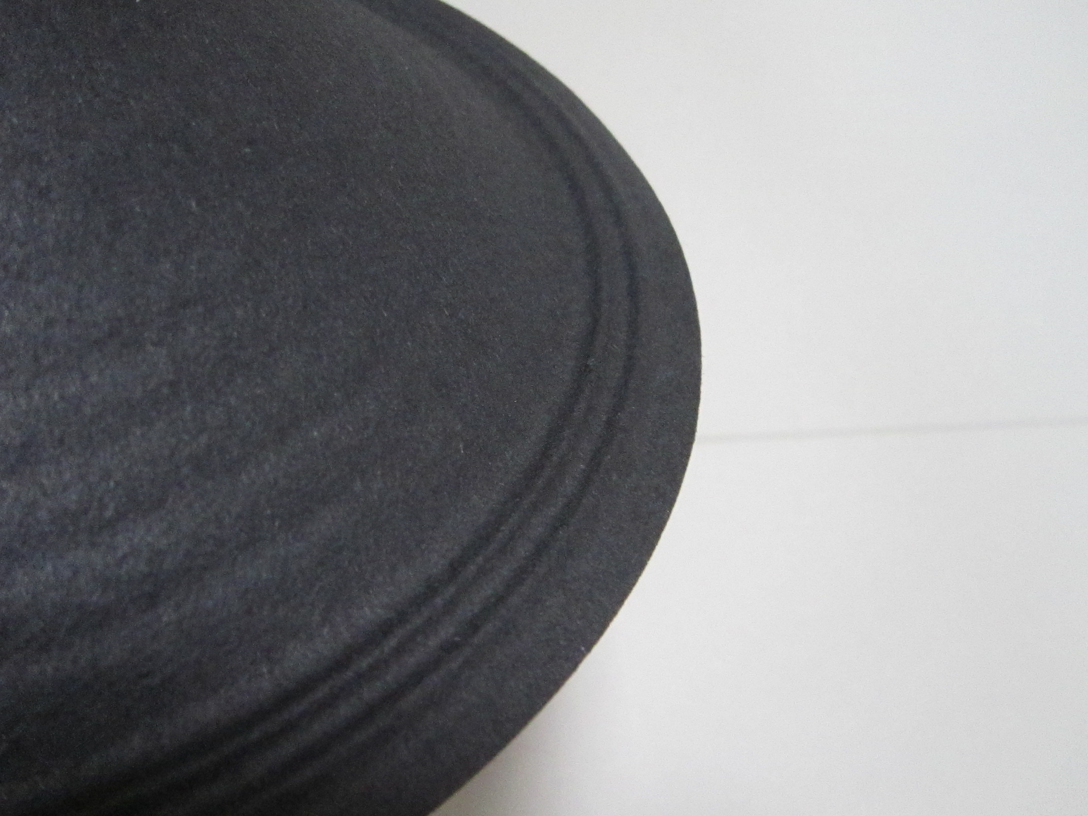

Just got my hands on another batch of 12 inch full paper cones, german made 15.1g. The new motors are a bit complicated the way things are going it will probably be in summer when i will have about 20 pairs (3 kinds) ready. I will make a few available here when they're all ready and im satisfied. Sorry it goes slow but i put a ton of money in this project so my allowance was cut down 😛
Anyways the new cones i like the most.
