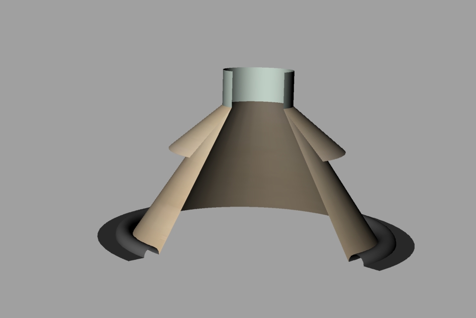

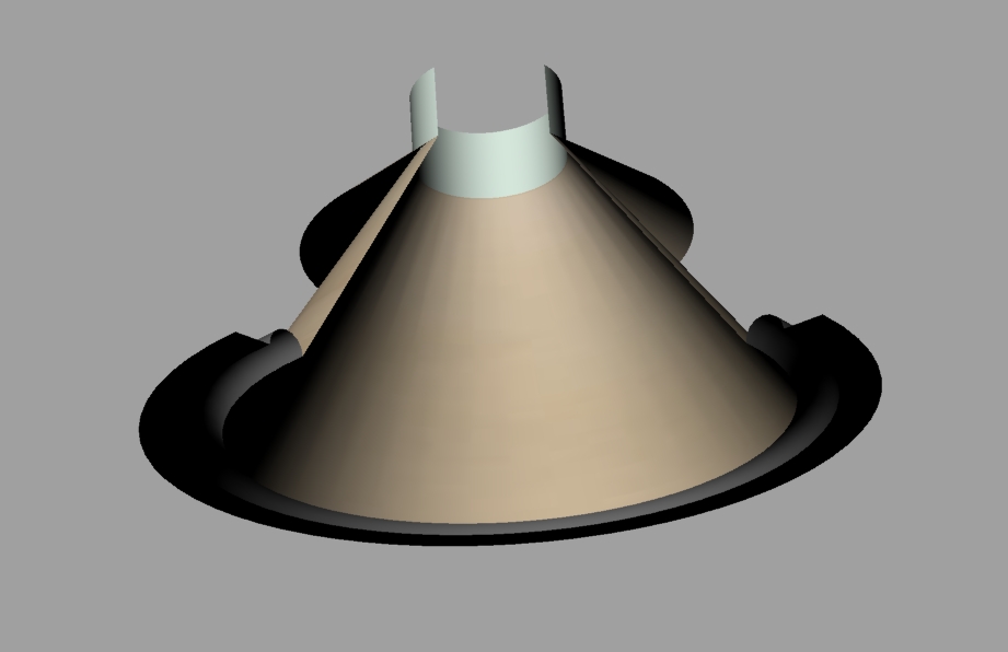

That explains a lot, I did a quick read up on radial speaker a I got an idea for a full range radial unit.... It looks kind of weird but it should work. Don't mind I draw the with out the magnetic system placed inside, as you can see I placed the wizzer on the outside of the cone I here the wizzer is pointing down but you can turn it both ways.
Anyway it's just an idea......

Is the idea to make a radial speaker or a Bending wave speaker?Hi Frank,
I'm making a radial loudspeaker. That is why it is a dome and not a cone. The whole driver is build around that idea (but did first some tests with a normal cone to compare). small magnet structure (dia.60mm) so the magnet sits "in" the cone and not under the cone otherwise the former would be to long, no spider also the spider would be to large to fit in. The advantage of a radial speaker is the 360 degree radiation and therefore a high freq. response is desirable. The peak is only impedance plot.

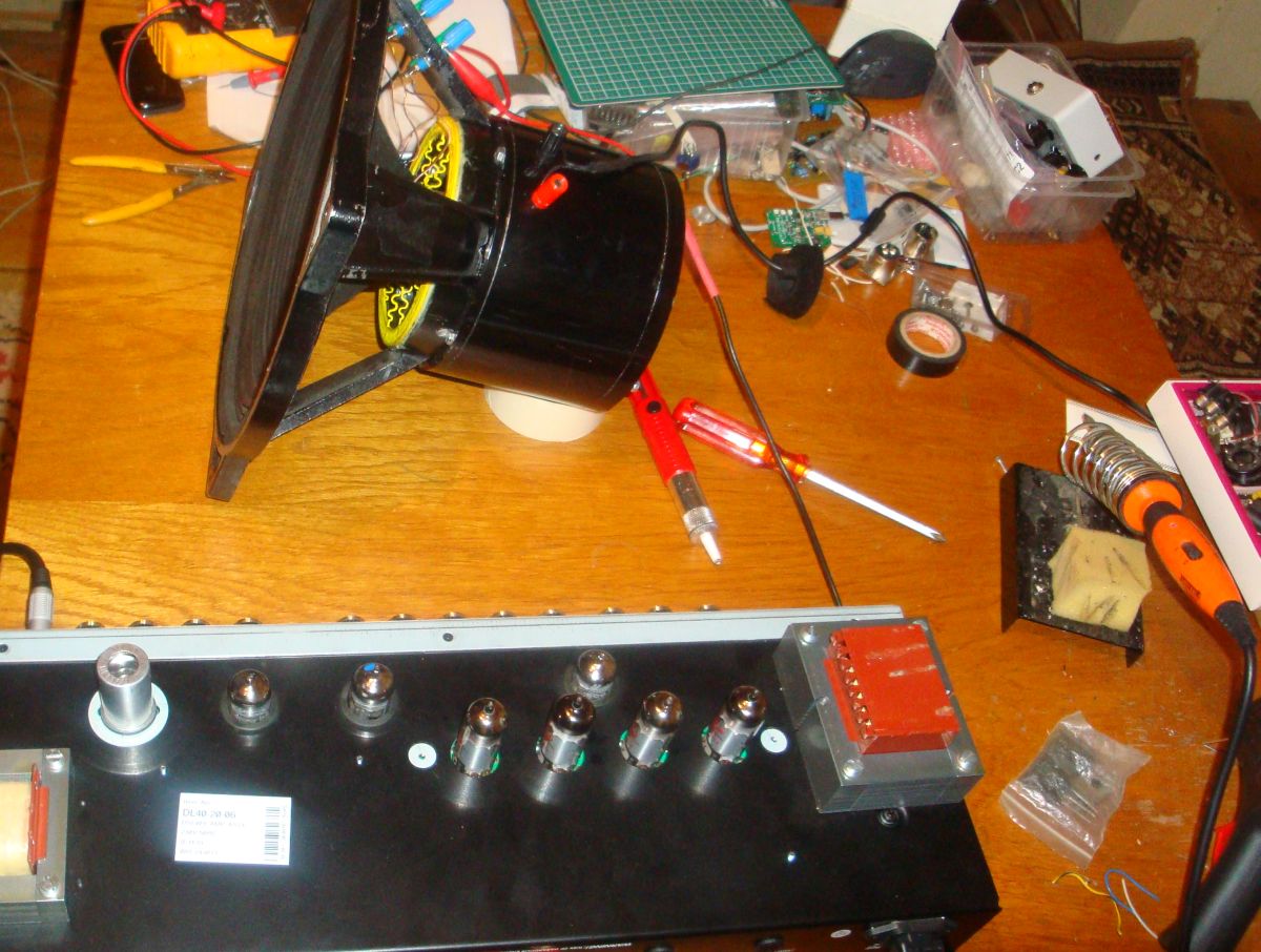

Today i had a friend of mine, who is a guitarist, come over and he had a Marshall JCM2000 DSL401 combo which he wanted me to mod.
This combo comes with a Celestion driver (more about it here Celestion G12T-100 Guitar Speaker Driver | Project Ryu Blog ) so after moding the amp i said lets try the Ryu driver on it.
We were both
. What a sound, that midrange was just so incisive. I didnt expect to sound so good on instrument. Sounds best with the dual voicecoils in series and the amp switch set to 16 ohms.
PP with parallel EL84s very nice, I'm so pleased.
