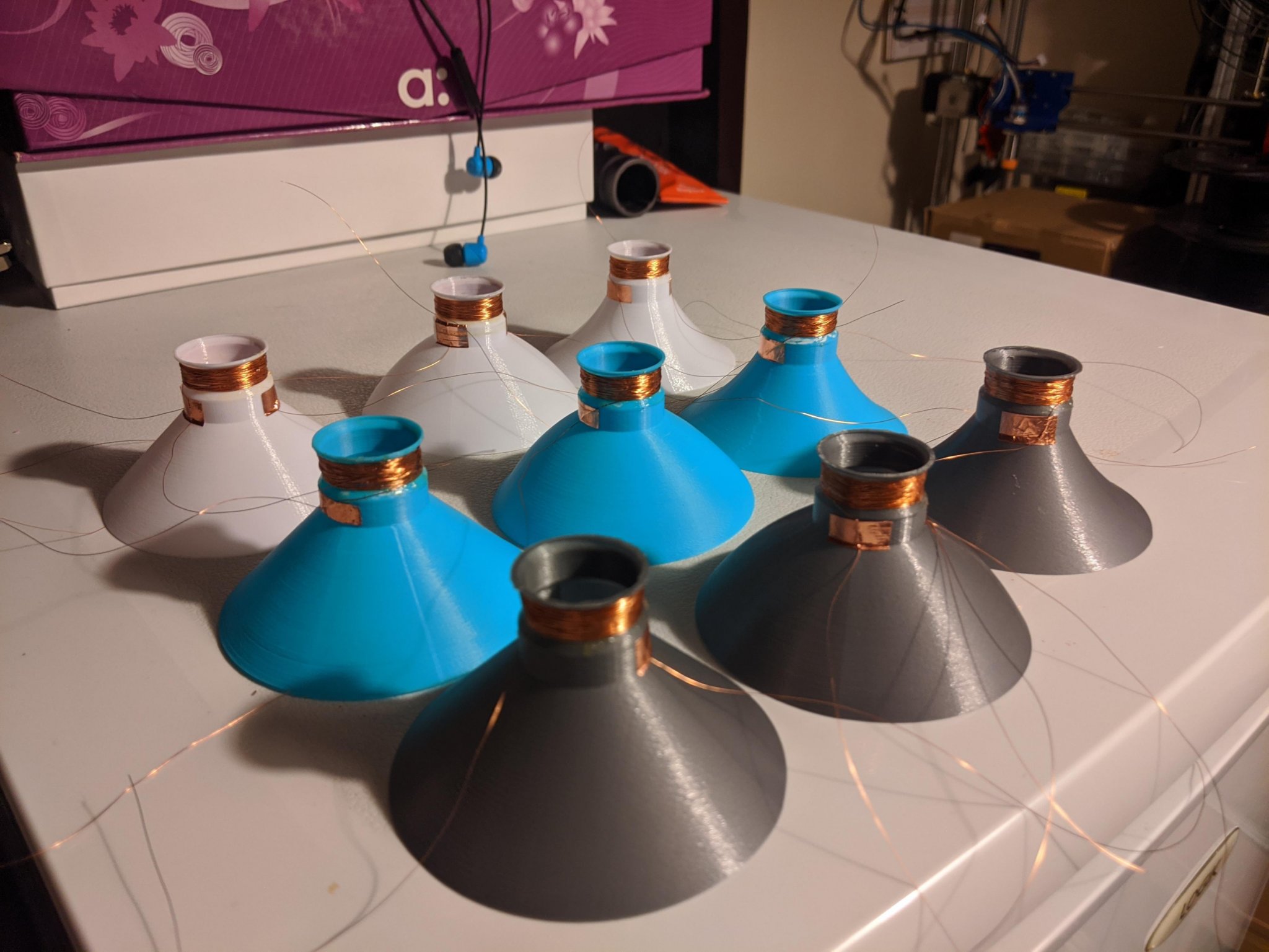

I haven't built a field coil driver, but I've wound transformers and coils and I do most of the work on my speakers by hand. There are sometimes items that are difficult to do yourself but most things can be done at home at little cost if you would rather learn how and put in the effort. On the up side, you get to know that it is being done right. By the way, in some areas some may find a 3d printer useful in prototyping.
Here's a thread about making cones and coils - https://www.diyaudio.com/community/...-drivers-experimentation.353861/#post-6189205
![EWpHAiHWAAE1Ijs.jpg EWpHAiHWAAE1Ijs.jpg](https://www.diyaudio.com/community/data/attachments/1050/1050883-eeac06bf0e0867b1e08dbaf1d0676420.jpg)
