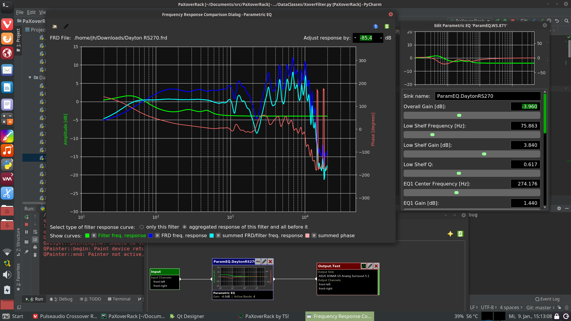

Here's a screenshot of the upcoming support for FRD files. Does this make any sense to anybody? 😎

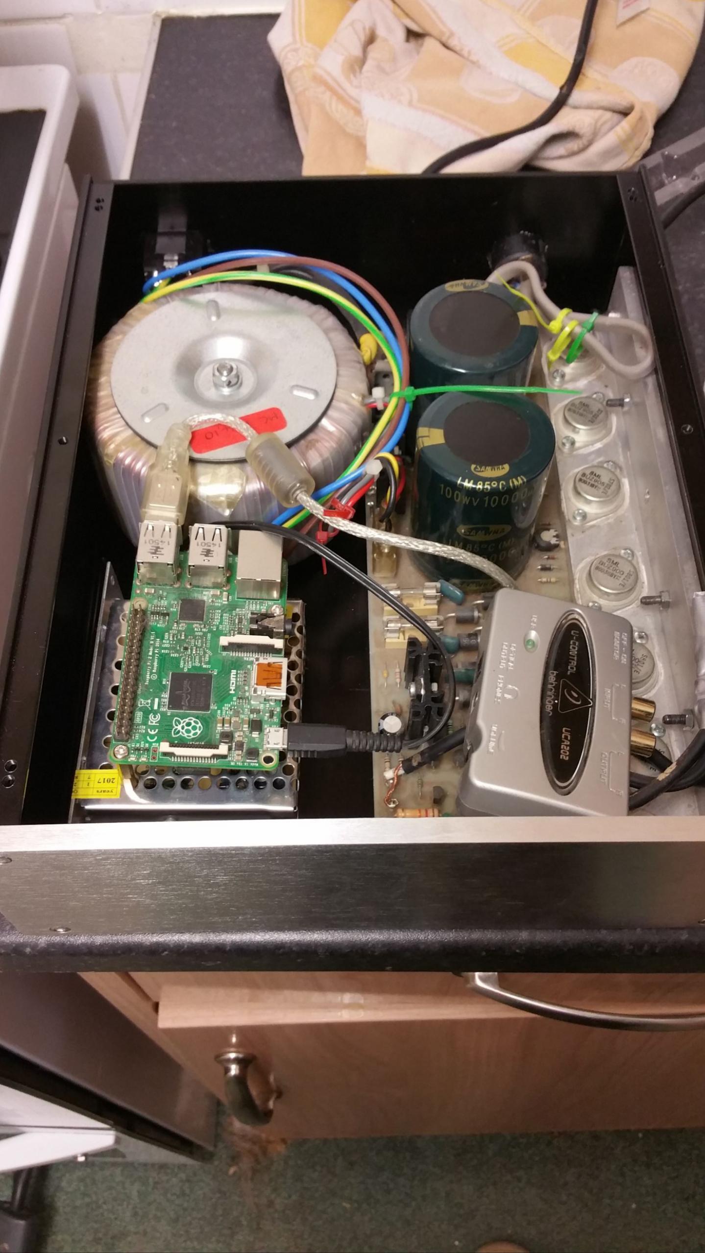

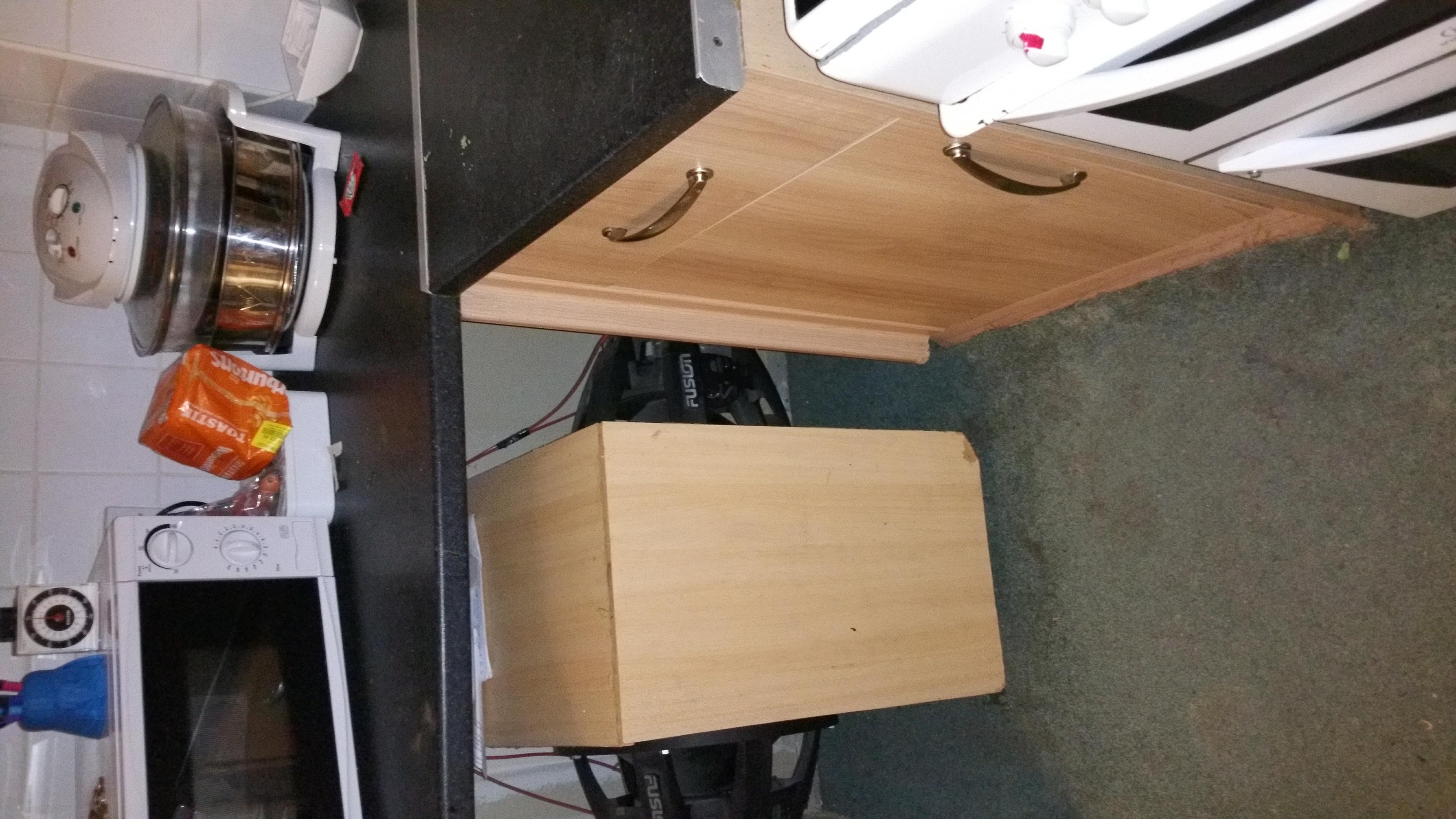

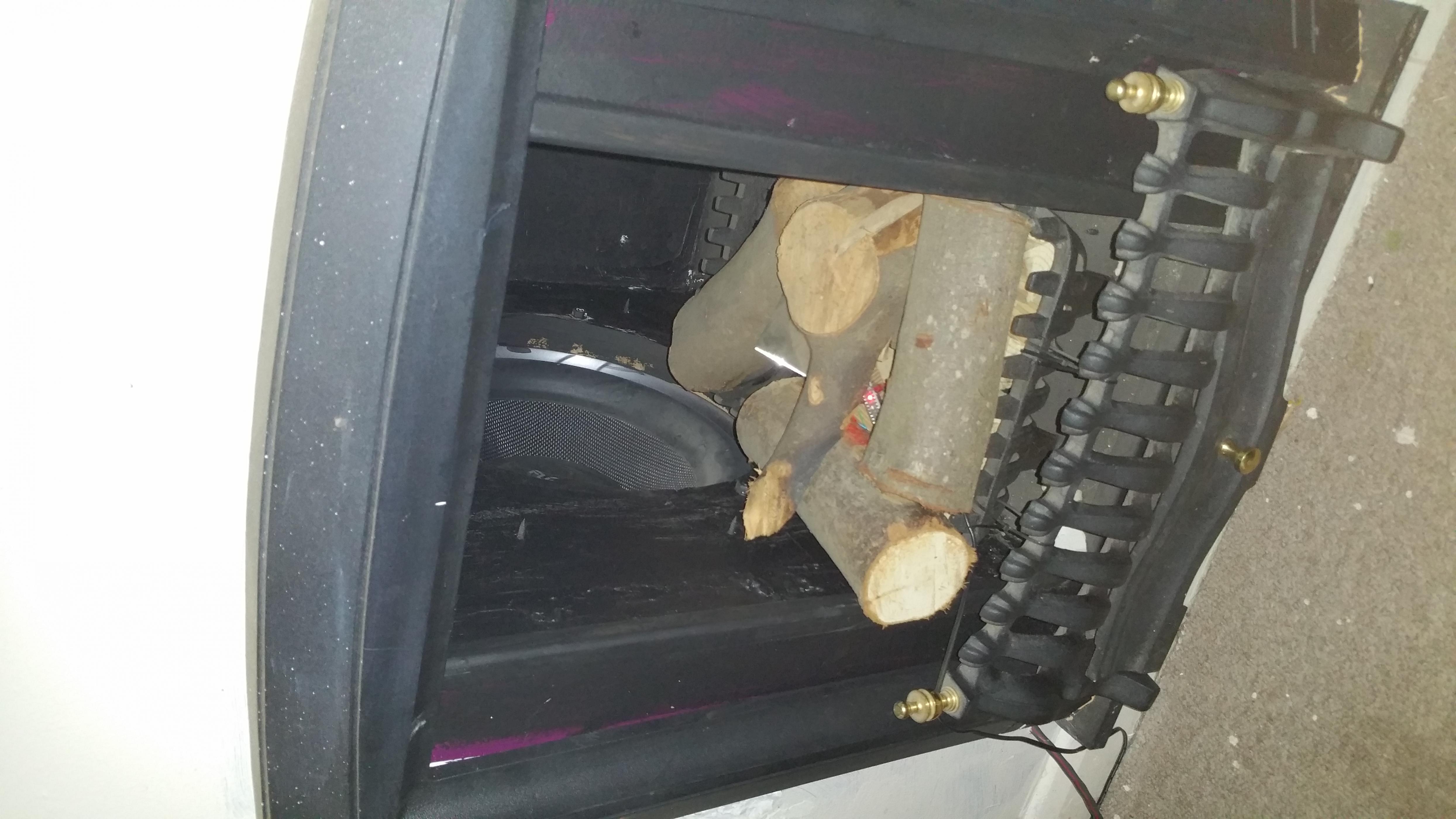

WTF, what kind of sub are you using? I want to see photos 🙂 🙂
Will change all lower bounds for frequencies to 2Hz in the next release which is to be expected as soon as i get some feedback to the FRD Dialog i posted here.
If you want to hack it you can look for "def parameterMappings" in the python files in /usr/lib/pulseaudio-crossover-rack/DataClasses and modify upper/lower bounds for the parameters...
of course if you want to go "bleeding edge" you could always checkout the git version from gitlab.
Like I said in a previous post, 2 x15" Infinite Baffle
Driven off 450 wrms 4 ohm, (I'm at 8ohm). Will show photo of front and amp. Looking for the rear of the speaker. Might have to take another when I get home. 😆 Thank you
