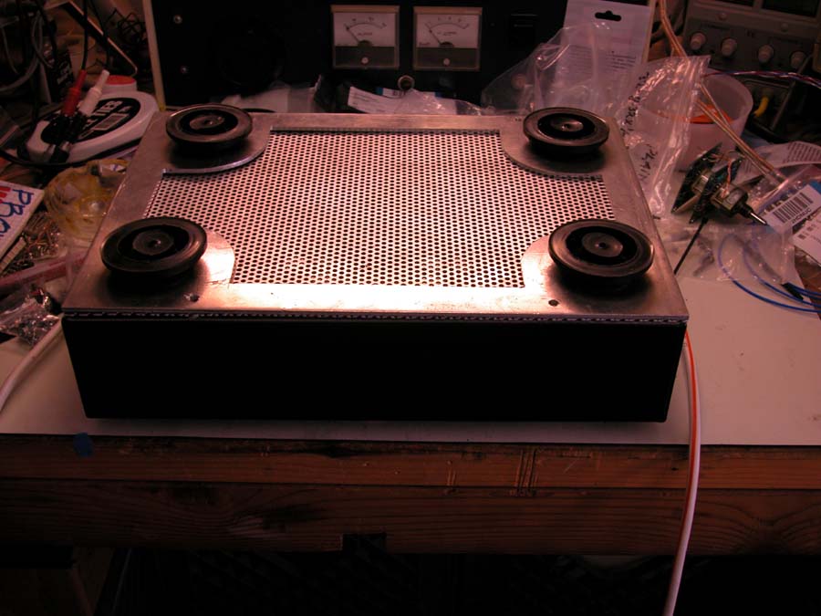

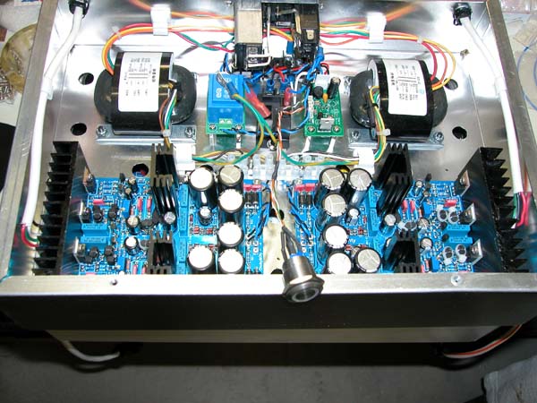

The transformers do run cool with the load resisters, but at 45V they heat the Shuntys up. It will have a vented cover and the Pumpkin will sit on top one those rubber feet. I could open some more holes in it, but it will weaken the chassis it is a flimsy Hammond aluminum. Maybe I will cut some large square openings under the Shunty boards and pop rivet the same screen I am using on the top in them.
