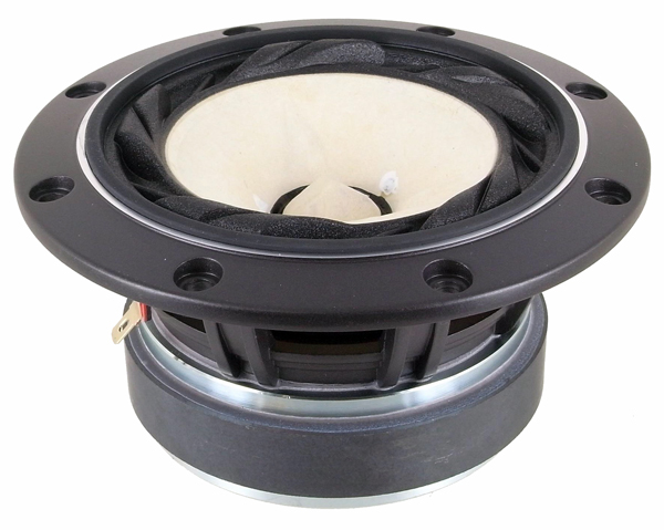

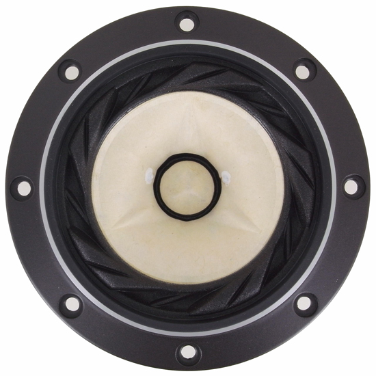

Two details from their website Transducers - Purifi I find interesting:
The surround has segments protruding forwards and some backwards. I wonder how that reduces distortions.
Low magnetic hysteresis does that mean an ironless motor assembly?
A normal surround changes its effective area when moving from the front to the rear and back. That means that the effective cone area changes as a function of excursion which of course means distortion.
The funny surround shape is designed to minimize this.
