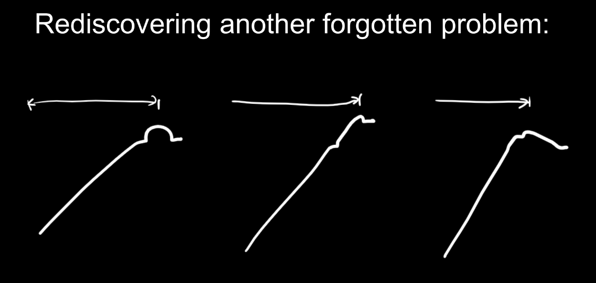

Stretching the surround (too far) causes distortion and I don't see how these designs really change that. But the surround has its own independent acoustic behavior (even at small to medium excursion), with resonances different from the membrane and I can envision that a more complex shape can ameliorate that by having multiple small resonances and thus reducing distortions caused by the surround. Are there any real data confirming that?
What Risbo wanted to attack is the change in effective piston area with excursion due to shape change in the surround.
I have several graphs showing the improvement of the new driver to an 'industry standard' driver, but I don't know which improvement is due to the magnetic circuit changes or the surround changes.
