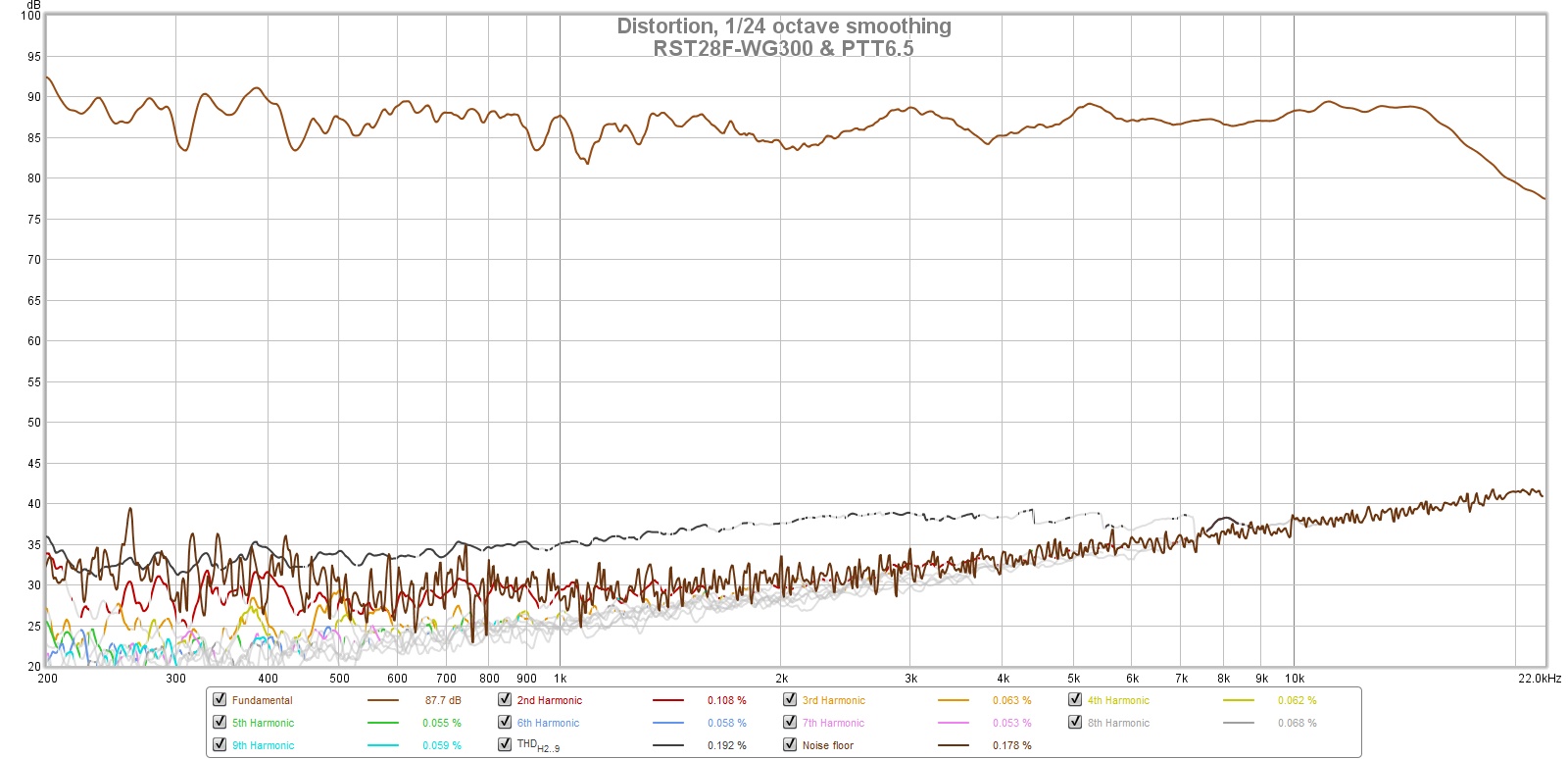

I paired the PTT6.5 with an RS28F dome in waveguide and crossed at 3.5kHz. The polars looks very nice and the distortion is very low.
845955d1590034502-simple-passive-harsch-xo-using-ptt6-5-rs28f-waveguide-ptt6-5-rs28f-woofer-axis-polar-data-0-5m-2vrms-jpg
Distortion at about 80dB 1m:
848431d1590773117-simple-passive-harsch-xo-using-ptt6-5-rs28f-waveguide-rst28f-wg300-ptt6-5-distortion-jpg

I agree with you, but like xrk post I too don’t see a massive directivity mismatch at least on the horizontals with my setup. But I’m yet to see verticals which I suspect are a mess and making the ceiling reflections a problem.
I’m very keen to see what the 4 can do, if the technology from the 6.5 translates to the 4 it should be one of the best mids in the world. I have the ATC mids here to compare.
Well verticals always tend to be a bit of a mess with most non coincident designs. Still, horizontally, you can have fantastic results using a 6.5" driver if you partner it with a waveguide like xrk has. I would expect a better directivity match by lowering the xover to 2-2.5kHz and then improving the vertical off axis too.
Still it highlights the true power of a waveguide design.
