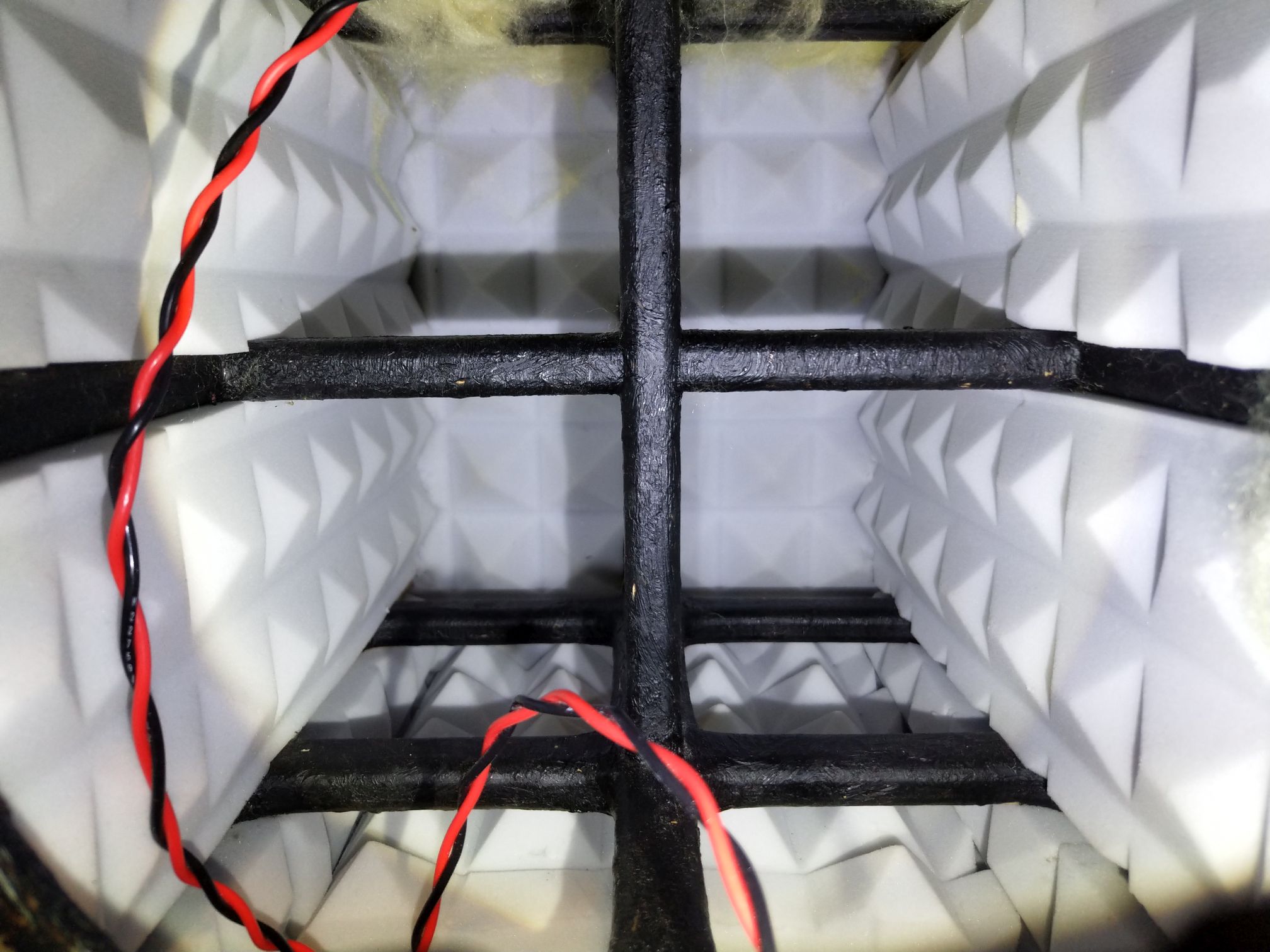

Use Basotect, great damping stuff !Ports are nice but I find them tricky to get "just right."
After adding 5-10cm on the inner walls it removed the "booming" sound I had sometimes.

Basotec is the brand name of a damping foam available in Europe. Compared to regular "Pryamidfoam", it has damping capability in lower frequency regions: If you would want to damp a room in bass-frequency-regions with it, you´d still be needing veeery thick plates. In an Bass enclosure, it is more useful to get rid of the mids reflecting inside the cab. Other foams will work for this, as well.
Not only mids, works great at lower freqencies too,
with 5-10cm basotect on the innerwalls it removed the unwanted peaks by 1db at 65-200hz and by 1-2db at 200-1000Hz.
Much less internal resonances.
Twaron is the damping material that also works at very low frequencies,
I had a combination of felt(1.5cm), Basotect(5-10cm) on the walls and some Twaron between (4g/l) but the Basotect with Twaron damped the bass cabinet too much.
Just felt and Basotect on the walls did it for me.
I use the Twaron in the mid cabinet (3g/l).

The thicker the foam, the lower the frequencies you can damp out. To get into bass-regions (lets say below 100Hz) you´d need a veery thick layer of foam - even Basotec. If this weren't the case, room acoustic treatmen would be much easier and cheaper... Take a look at this chart from the manufacturer of Basotec:
As you mentioned, in a Bass cabinet, you don´t want to damp too much...

Does this foam detract from the enclosure volume or does it make it virtually bigger as regular damping material?
the latter, but I am not sure to what degree, since in the cases We used it, it was never about "enclosure tuning" but more for room treatment. I am not aware of a case where someone tried to use it in a bass-enclosure for reducing low-mids - really doesn't make much sense in my opinion. Thin sheets for dampening out mids at the outer cabinet walls are used sometimes - but in a ported enclosure, it probably would kill too much of the port-energy if filled up entirely with basotec.Does this foam detract from the enclosure volume or does it make it virtually bigger as regular damping material?

Basotect is the brand name for reticulated (open cell) melamine foam from BASF.
Electron micrograph:
![5f7d739d5d4a8c5d7730160f64cc5593.jpg](https://i.pinimg.com/originals/5f/7d/73/5f7d739d5d4a8c5d7730160f64cc5593.jpg)
Since the patent expired, it has been made for much less and used as cleaning ("Magic Eraser") abrasive pads. You can get a bag of 100 pads (6cm x 10cm x 2cm ea) for under $10 from eBay/Aliexpress. I have been using this as the main absorptive material directly behind a driver in the rear chamber. It totally stops the boominess or echo like back reflections. Usually a single 2cm layer in line-of-sight of the driver membrane is all that is needed. Melamine is superior to polyurethane foam since the pore size is smaller and void fraction is very low. It is also fire proof and doesn't decompose into a stinky mess in 15 years like all polyurethanes eventually do. This stuff is a critical part of all my speaker builds now.
