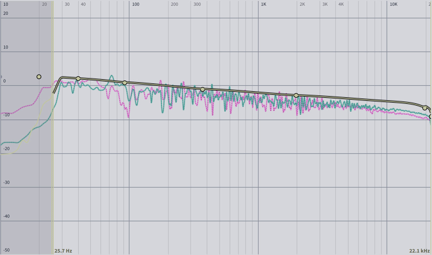

Hi Mitch
Would it be possible to see an image of the F3 25 result.
I recall from you article that your room was very similar in size to mine, but that is one impressive result.
your indulgence is appreciated - Best James
Hi James, yes, this was in the context of testing Dirac Live 2.0 as I was evaluating the software using the Purifi SPK4 kit.
Attached is the preliminary sim response, which should match the REW measurement when I get to it. My "stereo" setup is offset of center in my room, so the left channel is more in the corner and the right channel is almost midway center along the long wall. Correspondingly, the left channel -3 dB point is about 22 Hz and the right channel is about 28 Hz and Dirac chose the median as 25 Hz which is the vertical divider you see in the chart.
I am still amazed at how much low frequency energy (i.e. sub range) these put out while the lower mids and midrange still sound crystal clear. I had to check on a few tunes that I had turned my F18 subs off. Songs like Awolnation, the Best has peak energy at 35 Hz and there is enough output to pressurize the room. Certainly not dual F18 levels to be sure, but ridiculous for a 6.5" woofer.
Hi TimbreAudio, good question! i just checked - with the Purifi SPK4 measuring 95 dB SPL at the LP some 9ft away using the aforementioned track, the sub cones vibrate just a little. But nothing like when the subs are turned on at the same SPL. If I put my ear to the sub cone, I can't hear anything with them turned off. A bit hard to check though as those frequencies are omnidirectional. With the subs on, there is considerable cone movement and no question they are on. With the subs on, I measure a -3 dB point of 6 Hz in my room.
If there is any contribution from the sub cones with the power off, it would be at a very low level and could not approach the -3 dB point of 25 Hz at 83 dB SPL at the LP from the Purifi SPK4.
Edit. If I turn the subs on, but pass no signal to them, the sub cones don't vibrate at all in the above test scenario and I still hear the deep bass from the SPK4...
