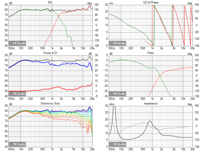

Typical 5-7" + 1" has directivity issue between ~ 2-6kHz, it radiates too wide. Downward slope of FR 1-2dB from 1-10kHz would solve this, but top end sparkle could suffer, overall sound could be little bit lifeless.
It is often the combination of wide radiation and diffractions, I usually solve this by lowering the problematic area by 1-2dB, it does not improve DI curve, it just partially compensates power response and the energy it radiates at those frequencies. It is not by the latest loudspeaker design mantra and Spinorama codex, but it works, and in normal rooms it makes listenable system.
Here is what I did for ClassIllu 2way, 18W/8545K00+6600. I cannot say it sounds worse or better then waveguided systems. It sounds just different, I can imagine in some rooms this could be auditioned and judged as too bright, but so far none of the listeners of those 2way complaint. Anyway, waveguided tweeters and speaker are less prone to sound bright and take less work to dial in the right balance.

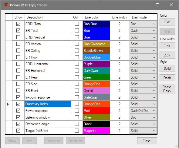

I think you mean directivity curve here and not directivity index curve.it does not improve DI curve,
I always call that curve the DI (directivity index) curve. Is there a better name for it?I meant the red curve in Power&DI graph. Well, if DI is directivity index => one number, then yes I meant directivity curve as a whole.

It seems my naming "DI curve" caused confusion, at least that is how I read b_force comment. I call it DI curve as well, directivity curve is fine too.I always call that curve the DI (directivity index) curve. Is there a better name for it?

I don't know why, Jim and your use of the term was correct within the context of a CTA2034 graph, no need to change.It seems my naming "DI curve" caused confusion, at least that is how I read b_force comment. I call it DI curve as well, directivity curve is fine too.
It might not be coincidental that more than several people call it a DI or Directivity Index curve... even Vituixcad hints to that
Export a single image and it will even show that title in the legend.
