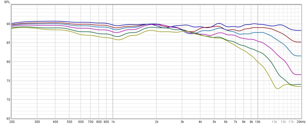

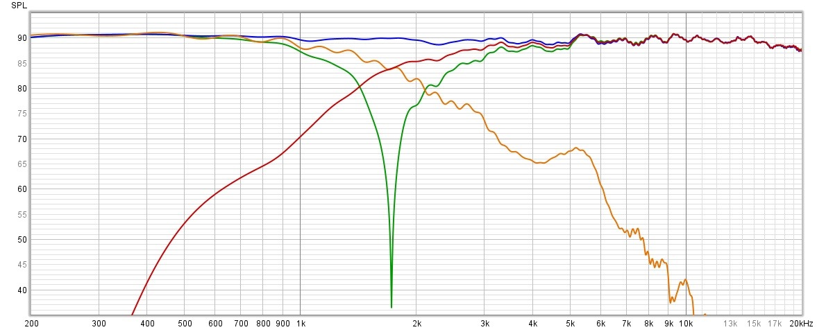

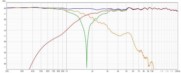

I design my crossover using XSim and attached are some basic measurements I took for the speaker using the TX drivers. Before the TX speaker, I have also built a speaker using the Satori MR16P with the TW29DN-B. Basically the TX speaker is better than the MR16P speaker in every aspect except when listening to vocal, it seems the MR16P has more texture to it. Whereas the TX speaker has much better clarity and more accurate vocal reproduction. Just wondering if the Purifi mid driver will have the best of both world.JamesTan> do you have measurements of your system? You're issue may having nothing to do with driver itself, but some other issue in the overall design.

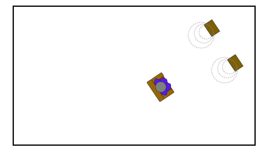

Speaker setup on a corner is really nice, allows speakers to be with good separation, still keeping them close enough to ear. The transition is clear as ever and its so much fun sit right at it, lean back for some nice roomy sound, distance, and lean forward when want to zoom into something

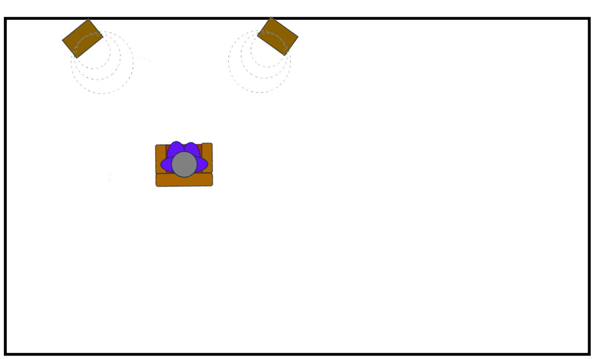

When you speak of a corner placement, is this what you mean ?
What are we looking at here, all gated measurements? Merged? Smoothed in-room? The area below the baffle peak often gets a dished shape to it after flattening the response, leaving a dip in the 200-600hz area. That doesn't seem to be an issue with yours, but I'm not really clear on how this was measured, so it's hard to say how accurate it is. You actually have a slight hump in this area as if your baffle is 2 feet wide, but I'm sure that's not the case.
Hi, that's basically it. Except speakers are against wall and listening triangle makes roughly a square with the room corner. Edited the image to correspond my earlier post description
![corner-setup.jpg corner-setup.jpg](https://www.diyaudio.com/community/data/attachments/1104/1104131-516ca4b060b4aa27f9c874b323ae6a25.jpg)

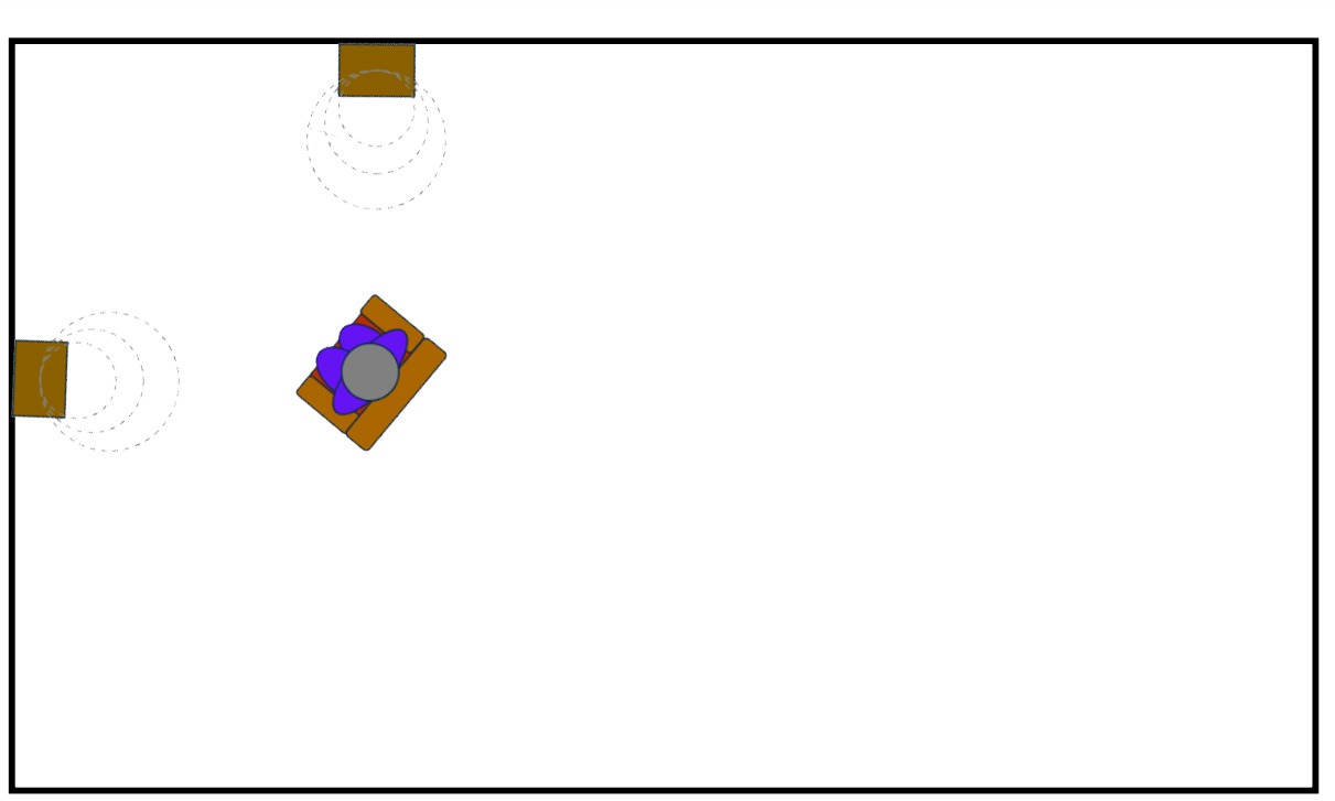

This is how I had the speakers before:
![old-setup.jpg old-setup.jpg](https://www.diyaudio.com/community/data/attachments/1104/1104132-c63eb910c9afb9cb685d52b7f9f54fce.jpg)
Left wall is basically all window so I cannot put everything facing that way, one speaker there with the corner setup is fine, not much of an practical issue. Right section of the room is kitchen, so can't put speakers there either
On-wall speaker placement is nice, wall behind a speaker contributes some but quite little. The speakers are designed to work with the wall, with some success at least. If you imagine the situation basically "front wall" early reflections are minimal like before, but now with corner setup there is basically no "back wall" early reflection at all, and "side wall" early reflections happen closer to 10ms. Also direction of early reflections change a bit compared to typical wall placement. Basically all side wall reflections were pushed further in time, and lower in level as well. Floor and ceiling reflections would be pretty much the same as before.
Sound seems more enveloping with this setup, and perhaps more detailed. But all this is very early so not sure if there is much difference in the end. Need to switch back within few days and listen if there really is audible difference between the corner setup and the wall setup.
What is greatest here with the corner setup the speakers critical distance is same as before but basically I'm bit further into the room now. Also the speakers are quite far apart, straight angle triangle instead of equilateral. With the close listening distance this gives very very wide sound, and makes the hard panned instruments sound too far apart and weird, a minus. Did not try this wide with the on wall placement, need to try it as well.
Sound is nice far away as well.
Bass went down with the setup, had to boost and adjust filters. Not sure if its better or worse either. Listening spot is quite close where it was before but the speakers are now in very different position to modes. There is also a small sofa in the corner between speakers. This might suck some bass out. Probably helps absorb and diffuse some early reflections on the corner as well.

Forgot to mention sound is great also at the sofa in the corner, can be adjusted from very spacious to headphone feel with toe-in and leaning back/forward.
This is very practical listening setup actually, sit in the corner and speakers on the walls. Speakers could be at any distance I think, and they would always be right at the walls and unobstrusive. Very big sound, unnatural perhaps, but great fun at least for occasional use.

Those are gated measurements at 0.5ms and no smoothing was applied. All measurements were taken with the mic at tweeter level 2 feet away because my measuring room is not really an ideal place for measurement. I wouldn't say there is any hump in the response curve because the whole response curve is almost +-1dB from 200Hz to 15kHz. Btw the baffle is about 10.5" wide.What are we looking at here, all gated measurements? Merged? Smoothed in-room? The area below the baffle peak often gets a dished shape to it after flattening the response, leaving a dip in the 200-600hz area. That doesn't seem to be an issue with yours, but I'm not really clear on how this was measured, so it's hard to say how accurate it is. You actually have a slight hump in this area as if your baffle is 2 feet wide, but I'm sure that's not the case.

I assume gating 0.5ms is typo. If not, then it might be the issue, very little measured data below 1000Hz => you do not know what happens in the range Hifijim and Augerpro write about.Those are gated measurements at 0.5ms and no smoothing was applied. All measurements were taken with the mic at tweeter level 2 feet away because my measuring room is not really an ideal place for measurement. I wouldn't say there is any hump in the response curve because the whole response curve is almost +-1dB from 200Hz to 15kHz. Btw the baffle is about 10.5" wide.

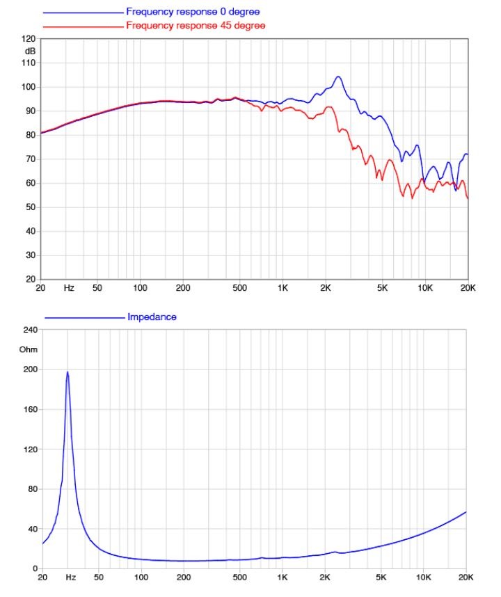

The 500 Hz thingy is not so nice...Hi Jim, thanks for your detailed and honest response as always. It is interesting that you mentioned about the 12" woofer, that is something I am planning to incorporate into my system. One of the latest 12" driver from FaitalPro 12RS430 looks pretty good to me, hopefully we can get more reviews on this driver soon.
Care to explainThe 500 Hz thingy is not so nice...
SB Acoustics SB34NRXL75-8 is a great driver which I use and have tested. Pretty sure the Faital is not in the same league and price difference is not that much.Hi Jim, thanks for your detailed and honest response as always. It is interesting that you mentioned about the 12" woofer, that is something I am planning to incorporate into my system. One of the latest 12" driver from FaitalPro 12RS430 looks pretty good to me, hopefully we can get more reviews on this driver soon.
https://hificompass.com/en/speakers/measurements/sbacoustics/sb-acoustics-sb34nrxl75-8
One can see in the impedance trave a "blipp" at 500 Hz. This indicates a resonance. It manifests itself in the sharp suck out in the FR trace at the same frequency. Always look at the impedance trace - its like an x-ray if the mechanics of a driver...
Ok, 5ms is good enough. Looking at the graph in #383, the filters are acoustic LR2. There is no significant issue. I have experience with MW16TX and TW29TX. Your perception of less meat is actually good and is what I hear as well. Paper versions have more weight, richer sound. Anyway, it would be good to see full picture, do you have also off axis responses?@Pida Thank you for pointing out the mistake. The measurements are gated at 5ms instead of 0.5ms. In fact if gated 0.5ms, the response will only show from 2kHz onwards.
Few points:
1. midwoofer 5k peak might be worth suppressing.
2. I assume, if the filter is simple LR2, you used also RLC to suppress 500-1000Hz bump created by LR2.
3. ~3kHz area could make the sound more offensive, lighter, and less weight. It is about perception and proportions of certain frequency band to another.
4. actually whole treble area could be tilted down by ~1dB. At least you can try ...
@Pida I am glad that I am not the only one hearing the difference between the TX and paper version woofer. I do have the off axis measurement but it was done without good proper setup and the room is definitely not suited for off axis measurement. It may not be the most accurate off axis measurement, nevertheless I will still upload the plots. The measurements were done at 15, 25, 35 ,45 and 55 degree.
1. I have tried adding a 0.22uf capacitor parallel to the woofer inductor to knock down the 5k peak, but some how I preferred the sound without the 0.22uf capacitor.
2. Yup, I did use a RLC to suppress the 500-1000Hz bump.
3. In fact I find from 2kHz-5kHz region to be offensive, using 90dB as an average, I tuned this region to be slightly lower.
4. I tried that too but in the end I preferred this current setting and left it more like a flat response.
