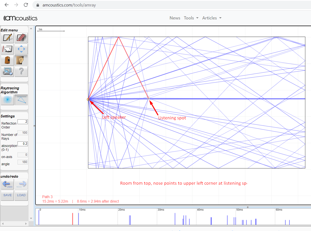

That's more or less always true in acousticsIts probably not as simple as that, ....
While simulations have gone a long way and are getting really good with numerical methodes - when you see how strongly you have to reduce the basic formulars to be able to do any simulation at all ... it's pretty cool that we get any realistic results at all ;-)
These 10ms sound way easier as they are! In 2m distance to the source you would need a ceiling 2,5m higher as ear level to avoid an early ceiling reflection!
Side walls also 2,5m away - but in a 5m wide room you normally sit more far as 2m, so ...
That's also one of the big problems in small recording rooms - you would perfectly need a ceiling about 2m higher as the overhead microphones! Look at these great live rooms, they are built exactly like that. But in a normal building ... I often go the "damping" methode. If you can't have great reverb get at least no problematic reflections and no "boxy" sound of the room (good absorption in the 80-250Hz area).
So in short - you will still have to invest your 10k in room acoustics when you really want your stuff sorted out.
But as little side benefit - your listening room will now feel and sound great!
