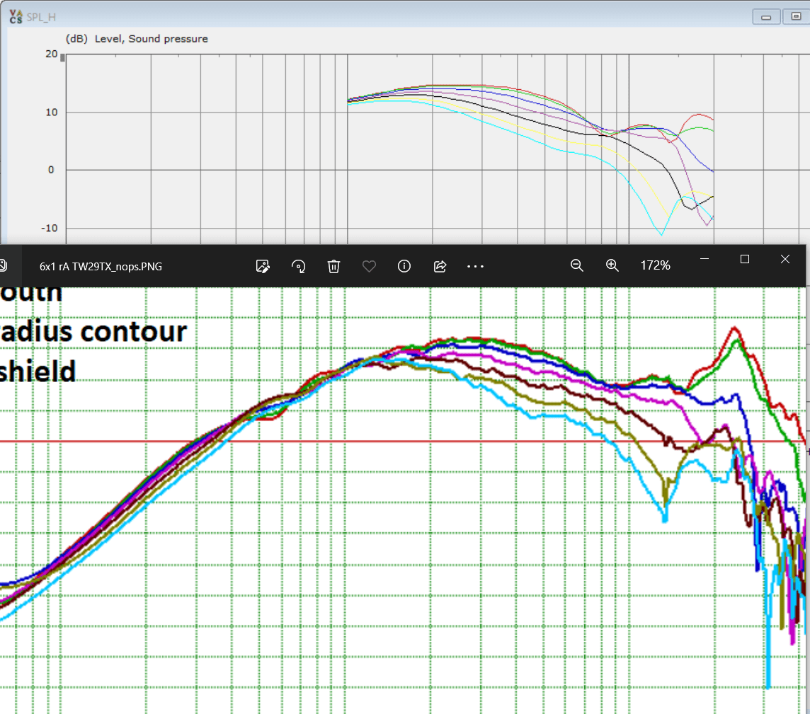

If you can make a paper template that fits the curve of the waveguide and can get a reasonably accurate dimension of the dome and surround height and width, I can simulate you a few options to see how they differ.
I'd be interested in the waveguide contour also. See how it compares with ones I've designed recently that are working well with the TW29TX. Someone posted that SB said the TX should measure the same as the BN on their waveguide. So the diaphragms must be similar. I made measurements of the TX to model in ABEC, I'll post them when I get home from work.
BTW, if someone has a TW29BN they wouldn't mind loaning me, I can verify that it measures the same as the TX on my waveguides.

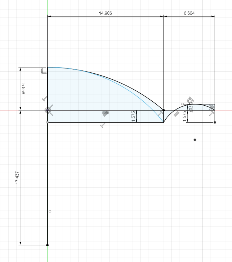

Attached is the TW29TX diaphragm info. One wrinkle: where the surround attaches to the diaphragm is not at the same depth as where the other side of the surround attaches to the faceplate. So when I created the ATH model I put it at the same level, and widened the surround so that its height remained constant. Hopefully the picture describes it better than I can. I now realize I can adjust Z depth on all the source points, so I should have been able to model it more closely to what it actually is. Regardless, you see from the results that the ABEC model accords well with the actual measurements.
Thanks, perhaps metric verniers are banned in the USAttached is the TW29TX diaphragm info.
Any chance you could take (or have) a close up photo of the driver without the faceplate?

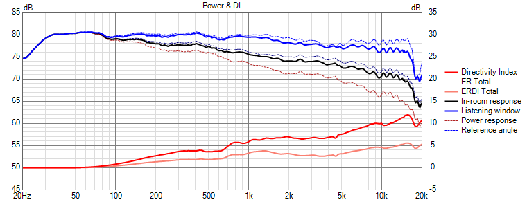

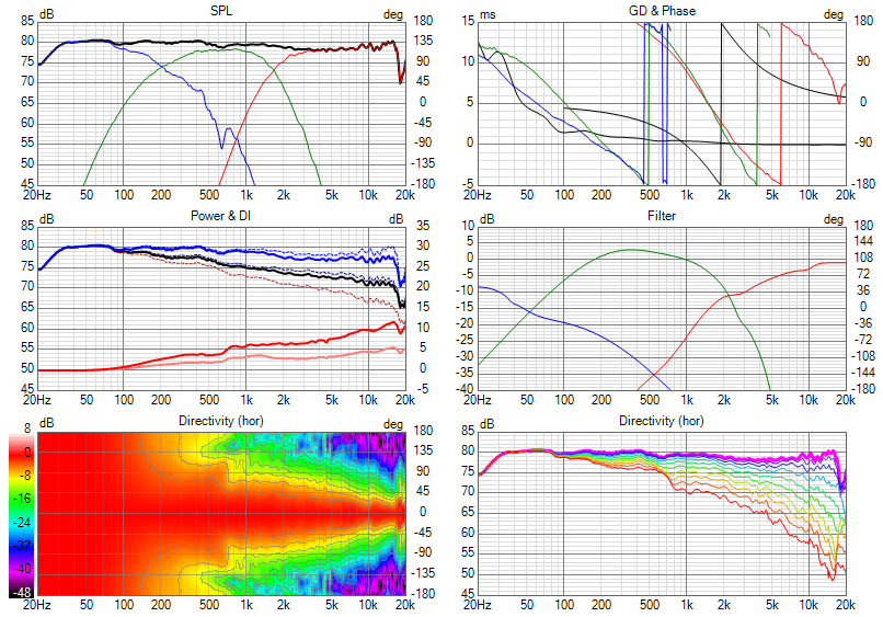

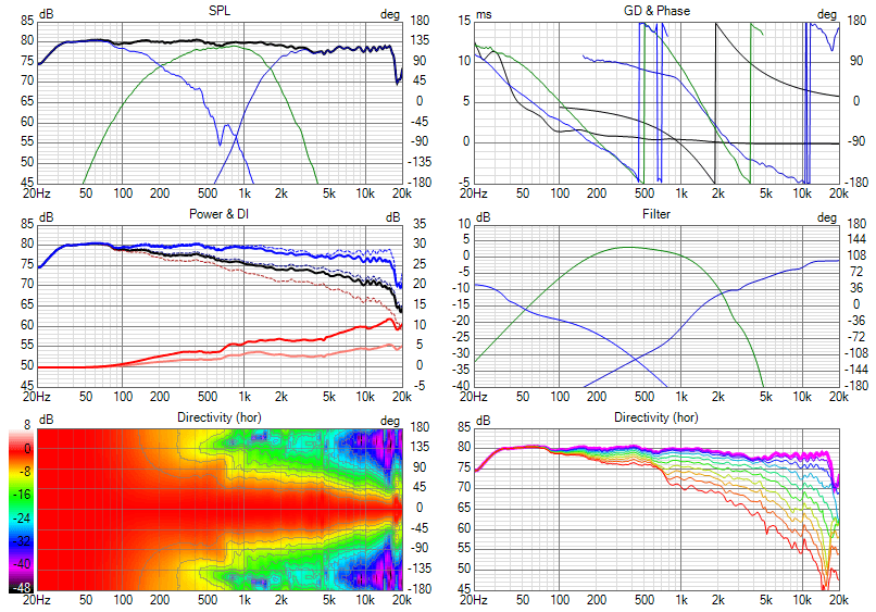

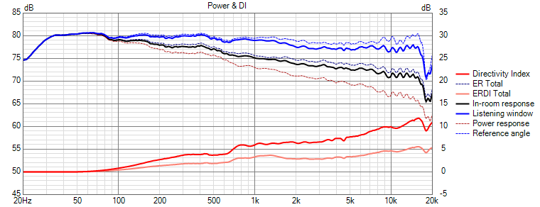

I have done more simulations. I have concluded that the differences between the donut and the bevel box are within the error bands of my measurements and simulations.
What I am showing here is a simulation using measured data from my SB34NRX75-6, MW16TX-4, and the two different waveguide enclosure options (bevel box and donut). For both cases I optimized the filter algorithms for the best compromise between Listening Window performance and PIR performance. My measurements are +/- 1dB at best, and my past experience has demonstrated that Vcad sims can match reality to within +/- 1 dB… Given this uncertainty, there is no meaniningful (i.e. measurable) difference between the two sims.
First the Bevel Box
Now the Donut

If I was optimizing in Vituix I would still pick the bevelled box every timeGiven this uncertainty, there is no meaniningful (i.e. measurable) difference between the two sims.
I wonder if there is something to be gained in the transition from woofer to mid. There is a directivity jump from 500 to 1000Hz and the dip in the woofer seems to be coming into play even though it is well down. Perhaps a problem for the eyes more than the ears but who knows without trying.
To me it seems the mid has some jump in directivity at about 600-700Hz. Looking at the mid enclosure pics I guess it's about 10" wide. Wonder if those two are related (I guess so).I wonder if there is something to be gained in the transition from woofer to mid. There is a directivity jump from 500 to 1000Hz and the dip in the woofer seems to be coming into play even though it is well down. Perhaps a problem for the eyes more than the ears but who knows without trying.
Directivity spectrogram shows very sharp change in directivity -6dB line. Edge diffraction often shows even wider diffusion... The 12" woofer SB34 has a dip in on-axis response there, but it is at -25dB level... And it is most likely an artefact, reflection nulling.

I think the directivity changes in the 600Hz region are a function of the enclosure dimensions and driver size and occurs probably due to low-frequency diffraction.
