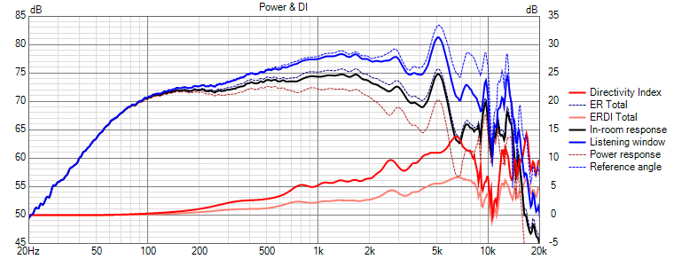

Empirically I have found the same 1dB per octave fall in an in room response is a very good starting point. 0.8 to 1.3 seems to be the range depending on directivity and taste. Variations away from that at certain points do seem to make a real improvement but all very room and diffraction dependent.Lately I have found that a nice smooth PIR curve that slopes down at about -1 db/octave is a good starting point for subjective voicing.
What are the other options though? For instance, 0 dB/octave, we're talking a truly omindirectional point source. Even with this fabled speaker it's arguable to the advantages of the increased spaciousness outweighs the reduced level of focus and precise imaging...
Is this behavior the cause of the off-axis response at around 1 kHz being close to the on-axis instead of showing a reduction in response?the typical cone edge resonance around 1kHz shows up in the directivity (cone edge out of phase)

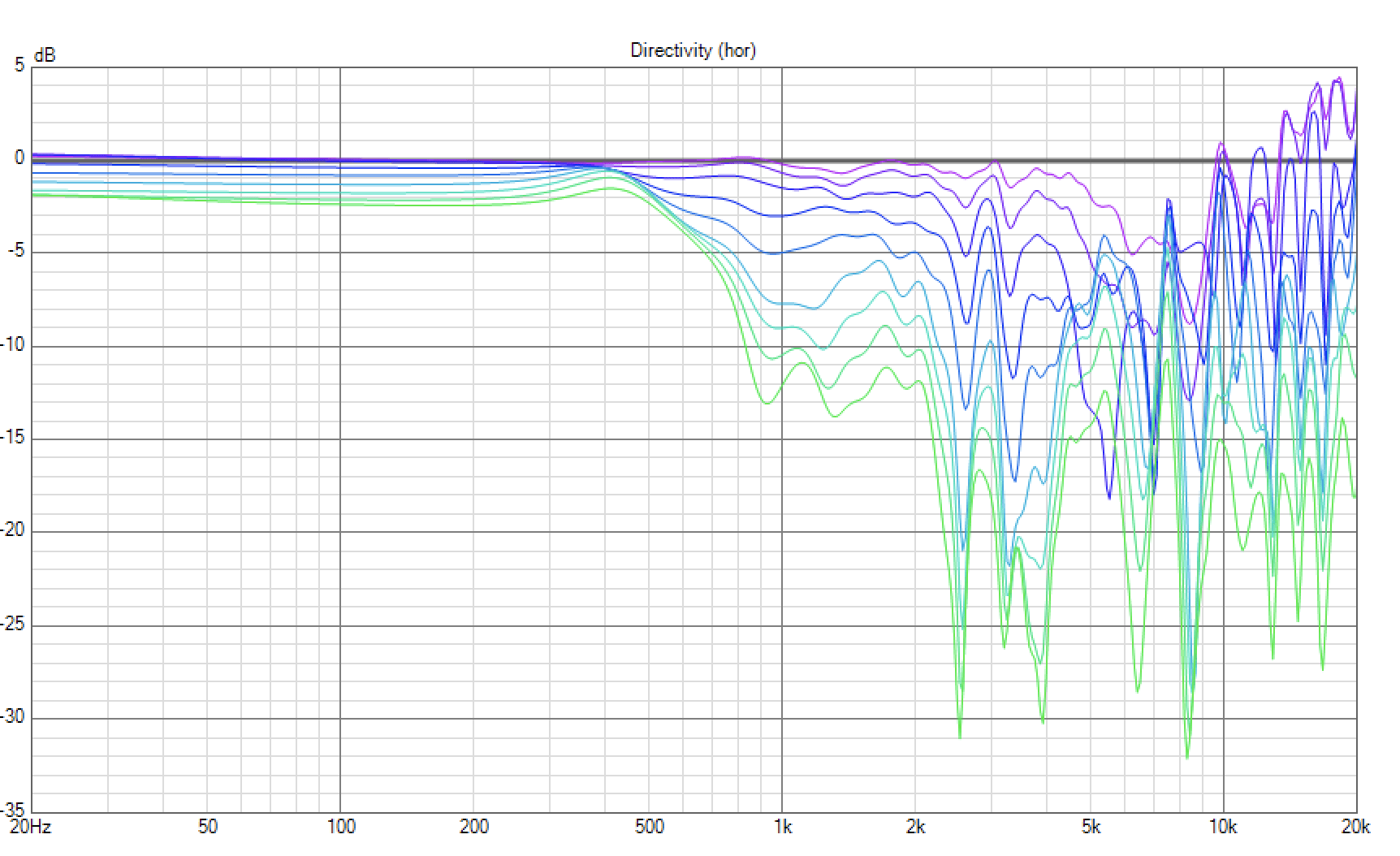

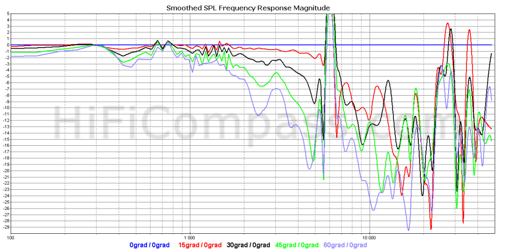

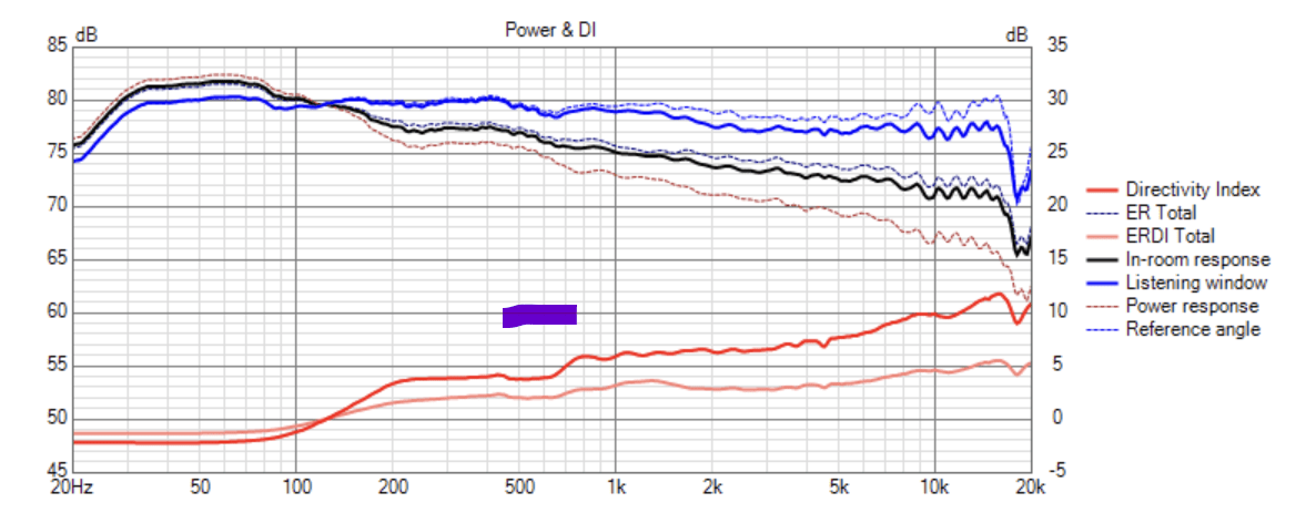

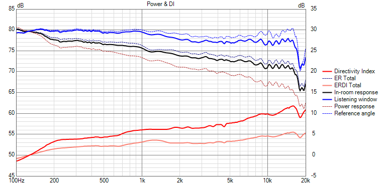

My point refers to the area highlighted in purple. The mid box is nearly 2dB more directive than the woofer box. It's not horrible but I think it could be smoothed if you want to go that far. The power response is humped from 250 to 700Hz.
Thanks to @fluid, @Juhazi, @vineethkumar01, and @tmuikku for drawing my attention to the odd jump in directivity between 500-900 Hz.

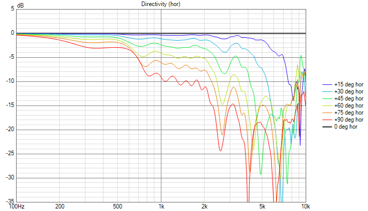

I don’t believe this odd jump is related to the woofer, or the transition from woofer to mid. I think it is endemic to the mid driver and its cabinet. What follows is my reasoning:
First take note of the 12" woofer DI. This is a raw response, but DI is independent of filtering so any EQ I apply would not change the DI.
* View attachment 1153164

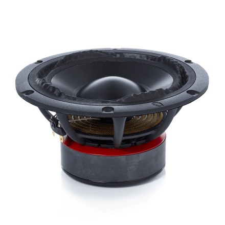

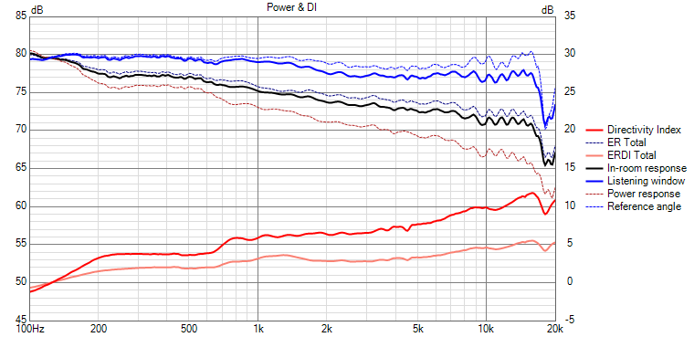

Next we look at the MW16TX-4 DI, as measured in its cabinet. Notice the jump in directivity between 500-900 Hz; it matches the full system simulation in this area.
* View attachment 1153165

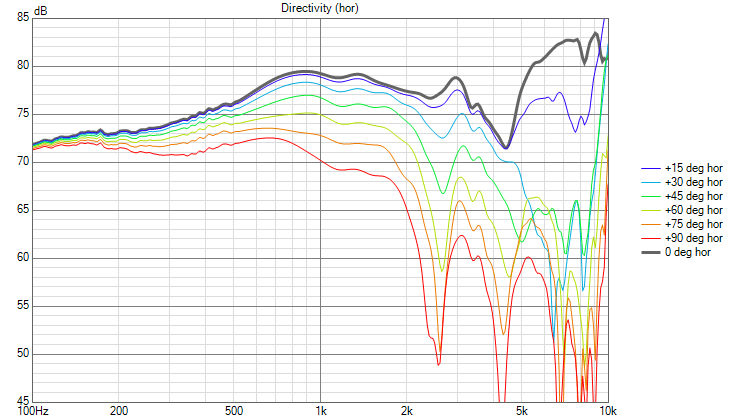

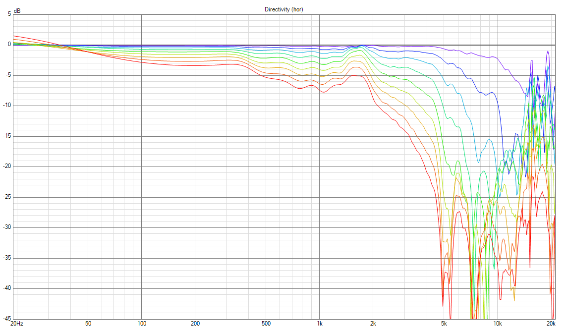

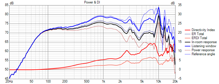

I also have some recent data from an SB17CAC35-04, installed in a cabinet very similar to the TX system. Take note how the DI is much more smoothly increasing in the 500-900 Hz region compared to the MW16TX-4 data.
SB17CAC35-4
* View attachment 1153167

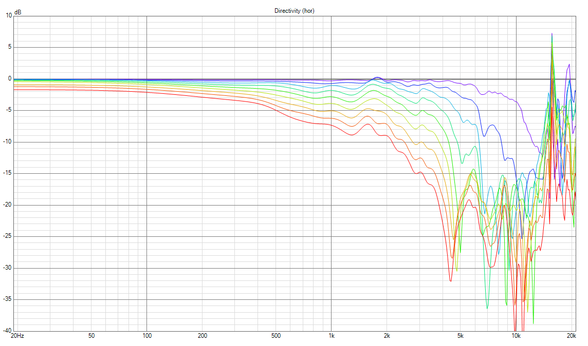

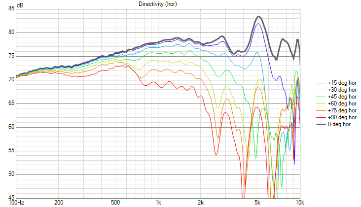

Next I substituted the SB17CAC35 into the full system simulation, and adjusted the eq and filters to get a reasonable response. The result is that the odd jump in directivity is smoothed out.
With SB17CAC35
* View attachment 1153173
With MW16TX
Now the really strange thing is that the two cabinets for the two mids are very similar.
The MW16TX-4 cabinet is 343 H x 254 W x 248 D (mm), with 37 mm radius edges on the sides, and a 37 mm 45 degree bevel on the top. The SB17CAC35 cabinet is 330 H x 254 W x 229 D (mm), with 37 mm radius edges on the sides, and a 50 mm 30/60 degree compound bevel on the top.
At this point I have several theories on why there is a difference, but I’m not really enthusiastic about any of those theories. My leading theory is that this is just inherent to the drivers. When I look at hificompass.com, and look at 6” – 7” drivers from ScanSpeak, SB, Seas, Purifi, I see that the off-axis response from 500-1k varies quite a bit driver to driver. If I look at the normalized off-axis response in the 30 dB scale, it is apparent to me that all of these drivers will have variations in power response and DI of +/- 2 dB from 500-1k.

Here's my farfield (1m) measurements taken recently of a midwoofer with a 10ms window:
There's definitely some bunching up at 500Hz.
I think it's driver +/- cabinet related.
Or is it an observation effect...
TBC...

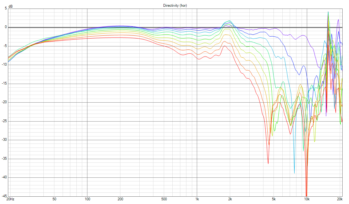

Here are my horizontal polar measurements of the two drivers in the two cabinets. These are 0-90, 15 degree increment.
First MW16TX
MW16TX Normalized
Now SB17CAC35
SB17CAC35 Normalized
I don't see as much "bunching up" at 500 Hz as you have with your system, but I do have some of that effect.
VituixCad does not simulate the effects of cabinet shape beyond the baffle shape, so the differences in cabinet depth/shape/profile are not accounted for. @Patrick Bateman (and others) have shown a measurable difference in polar response based on the size/shape of the cabinet behind the baffle. @mabat and @fluid have shown us simulations that have differences in polar responses based on the size/shape of the cabinet behind the baffle. So what you are seening is probably real, but I don't have the tools to explain what is causing it or to simulate it...

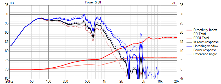

Here is the ABEC model (horizontal response) for the TM I'm building and posted about in my waveguide thread. There are minor tweaks you can make to it, but other constraints can keep you from doing a whole lot. I don't see it as much of a problem. It is interesting that Jim is seeing so much difference between similar cabinets with different drivers, especially at low frequencies like this. Still, I don't see much problem when you get down to the Schroeder frequency when the room will dominate the response here anyway.
![kung27J.png](https://i.imgur.com/kung27J.png)
I tend to agree. But this is an area where I am careful to keep an open mind. Many people have gone to a great deal of effort to manage the directivity between 100 - 1k. A cardioid mid-bass system is a big effort, and it can increase the DI by 3 to 4 dB in this region. Same with a multi-entry horn, a lot of effort for a 3 - 4 dB increase in directivity in the 100 Hz - 1kHz range. To some people, this relatively small increase in DI is well worth it, so I am very open minded on the subject.Still, I don't see much problem when you get down to the Schroeder frequency when the room will dominate the response here anyway.

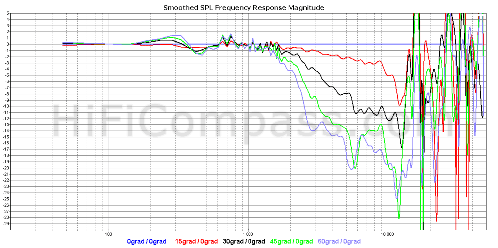

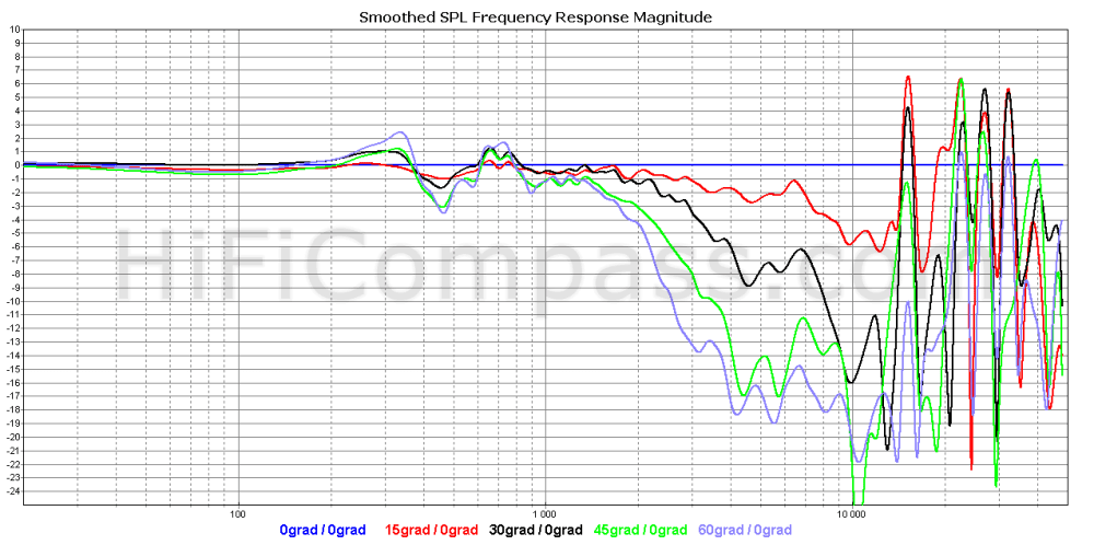

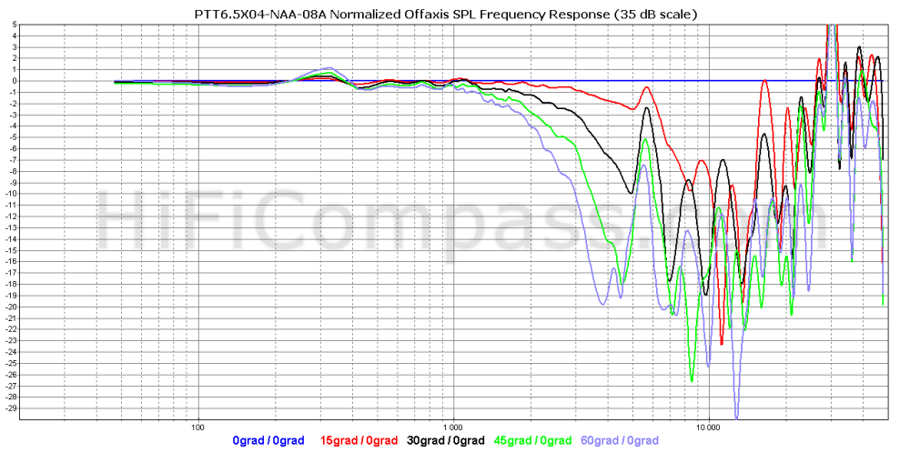

For example, look at the 100 - 1k normalized response of these four drivers:
ScanSpeak 18w/8531g00
SB17NBAC35-8
Scanspeak 18m4631t00
Purifi PTT6.5X04-NAA-08A
Thank you @HiFiCompass for these plots which were generated under very consistent conditions.
Even in the exact same cabinet, all four drivers would have +/- 2 to 3 dB differences in DI and ER at various frequencies below 1k. It seems to be the surround or the cone edge/surround interface that causes the differences.

I probably should have elaborated in post #130 a bit more... Here is my interpretation of the off axis behavior of the four drivers, and what it probably means to the directivity.
Scanspeak 18W/8531G: Omnidirectional at 100 Hz, with an increase in off axis energy at 300 Hz (negative directivity), followed by some positive directivity at 450 Hz, then negative directivity at 700 Hz, then behavior above 1k as we would expect.
SB17NBAC35: Some small directivity at 100 Hz, Omni at 300 Hz, quite a bit of directivity at 450 Hz, omni at 700 Hz, then increasing directivity above 800 Hz. Directivity from 800 Hz – 2kHz is more than we would expect for this size driver.

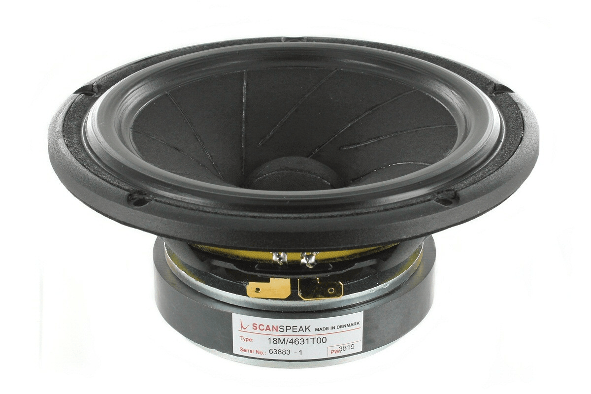

ScanSpeak 18M4631T: Omnidirectional until 200 Hz, then negative directivity at 300 Hz, quite positive directivity at 450 Hz, Negative directivity at 700 Hz, and behavior above 1k exactly as we would expect.
Purifi PTT6.5X04-NAA: Omnidirectional to 250 Hz, then slightly negative directivity at 300 Hz. From 400 Hz to 1.2k, the driver is omnidirectional.
No surprise that the Purifi has excellent performance. The best explanation for these driver-to-driver differences is the cone edge/surround interface, and the kind folks at Purifi have put a lot of effort into engineering a good surround.

Some comment on the measurements of HifiCompass, the freq axis wasn't constant, I got puzzled a bit. But after correcting, all the drivers but the Purifi show a quite common response. Surround? Cone depth?

The bump frequency goes higher with angle, which means the path length difference of the interfering sounds decreases with increasing observation angle.
Bump at 400Hz means two (or more) sounds interfere constructively at 400Hz, which means their path length difference is multiple of wavelength at 400Hz, which is about 85cm.
Other option is, edge diffraction related back wave which is in opposite polarity to direct sound and would show constructive interference when path length difference is multiple of half wavelength, ~42cm.
Both path lengths are so long indicating the cone shape has nothing to do with it with less than 40cm diameter cone. Its most likely sound diffracting around the box. If baffle is 40cm wide, path length from cone center of it to the further edge and back towards the off-axis we observe at is about 40cm when at 90deg angle. If baffle is only 20cm wide, and perhaps 30cm deep box, then path length from the cone center around the front edge to back edge on the side we observe at is about 40cm and you'd have it. Also, with 20cm wide, 30cm deep cabinet sound all around the box from center of the baffle to center of the back wall would take about 50cm, depending on angle where you observe at its more or less, but this is in the same phase as direct sound and would make destructive interference ~400Hz as its roughly half wavelength difference.
So its probably some error in the measurements due to windowing or something else, or its diffraction that happens behind the baffle. If baffle is large, it could be diffraction on the baffle edge, but in this case there should be more diffraction even lower in frequency due to the backside explained above.
If driver is large, then it could be from the driver. If driver is 15cm in diameter and 5cm deep, there should not be peak of constructive interference below 1wl, below ~2kHz. There is destructive interference to 90deg off-axis when the diameter is half wavelength, and some even below, about 1kHz.
Interference peak at 400Hz makes sense when its from secondary sound source other than the driver, when the driver is small.
Since the bump gets higher frequency with increasing angle it indicates its the back edge. Reduce it by rounding the back of the box. Get it lower in frequency by making the box deeper, get it higher in frequency by making the box shallower.
What comes to hificompass measurements, It looks like edge diffraction of ~2 meter baffle. As the graphs are normalized to on-axis, we get boost at off-axis when there is dip on-axis. On-axis dip around 300Hz is about meter long, so ~0.5 meter path length difference, or 1m if secondary sound making it is in opposite polarity. edit. Gotta confirm this
