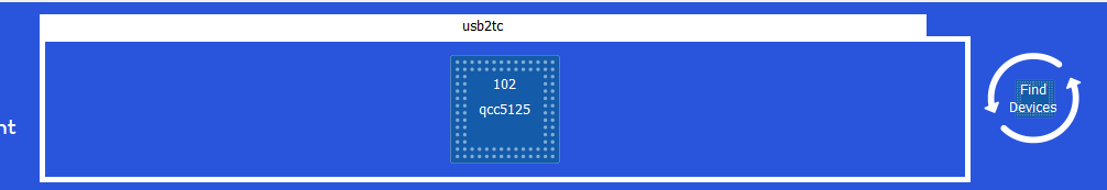

Do someone can help me with usb connection with qcc5125?
Drivers seems to work, I can see the qcc5125 in the ADK Configuration Tool and can configure it,
but I cannot connect to it in qcc tools to change name, nor in qact to configure DSP.
You will find screenshot of the differents involved windows.
Thanks a lot
Hugues

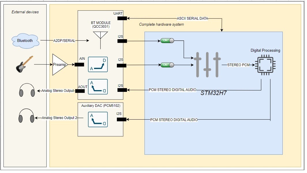

Hello guys, I am running a big project now and I am a bit lost with the bluetooth part. It seems like some of you have been playing with these modules so if i could get some general guidelines would be super helpful. I posted an image of the block diagram just in case.
Basically what I strictly need from the BT module is:
In addition, it would be nice to have:
I have been checking QCC3031 modules like the BTM331 or TS3031 which, on paper, seem to meet all those requirements.
However, I have no idea on how to procceed with the configuration of these modules. Things like routing analog inputs to I2S outputs, or configuring the firmware to send serial data over UART whithout stopping A2DP sink.
- Receive AptX audio and stream it over one I2S interface.
- Simultaneously be able to receive some serial data and send it over UART/I2C/SPI etc.
- Mic/line inputs routed to one I2S output just to act as a PCM ADC.
- The speaker diff output routed to play what comes from one I2S input just to act as a PCM DAC.
So to do these things, should I procceed just connecting over USB to the D+ and D- pins and configure all these peripherals with ADK? Or do I have to do it with SPI and CSR programmer? Any recommended development board which doesn't cost 800$? When using ADK/MDE can I brick the module? I don't even know what things you can change with ADK because I still couldn't connect a module to my PC.
So far what I did is, I bought some of these modules on aliexpress, some of them embedded on speaker amp boards which will be kind of my low-cost development board. While they arrive I downloaded MDE and ADK and have been reading the QCC3031 sink firmware, but it would be cool not to edit code on the firmware obviously.
Sorry if this was too long, thanks to all the folks who posted here their experiences with these. Any suggestion will be super appreciated.

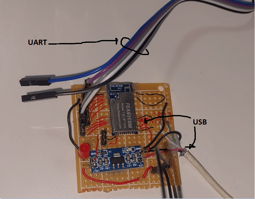

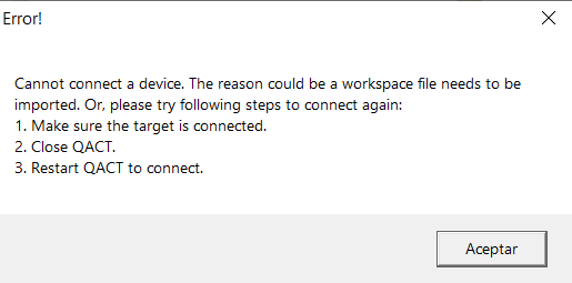

Hello guys,
I got some things working. I am using the fasycom FSC-BT1026, based on the QCC5125. I connected it over USB directly to the chip and was able to dump the firmware using the NVSapp, however I am facing these two problems:

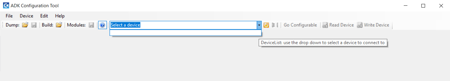

1. I can't connect over ADK config tool. I am able to load a config set dump file from a QCC3031 that a mate shared in this forum (Don't know if are compatible), but I don't see my device on the list so I can't do anything. Do I need to connect with the USB-SPI programmer or something?

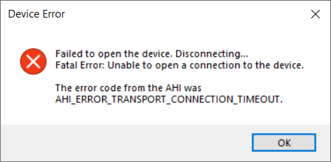

2. I cannot connect with the QACT tool either, and it shows this error:
Any ideas?
Any ideas?
Thanks in advance.
So basically, I got what you can see in my last reply. I looked for the schematics of the development boards of feasycom to see how the module should be wired to work properly. I also found this russian post which was of some help.did you manage to connect the qcc3031 to your pc? If you did, what did you do? I have the same questions as you
https://habr.com/ru/articles/700102/
Honestly I think that, if you are going to work with the feasycom modules, it is worth to get the development board. It takes a lot of patience and time to solder on these pins. You have to wire the usb cables and power depending on your module, maybe you will need an LDO as I did in my case. You should find this info in application schematics and datasheets of your module as well.
Once you have the hardware prepared you will have to follow the instructions on "QCC30xx USB setup and unlock (EN).pdf" (you can find this pdf and more useful info in this forum, i don't remember if it was in this thread or the CSR one, but if you struggle to find it I can check for you).
With this I was able to use the QCC_Tool, NVSapp, Feasycom serial console... but I am not being able to get into the real stuff which is ADK config. I think MDE works though, as it seems it is recoggnizing my chip.
However I would prefere not to create a new firmware but just change some stuff on the Feasycom's stock firmware. If I don't find a way to work with ADK I will have to make my own firmware with MDE, but obviously this is much scarier.
At this point I am trying to follow the same proccess with a BTM331 and see if I get access to the ADK.
By the way, if you find Config dump files for QCC5125 share please, I couldn't find them. I have one for the QCC3031 but I don't know if those are compatible. I don't actually know if I need these files in ADK because I can't connect, this is kind of like killing flies with a stick lol.

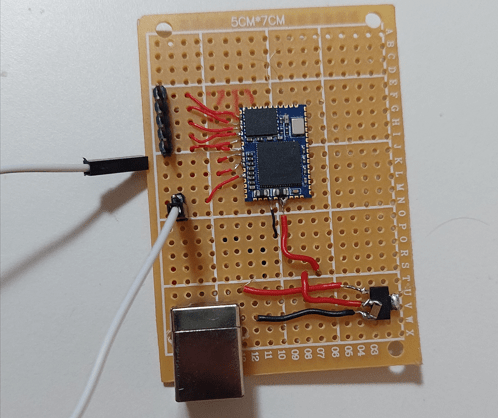

Hi R8Bert,
Yesterday it was a bit late and didn't reply, but I had the same problem as you with the BTM331.
Look how cute this one turned out... much cleaner than the first attempt
My guess is that some of these chinese manufacturers, when making their custom firmware for their modules, they lock them or something that prevents you from accessing the ADK tool. In this BTM331 I can dump the firmware with the NVSapp, and connect over the QCCTool, but I can't connect over ADK config, MDE or QACT either.
To sum up the differences are:
So with that said, I think what I am going to do next is burn in this board a firmware that a mate here shared for a QCC3031 with NVSapp, and maybe this new firmware will not be locked and will let me access to the MDK. If it is still locked I will go eat chinese food and see if it the chip then gives me permission.
See you on the next failure guys, have a nice day.
- With the Feasycom module, ADK doesn't even recognize the usb device, so it doesn't show in the list. When connecting the BTM331, it shows up in the device liste but when I click on it I get the timeout error you posted.
- QACT detected the Feasycom module but couldn't establish the connection showing an error window. With the BTM331 it doesn't even detect it.
- The Feasycom was detected by the MDE as I showed in the screenshot. The BTM331 doesn't even get detected by MDE.

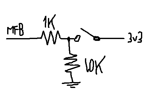

I followed this schematic too. Honestly I don't know what this pin does in te btm331, but I think it is something configurable with the firmware. On the Feasycom modules, for example, the system control pin is actually what turns on the bluetooth and everything. I honestly think that it is not necessary to start working with ADK, but I am not sure.OK i managed to achieve the same result. It works now. The main question is
This remains the same ? I dont want to mess it up
What I did is I connected the MFB to a 2-pin header that switches it into GND or 3v3 as this schematic. 3v3 comes from an LDO from the USB 5v.
