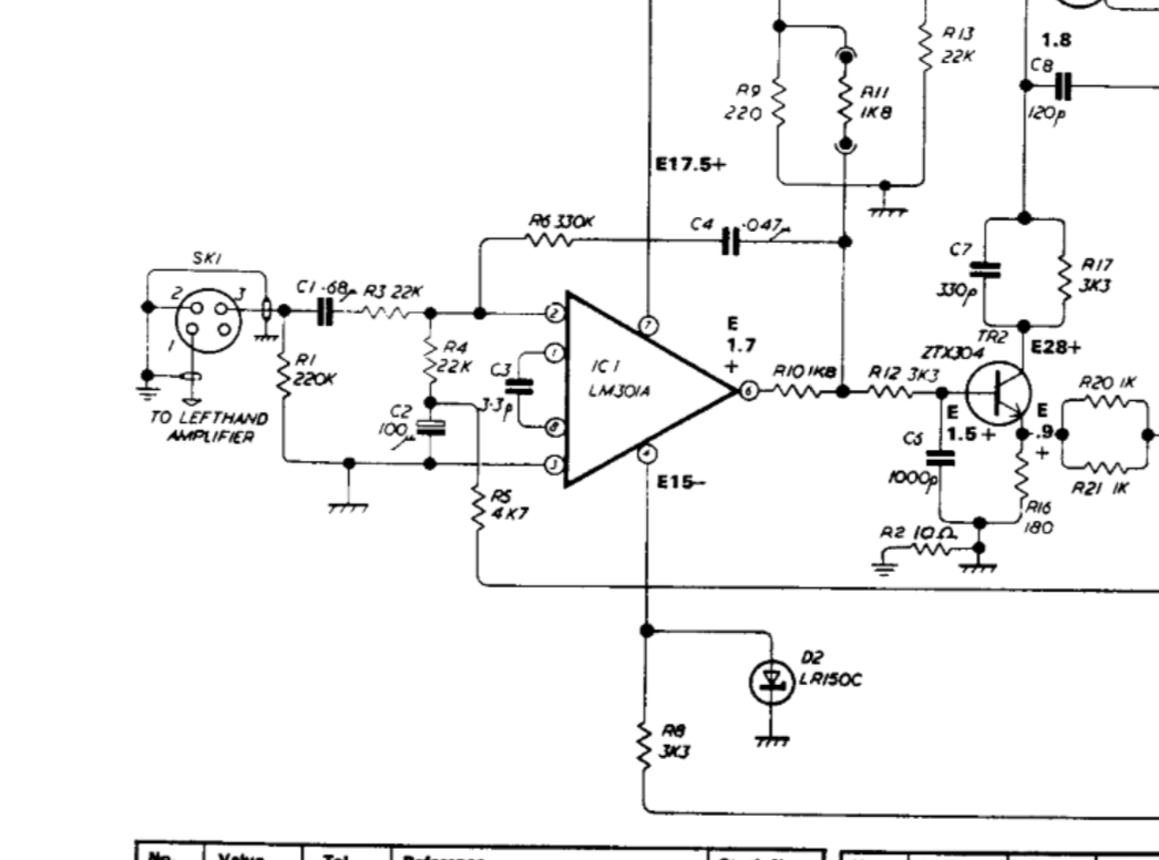

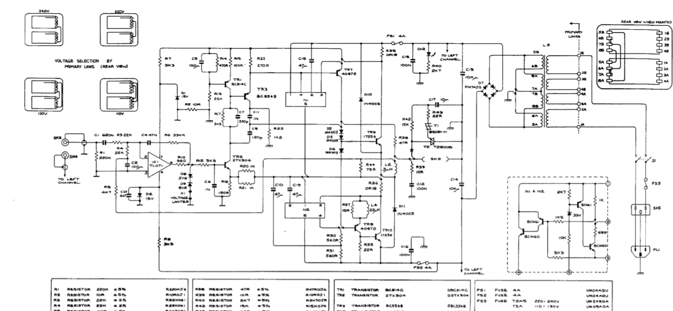

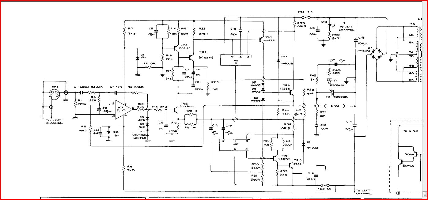

You mean these. Chassis and circuit grounds are clearly shown but where or if do they physically connect.
Edit... actually I see it now on the zoomed image. R2 to the lower right of the opamp.
Looks like Quad use the 3bars in a triangle shape as the Chassis symbol.
And use the line with 4 angled tick marks as the Audio Ground symbol.
Chassis is connected to Audio Ground at SK1 and at R16

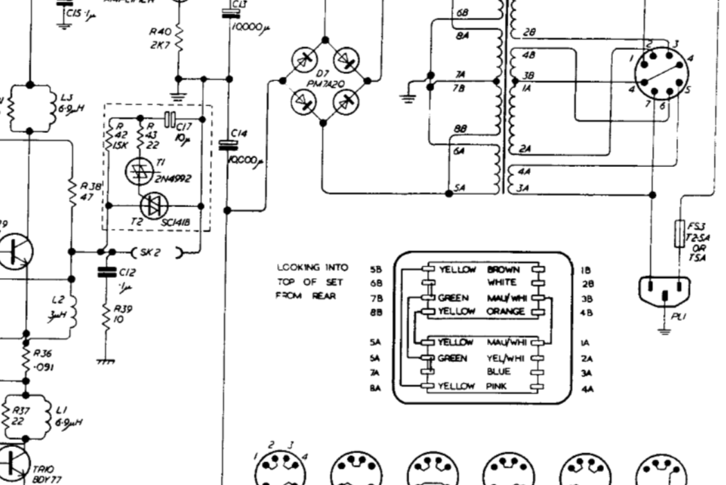

Chassis is connected to PE at the power input socket.
Are there any other Chassis connections?
