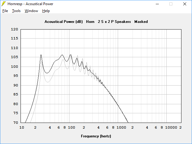

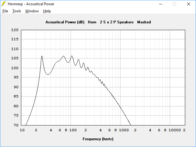

A single cabinet with the driver you used.
A four cabinet response in black with the single cabinet response in grey.
May I ask, is that a theoretical sim or measured response? That dip in the lower end is deplorable and frankly a little discouraging.

Well that is a simulation of the actual build information you would be working from.
Hornresp is actually pretty accurate. But anything that has a sharp null or peak is usually not as bad in practice.
The notch might not be as bad as simulated. But the lack of the ultra low end is due to a short path length on the horn.
Bill made some intelligent choices as to what to compromise for getting the biggest bang in a theater experience.
The rippled response is nothing to worry about.
I design low frequency horns with a purposed ripple limit of plus or minus 3 db. We really don't pick it up when listening to music. And an in room response is usually way worse than a simulation in terms of ripple.
