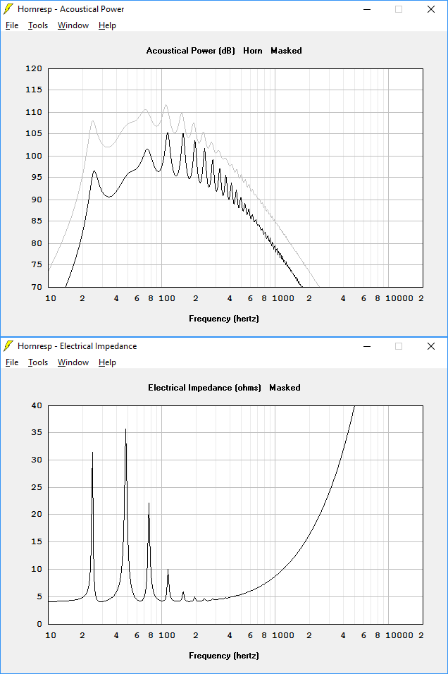

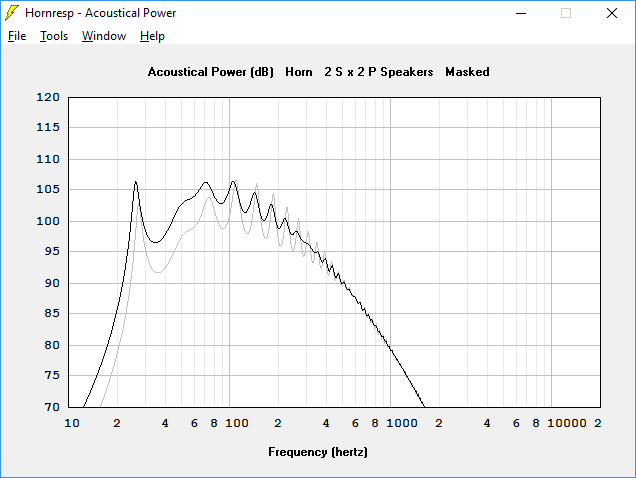

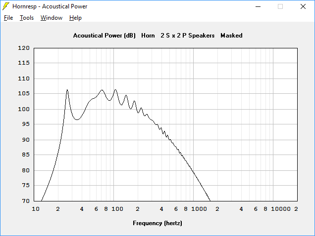

I'm looking forward to seeing measurements to. Hornresp is pretty good at simulation of what an enclosure will sound like.
But nothing beats a microphone.
Best way to measure a horn is outside on the ground. Put your mic on the same surface as the enclosure. If you want to you can place a sheet of plywood down to give a clean surface. You can get the equivalent of one watt one meter by putting your mic 2 meters from the mouth and delivering 1 watt as calculated from the drivers nominal load. 2 volts for a 4 ohm driver or 2.86 volts for an 8 ohm driver. Best if you have 30 feet from large objects like buildings. If you can pull off the proper space from reflective surfaces you have a pretty accurate measurement.

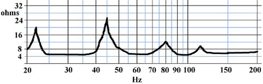

On microphones.
The Dayton mic with the USB port UMM-6 and REW REW - Room EQ Wizard Room Acoustics Software is a great combination.
If you want to do it on the cheap (and completely portable except the amplifier) but still quite accurate you do with Audio Tool by Julian Bunn and a imm-6 mic. You will need a cable that goes from the 3.5mm jack to RCA to send test tones to your amplifier.
Pink noise is the least annoying of the test signals and is a pretty fair test of a speakers output. Pink noise approximates the sound intensity of normal music. It rolls off slowly as you go higher n frequency at 3db/octave. (doubling of frequency ie: 32 to 64 hertz, or 64 to 128 hertz). White noise is also a broadband signal that is flat across the frequency range.
REW or Audio Tool have built in means of producing and measuring the output via a microphone.

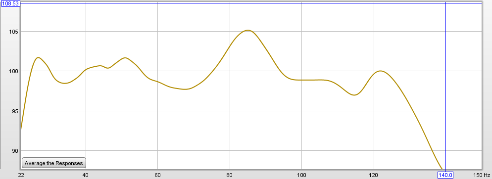

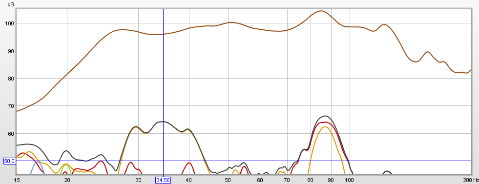

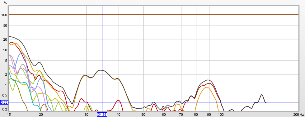

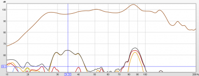

i did a quick and dirty measurement of one of mine... this is a 16" wide (overall) variant loaded with a jbl gt 12 dvc that has to be 12 years old, if not older. i have no horizontal mouth brace and i built off the plans that were published in speakerbuilder magazine back in '08 or whenever that was. using entire rear chamber volume.
these are indoors, the sub facing upwards in a corner, but measurements taken at the mouth. distortion measurements as well, c-weighted spl meter and levels verified, so actual spl. default subwoofer crossover from my avr
for what it's worth.
Nice graph! So you used the 36" width rear chamber volume with the 16" wide horn?
if im understanding correctly, no. i just used the whole chamber. as per the article, if i recall correctly, there was a board to be installed in the rear chamber when using a 12" driver. post #49 has a great picture of that rear chamber with the driver mounted, when using a 12" driver a board is put in to lessen some of that space.
haven't bought any of bill's plans ever, as he gave away most of those designs in speakerbuilder/audio xpress over the years, so i dont have any of the updates etc. i think he also specc'd the ability to use 2 - 10"ers in the article as well.

A single cabinet with the driver you used.
A four cabinet response in black with the single cabinet response in grey.
Hi, was just about to ask for the corresponding HornResp sim for this design. Do you mind sharing?

Do you have the model number or possibly Thiele Small specs for your driver?
And if I remember correctly you used one?
single driver, ill look for the spec sheet, pretty sure it's a jbl gt120d.
Brian you have mail.
And I have a confession to make. I messed up the TUBA names.
Given a generic driver this is the response as calculated.
Impedance as measured in the build article:
Looks like the right driver combination may smooth out the dip in the response.
Or the smoothing used in the measurement filled in the dip.
That's why I'm interested in the specs of the driver used in snappyturtles horn. Hornresp is usually pretty close in the simulation versus measurement.
![TUBA HT with JBL GT12-5.png TUBA HT with JBL GT12-5.png](https://www.diyaudio.com/community/data/attachments/535/535383-9eae3a24b1be64554bb9aa218baef009.jpg)
![TUBA HT Measured Impedance.png TUBA HT Measured Impedance.png](https://www.diyaudio.com/community/data/attachments/535/535406-90456ac892f294ee64b9a196fb6e1ce9.jpg)
