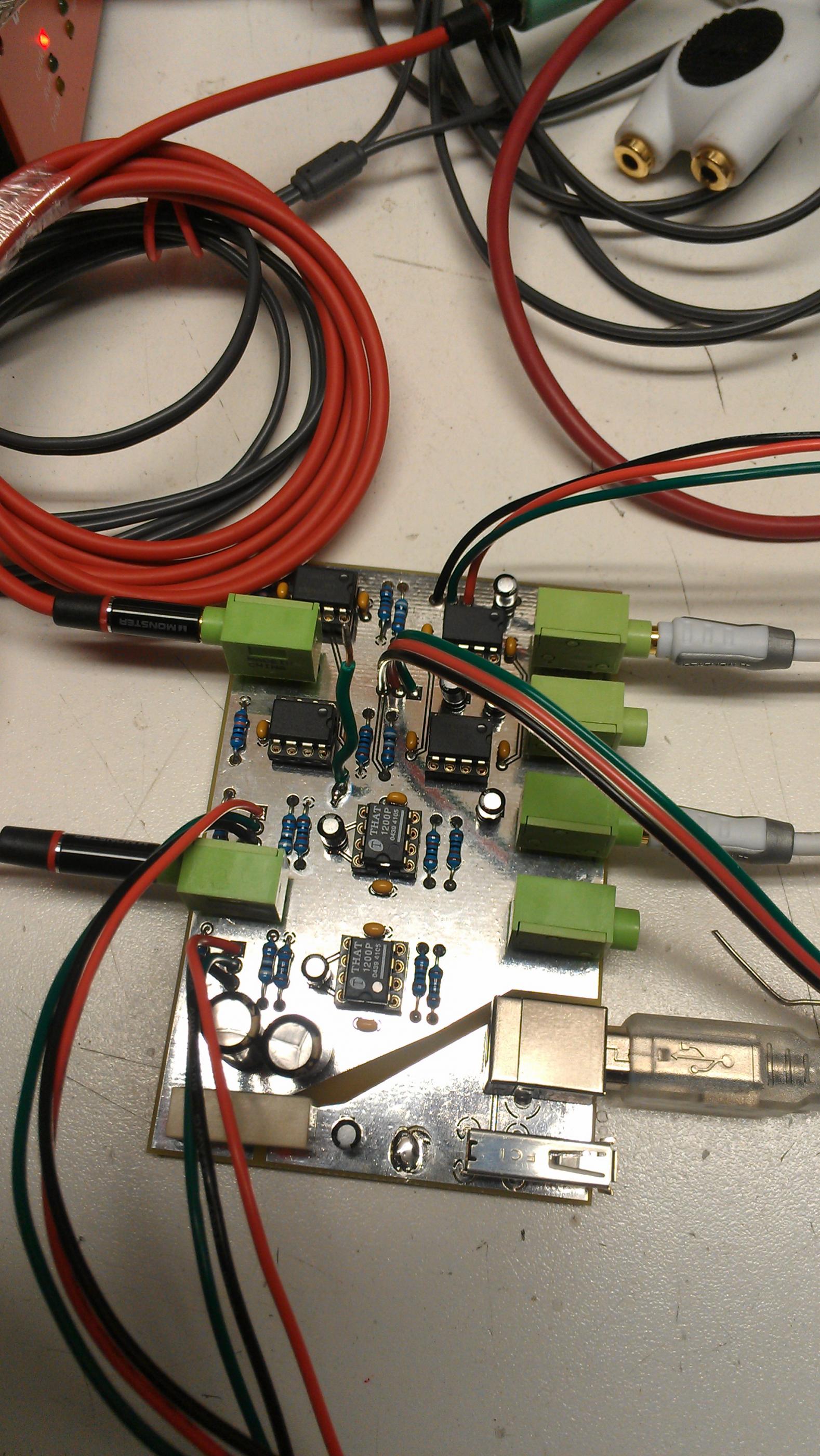

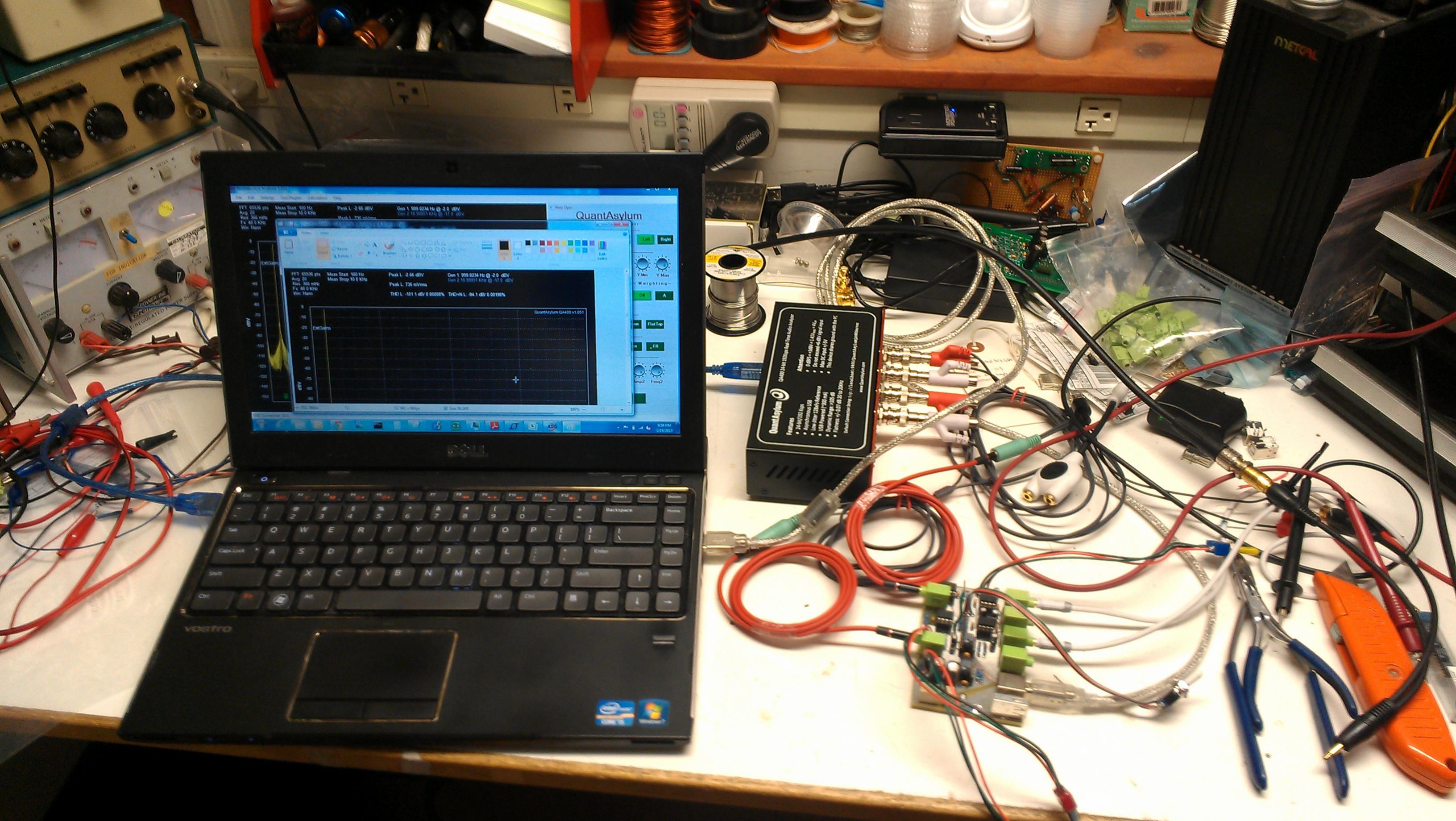

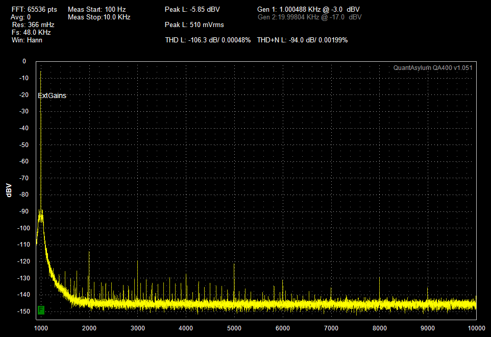

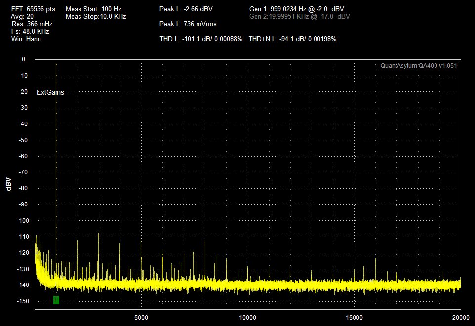

I got the prototype board running. Attached are some measurements made through it.
The layout as is works with the THAT parts. The TI differential receiver needs a few small changes to work. The holes for the minijack connectors are the wrong size, I'll post an updated version to support both input amps cleanly.
The output gain is too high. I can only get about 8V out single ended before clipping. The output driver has a gain of 2 so I need to figure out the optimum gain for the boost stage. 10X is too much.
The performance seems to be good enough to not be a limitation. I'll try to measure its real performance limits in the next few days.
The USB passthrough works on the USB3 ports on my laptop. The USB2 ports may not have enough available power and you would need two ports to power the interface and run the QA400.

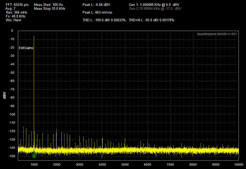

The noise is related to the measurement bandwidth and the internal noise of the ADC. And the noise from the surroundings. The loopback test has 20 dB of gain in the input booster plus the 6 dB I didn't expect from the differential driver as well as the differential receiver from THAT. The composite performance is quite good.

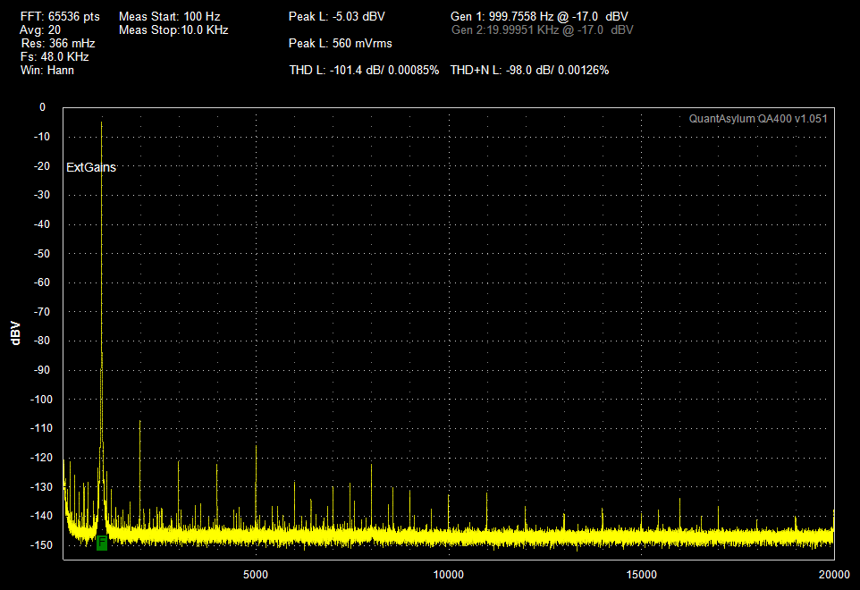

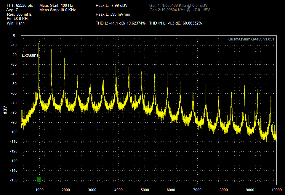

Attached is a plot from the Shibasoku generator. All the harmonics are from the interface + the QA400. I'll measure the interface tonight if time permits.
I think the noise calculation may need tweaking, especially to be consistent with other instruments. My wish list includes noise measurements per the various standards (A, C, CCIR, CCIR/ARM) and measuring in rt/Hz for noise analysis.

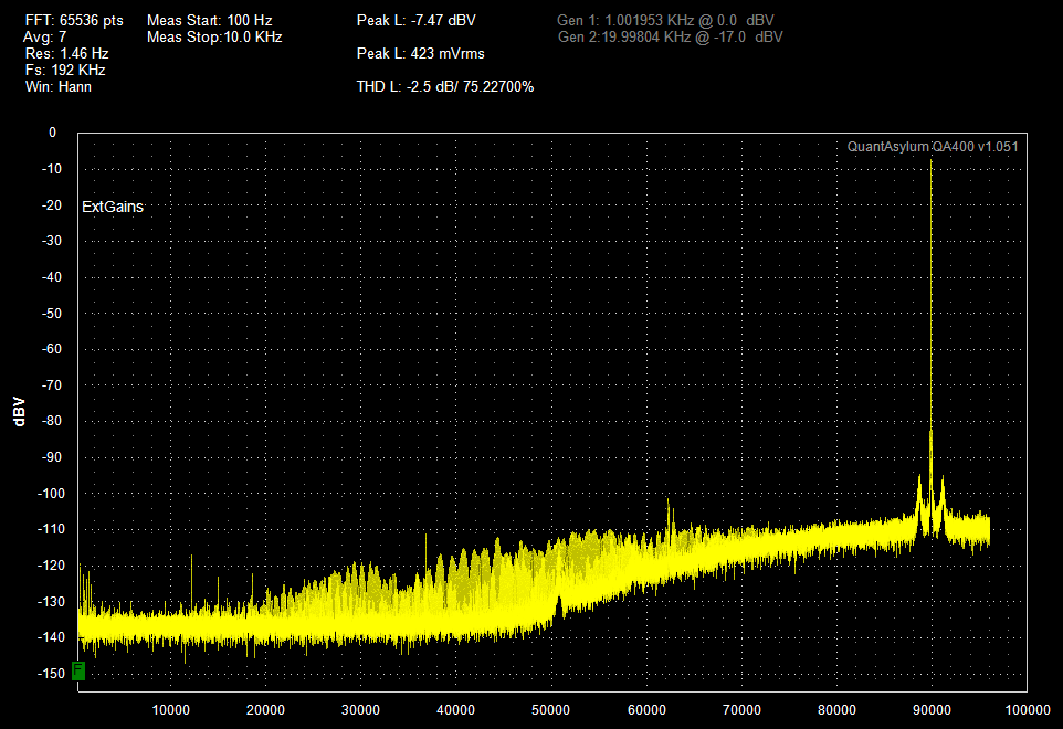

One image is the distortion analysis out of the Shibasoku 725 with a 5V signal from the Shibasoku 590AR through the interface board- bal out to diff in. The top line on the QA400 display is -100 dB from the fundamental. What you see are the harmonics from 2 up. Their frequencies are shifted from the actual fundamental.
The next plot is loopback on the QA400, 1V in and out with the gains at low.
I will make some cables up over the weekend to test the various modes, single end out to diff in etc.
So far the THAT 1200P is not limiting the performance of the QA400 which really is excellent, especially for the price. Plus I'm running this all off of a single USB port on a laptop, daisy chaining the usb through the interface board to steal power.

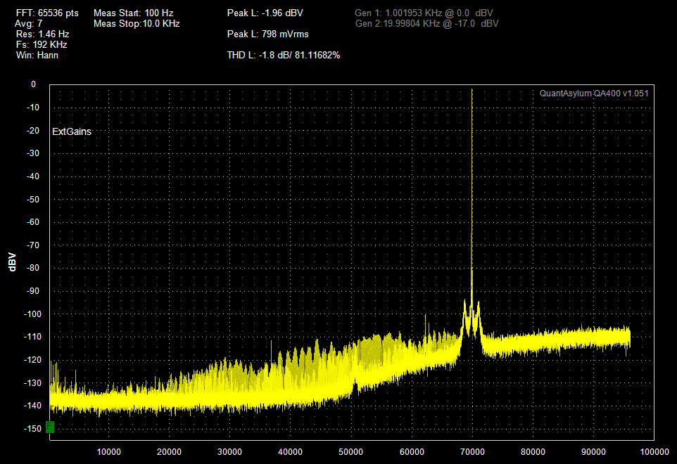

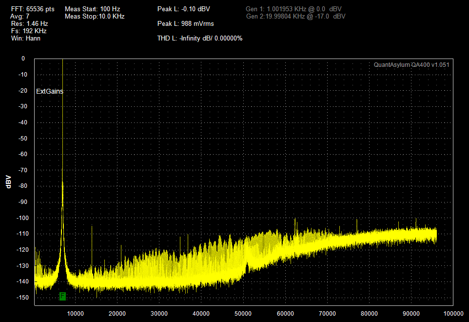

The docs are not particularly complete or clear. Attached are pictures taken at 192 KHz sample rate at 1KHz, 70 KHz and 90 KHz in at just a little below full scale. Its 3 dB down at 70 KHz and 7 dB down at 90 KHz. This performance is a litte off of the best ADC's but more than adequate for most testing. You can also see the rising noise floor that most ADC's for audio have.
