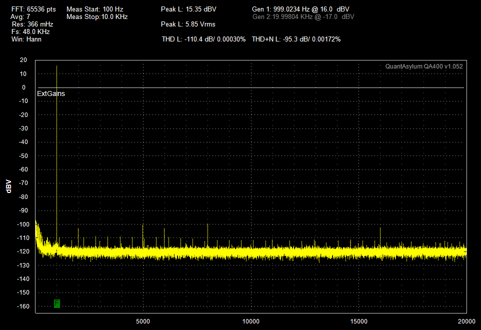

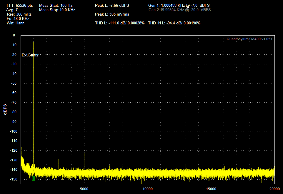

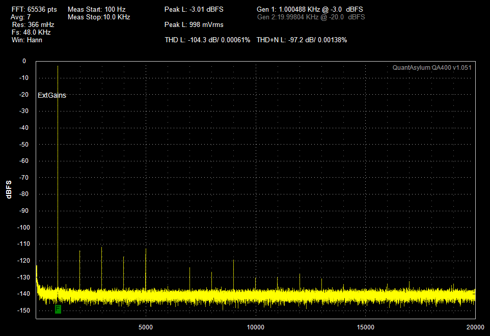

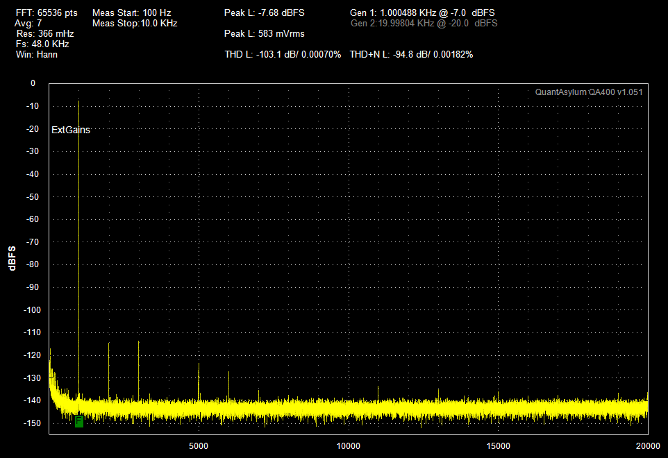

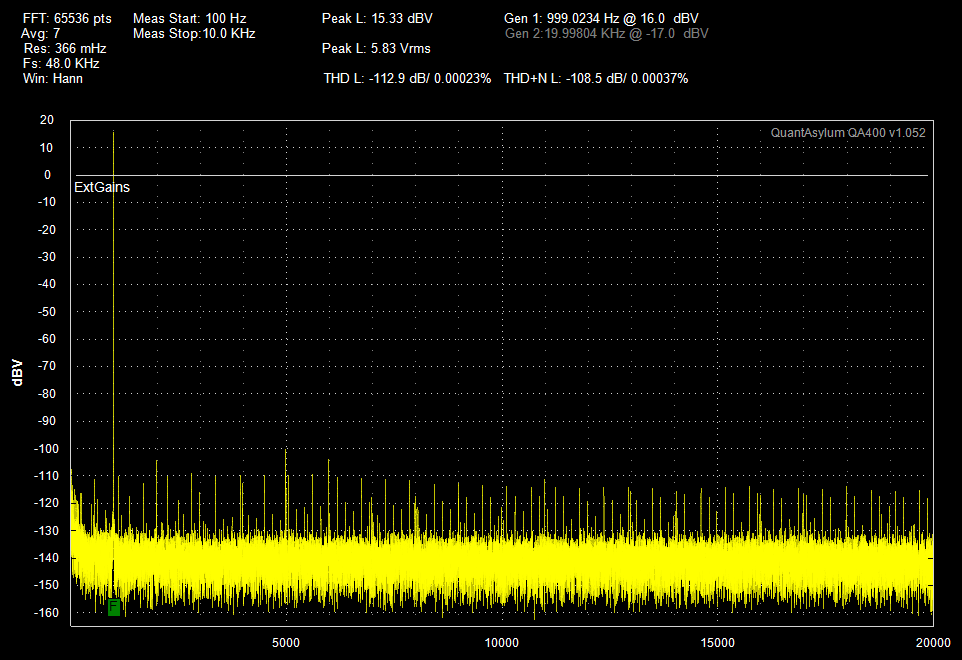

I have started making the cables to test the QA400 with the interface board. Making proper shielded BNC to minijack cables (cheap stereo to cheesy bnc's) really got the noise down. Here are a few measurements of the QA400 plus the interface in loopback.
The first is in loopback with the gain switches at unity (+6 dB for the output because of the X2 nature of the device) The external differential voltage is approx 1.2V
The second with both at X10 and the drive from the QA400 reduced. The external voltage is around 7V
The third is as the second but one side of the diff output is grounded.
The driver and the receiver get in trouble when the voltage goes above 7V RMS. I will rescale things around that limit.

Looks very, very good Demian!
I'm relieved that the 40kHz BW limit isn't - I'd hate to be able to see only harmonics up to a 10kHz fundamental or so.
I guess the droop above 60 or 70kHz could be corrected with a cal file.

OK, now that it all works and works OK there are some limitations that need to be resolved.
Both the input and the output circuits get distressed when the signal exceeds 8V RMS, even with 17V supplies. Originally I was expecting to get 10V RMS at each point but its not happening. So how to scale?
Option 1 (Current) input divide by 10 or unity, output X16 or X6: problem, both have overload issues withing the operating range of the codec. I could add a resistive divider to correct for the X2 of the output driver and the output won't be clipped when driving a balanced load at 10V but does clip on unbalanced load at 8V.
Option 2, rescale and fix both the output and input to 7V max. Operating range will all be OK but input sensitivity is compromised and the output will need significant attenuation to be linear, however both the DAC and the ADC are better at a reduced level.
Option 3, Rescale output to 7V max, leave fixed. Two settings for the input, unity (1V approx) and -10 dB (3V approx?) or -16 dB (round number near 7 V)?
Making external attenuator cables for input and output is simple and expected to deal with power amplifiers, high gain inputs etc. I want to make it easy to use and hard to get it too wrong with odd gains and different gains that make the on screen arithmetic difficult.
Any suggestions?

its more of an issue of the device under test. If its output is low that you need gain to get it in range of the input of the QA400. if its high (power amp) you need attenuation. Same for the output buffer. The issue is more one of what are you testing? if all I was doing was testing iPods and other mobile stuff (what consumer electronics has become) no gain is needed. To test a traditional preamp or connect to a higher output DAC the output of the DAC is much too high for the QA400.
And then there is the scale factor issue. Its relatively easy to add scaling factors in the software but you need to remember to do it and put the right values in.

Demian how about the age-old 1-2-5 step sequence?
You'll need some more steps but you could go like 50-20-10-5-2-1 V/V
So you would have atten steps 1/50, 1/20, 1/10, then 1/5, 1/2 and 1/1.
For low level sources add gain steps x2 (0.5V/V) and x5 (0.2V/V).
Then you would have an overload capability on each range of some 40% say +3dB.

I was trying to avoid adding the necessary protection stuff and its performance compromises. Not to mention the complexity.
If I fix the output at 7V I get on loopback .0002% THD so the extra gain is not compromising anything. (see below image)
For the input, sticking with the original concept, external probe cables with appropriate connections, a few cables can handle pretty much any input requirements. If I stick with the original X1 input gain and external divide by 10 "probe" would be able to handle pretty much any line level source. If its terminated in RCA or XLR connectors it becomes a complete solution (no more collection of adapters). A separate cable with a divide by 100 ratio and fully balanced could handle almost any power amp. Since the input is fully balanced and the external probes would also be balanced ground loops are not an issue nor are balanced output amps.
If time permits I'll finish a set of cables for this today and try it.

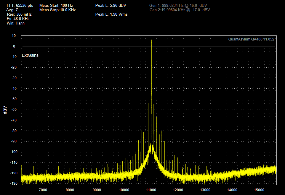

Here is a jitter measurement using the QA400 Its not scaled the same as the plots on Stereophile, I need to figure that out. The essence is here anyway. The JTest generator is attached. I have not used it in a long time so I don't remember the details.
The jitter is a function of the amplitude of the sidebands of the 11.025 KHz signal. They are very obvious in this plot.

More on Jitter measurement with the QA400

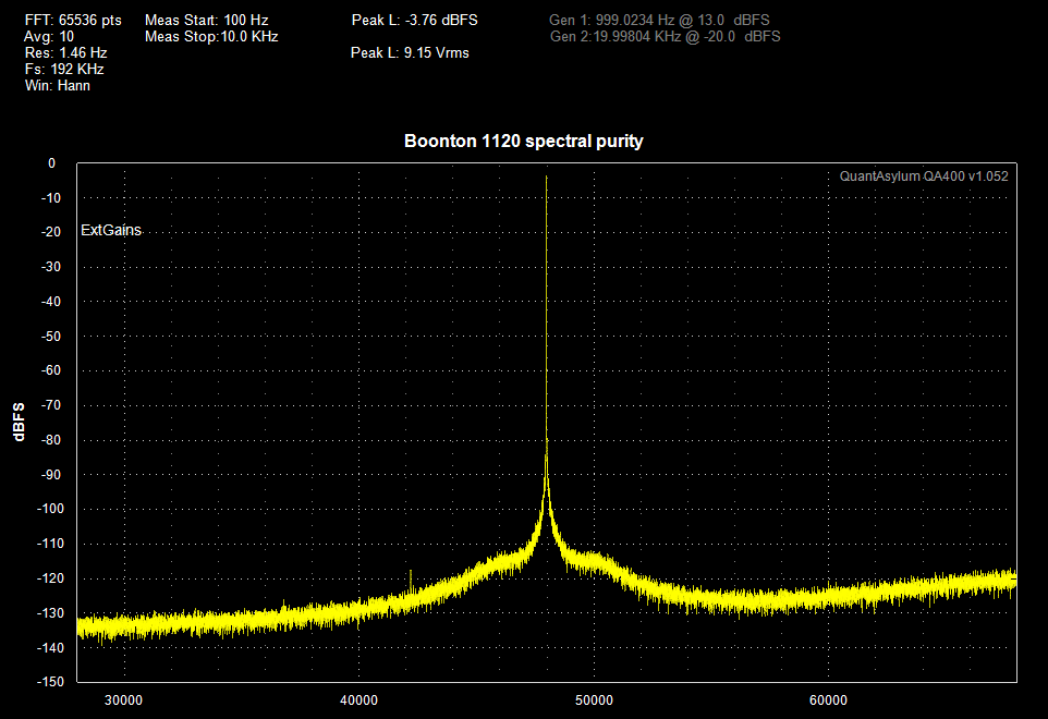

Here is another picture of spectral purity with the QA400. It shows no obvious signs of jitter in its ADC. The Boonton is a crystal stabilized SVO generator that is really good on frequency stability and pretty low noise. The shape of the noise floor probably relates to the disciplining system.
The JTest generator will generate a JTest wave file. I don't have the instructions, but Google could probably find them.
The AP used by Stereophile uses a different sample clock and has a few other differences to the plots will look a little different. However the jitter sidebands relation to the 11.025 KHz reference will be the same and the amplitude of the sidebands translates into Jitter the same way. I have some notes on the amplitude to jitter translation somewhere.
