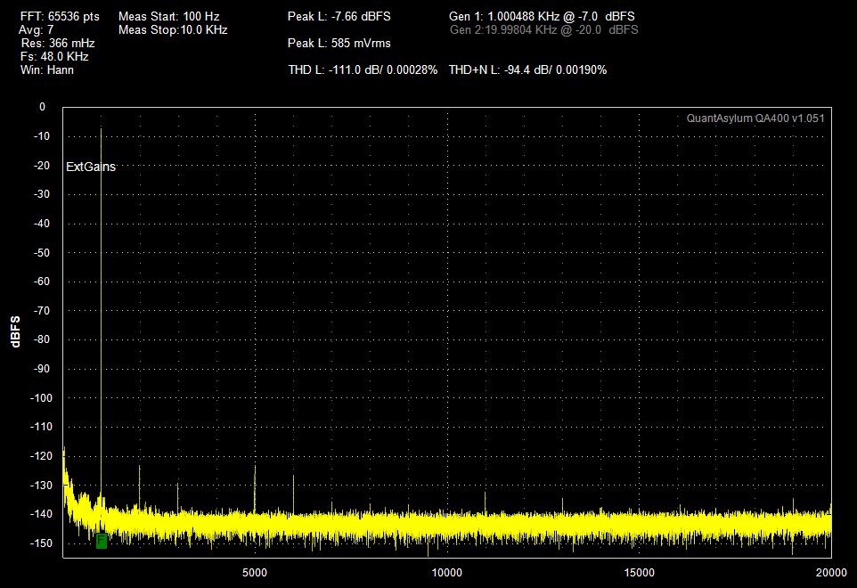

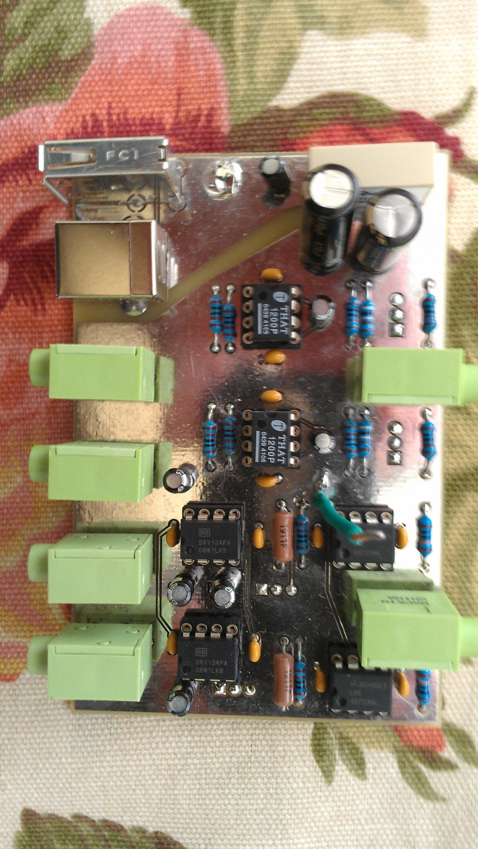

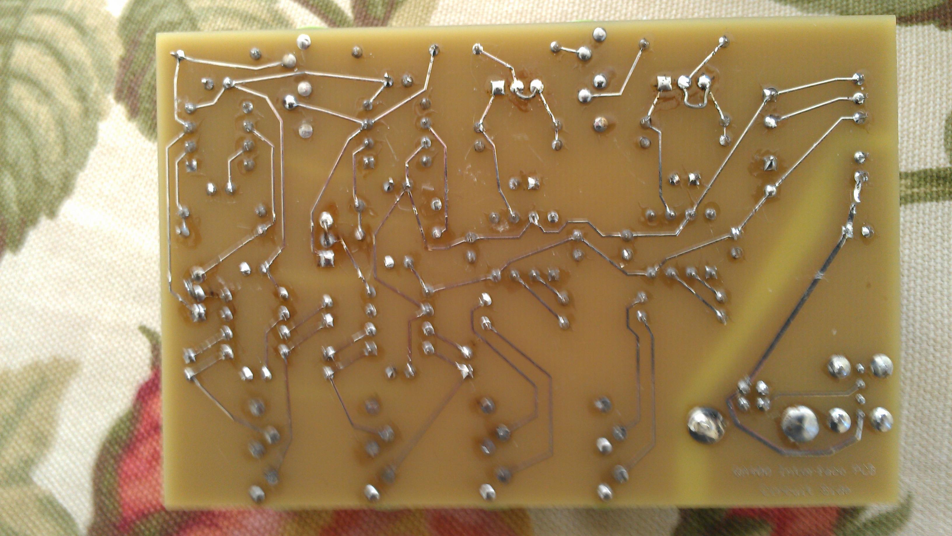

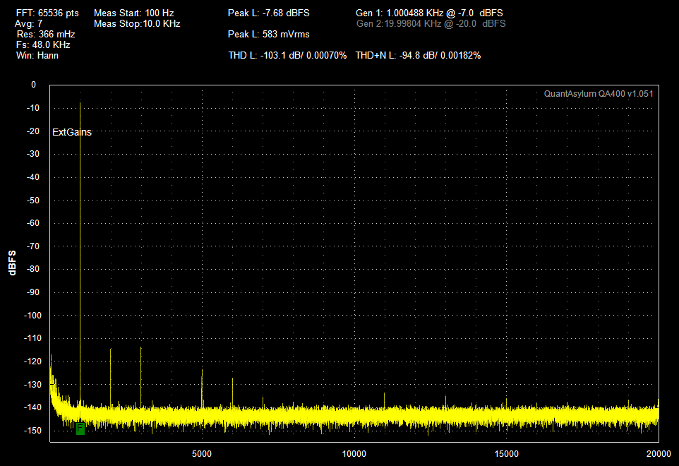

QA400 interface update #2
This is the current state of my efforts.
I have jumpered the gain switches and set for fixed gain. Nominally +16 dB out (approx 7V RMS) and -16 dB in (7V will get 1V at the input of the QA400)
With these settings the loopback gives the performance in the pictures. The output is balanced and can either pin can be shorted to ground with virtually no change in output voltage or distortion (the second harmonic rises). The input is fully differential with very high common mode rejection.
