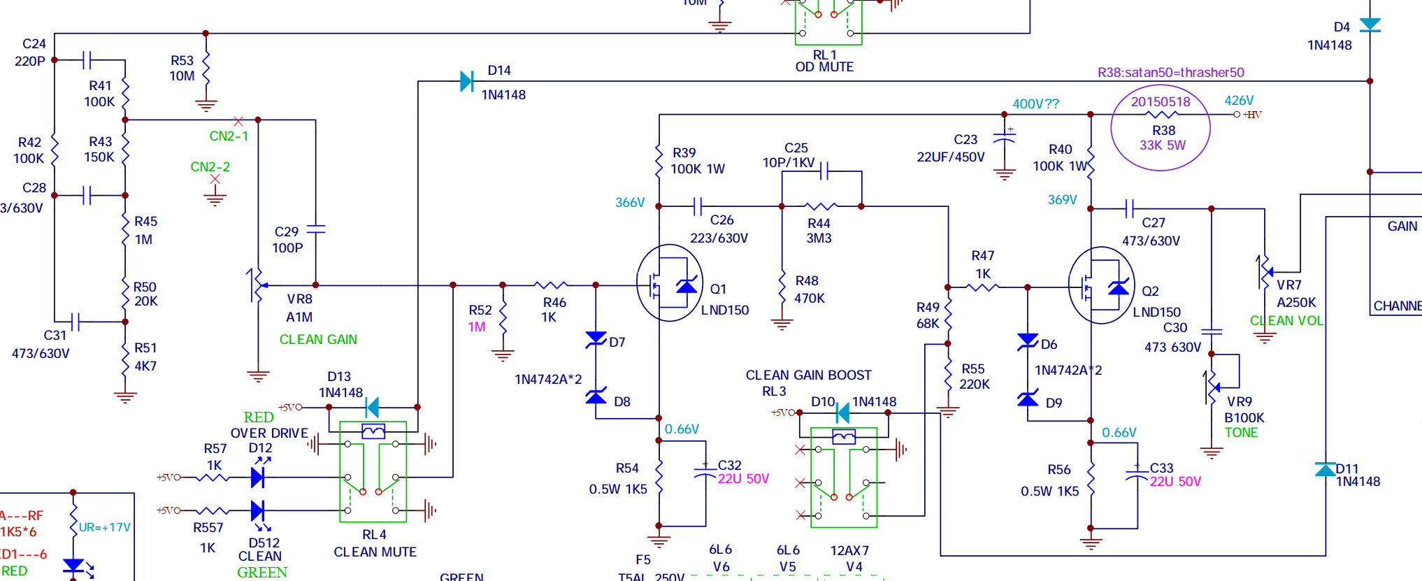

My friend has a Randall Satan 50 that had a completely dead clean channel. This appears to be a common problem with this amplifier and is caused by a bad LND150 in the Q2 position. I replaced the part and thought the amps was fixed, but the output is low and the signal is distorted. I think the part is damaged again.
I'm hoping I can get to the bottom of what is causing this particular MOSFET to go bad. There are two other LND150 in the amp and they don't appear to have the same problem. I replaced Q1 and it didn't make any difference. I only had 2pcs LND150, so I would like to figure out the problem before I try to source more. Please bear with my electromagical ignorance and rudimentary troubleshooting ability.
Some observations I've made for far: Q1 appears to be drawing roughly 0.5mA while Q2 is drawing 2.5mA. There is also 3.2VDC present on the gate of Q2 and only 2mV on Q1.

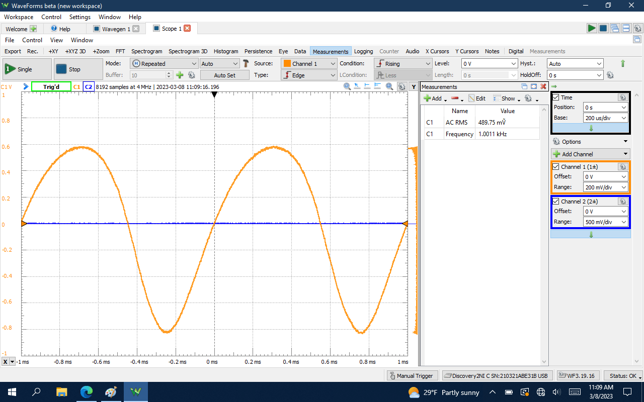

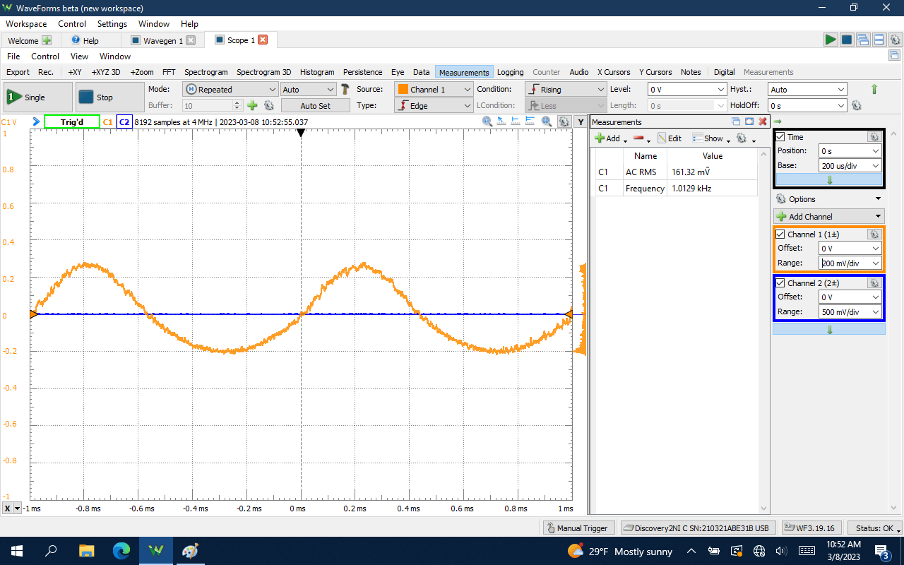

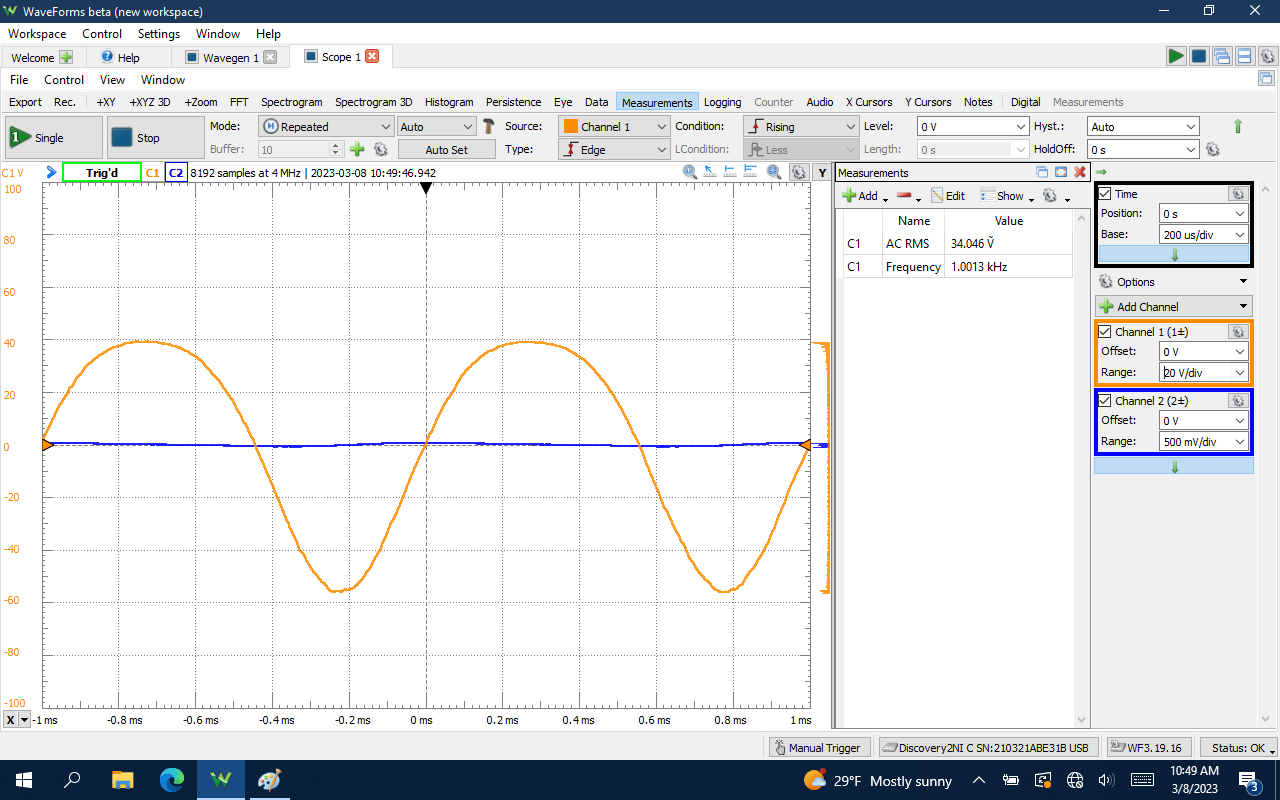

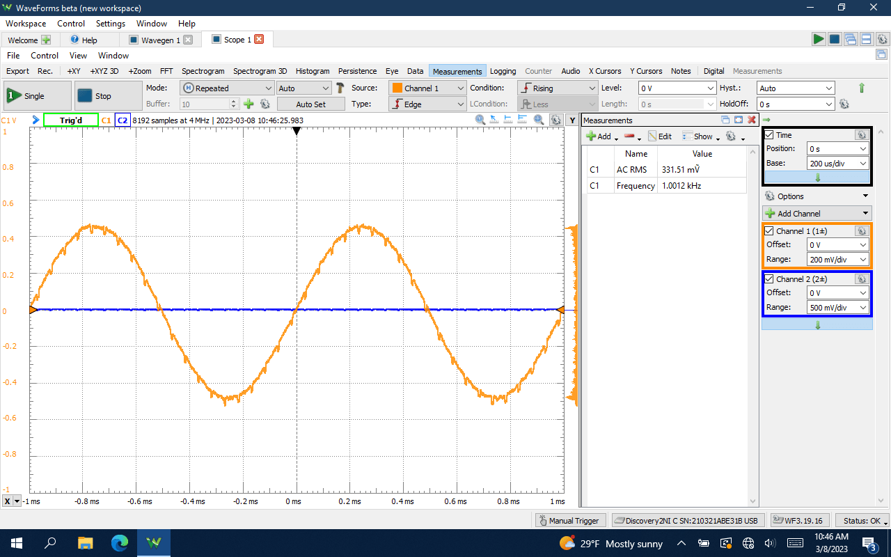

I'm attaching the full schematic, a pic of just the clean channel circuit, and a few scope shots. The signal is clean going in to Q1 and then gets messy.

Both Q1 and Q2 have 100k resistors on their drains being supplied by 400 volts. Both gain stages are nearly identical. The LND150 is rated for a maximum of 500 volts. If the problem was high voltage then both of them would go bad.

The Q1 gate is getting DC voltage from the clean gain circuit. The Q2 gate is getting DC voltage also from its clean gain circuit. Do these operate in tandem? Or can one be enabled and the other disabled? This might account for the voltage difference.
If Q2 is drawing 2.5 ma then the power dissipation will be very close to the 0.74 watt maximum for a TO-92 package. How did you measure this? Did you measure voltage drop across the 100k drain resistor?
What is the voltage at the drain of Q1 and Q2?
Do any of the resistors in the Q2 circuit get hot to the touch?

The graph for the input to R46 is undistorted. The other 3 graphs are heavily distorted.
0.5 ma drop across Q1's drain resistor should put the drain at 350 volts. That is close to the value in the schematic. 2.5 ma drop across Q2's drain resistor should put the drain at 150 volts. Which is not close to the value in the schematic. And as I already mentioned that puts Q2's dissipation close to the maximum. Which would show why it fails and Q1 does not.
The two circuits are nearly identical.

The heavily distorted measurements were partly because I had the gain turned all the way up. If I turn the gain down, the signal out of Q1 looks fine on both sides of R44. The attached pic is of the signal in and out of Q1 with the gain at about half and the boost function off. Q2 is not installed. The original pics were with Q2 installed, but partially damaged. After I removed it I can measure around 95k from G-D and from G-S. It should have infinite resistance. This was the replacement that was good when I installed it. The original in Q2 had no output at all.

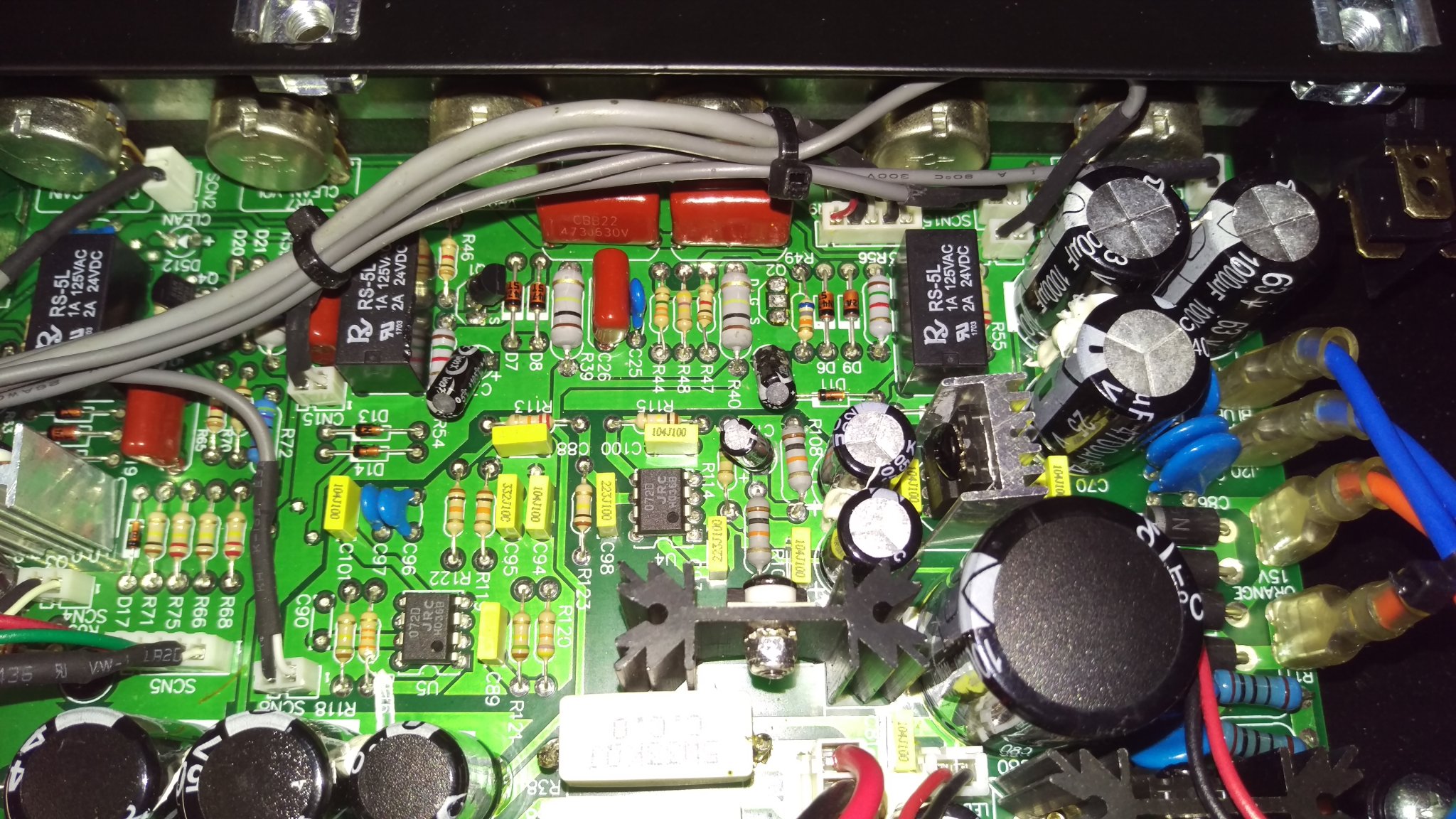

Would you post a picture of the PCB components side up?
Steve
Steve

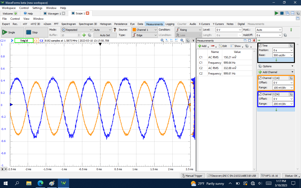

That's not even a little "messy", for a tube guitar amp (or Silicon approximation). The signal is still stronger than the distortion. As long as you can get "less" (and later you say you can) then that is not a problem.The signal is clean going in to Q1 and then gets messy.
Wish I knew how you are blowing those FETs. Are they open in the gate, shorted in the channel, what?
@ArcticBrew Yes, I replaced the original Q2 with a known good LND150. It appeared to be working fine at first when I would switch back and forth between the overdrive and clean channels. After a couple power cycles I noticed the sound of the 1kHz test tone changed when switching channels. I made the bad assumption that Q1 was somehow the problem now and used my last good LND150 to replace it. I should have scoped it first, but I didn't.
The CH2 scope signal in my previous reply is from Q1 without Q2 installed, so Q1 appears to be working fine. The top side of Q1's drain resistor measures 378V and the bottom measures 324V (so roughly 0.5mA draw on Q1). The voltage at the source is 0.72V.

The USB scope I'm using is a 14-bit Analog Discovery 2. Some of the noise, like visible in the r46_input.jpg in my first post, was from my laptop being powered from a noisy AC inverter. The scope shot in post #9 was with the laptop running off of its battery.

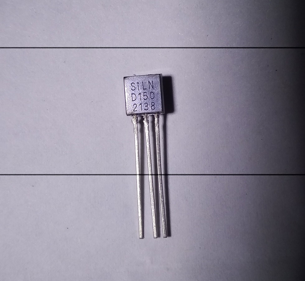

Wow. How do you know they are fake? Post a picture.
They may still work for you. Try them and let us know the results.
Steve
Steve
LOL...what a picture. I bought some a few years ago. I looked at Amazon and Ebay offerings but many of them were fake. I eventually bought 20 pieces from Mouser.
I agree do not try powering up with them in circuit.
I did as quick search online and can't find any from reputable distributors. I don't know what to tell you to do except keep searching. If you can't find anything I would be willing to give up a few of mine. But, I don't want to do that unless/until we can find a way to test the circuit and determine what is causing the burn out. Otherwise we are just throwing away more good LND150s.
