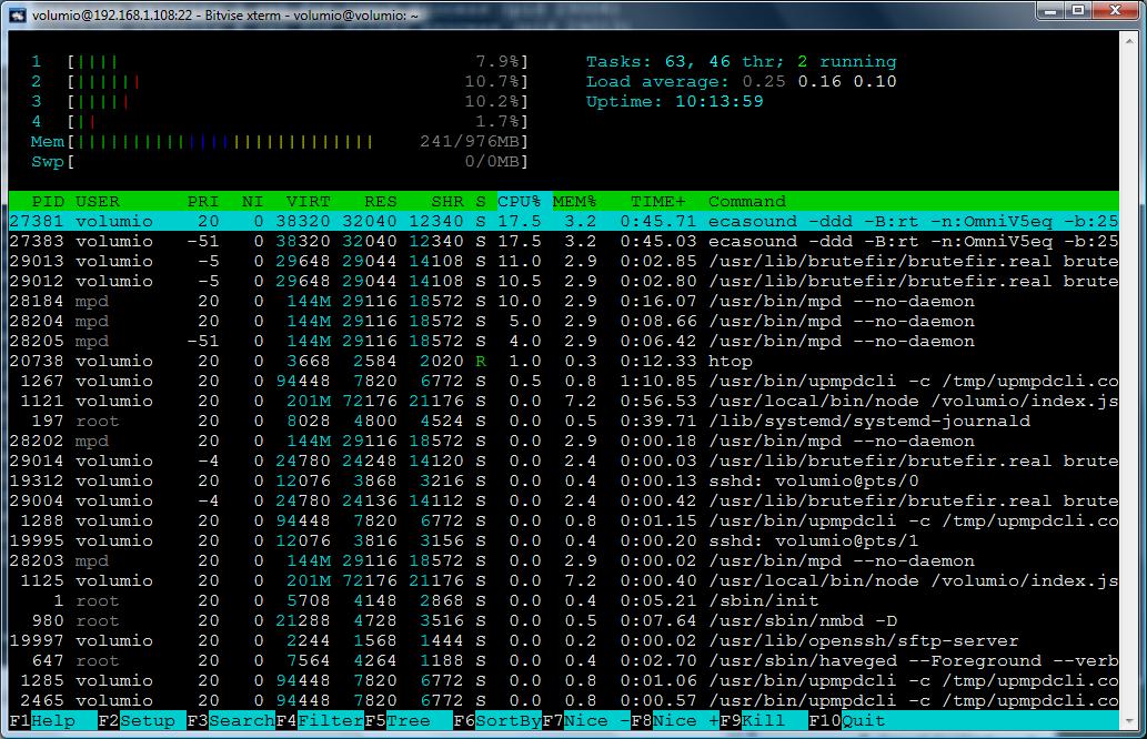

Starting software DSP.
I've been primarily using Volumio in stock form. I does everything I need out of the box (supports Piano2.1, connects to my NAS, supports web radio) and its headless and I like it.
However I would like to start adding some DSP processing. Primarily to EQ a speaker (ecasound ?) and to EQ the room (Brutefir ?).
The question is "can I wedge this stuff underneath Volumio". The problem is my Linux knowledge is very limited. Volumio's architecture Technical Overview * Volumio looks like it has mpd, alsa, and sox. So from what I've gleened on other threads its a starting point.

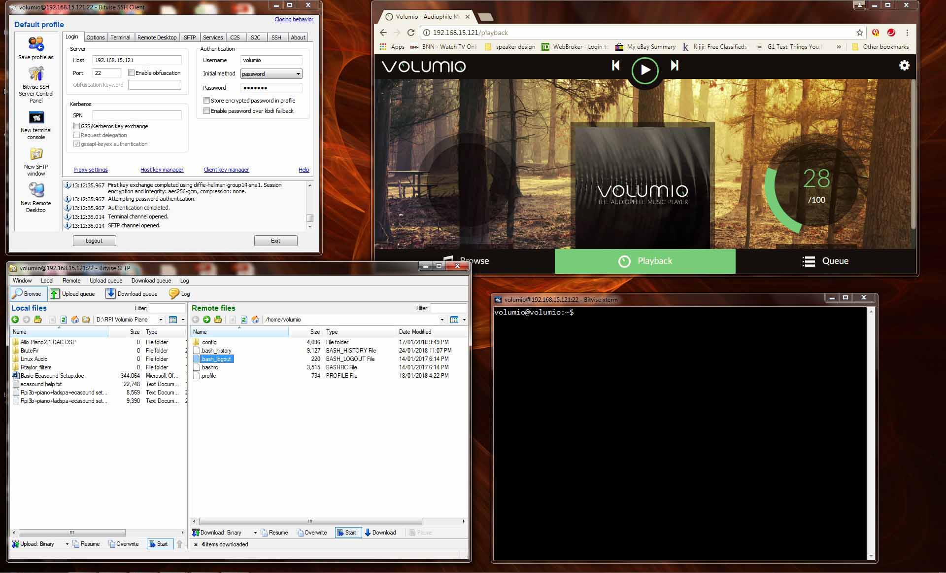

Remote access to the RPI
I'm going to list steps, as a way of "talking out loud" in order to get help when I stumble.
I need remote network access to the RPI to configure it and transfer files to it without having a keyboard and monitor attached.
It seems Volumio does not enable the SSH server by default. So...
Step#1 On the PC install the free SSH client (BitVise https://www.bitvise.com/) on RPI add an empty SSH file ("/Boot/ssh" ) to wake up the SSH server. Reboot.
Step#2 Lock the RPIs IP address on the router with DHCP reservation. I actually use a wired connection for this because its faster than the pi's wifi.
Step#3 Start BitVise and log into the RPI. It looks like the pic below, you get a Bitvise window, a RPI terminal window, SFTP file browser, and the Volumio page.

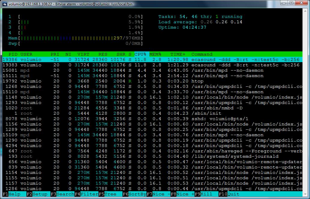

Step#2 Install "htop" to monitor cpu core use
"sudo apt-get update && sudo apt-get install htop"

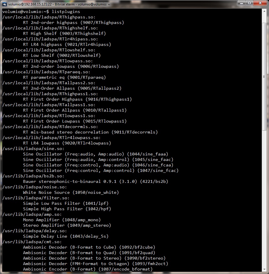

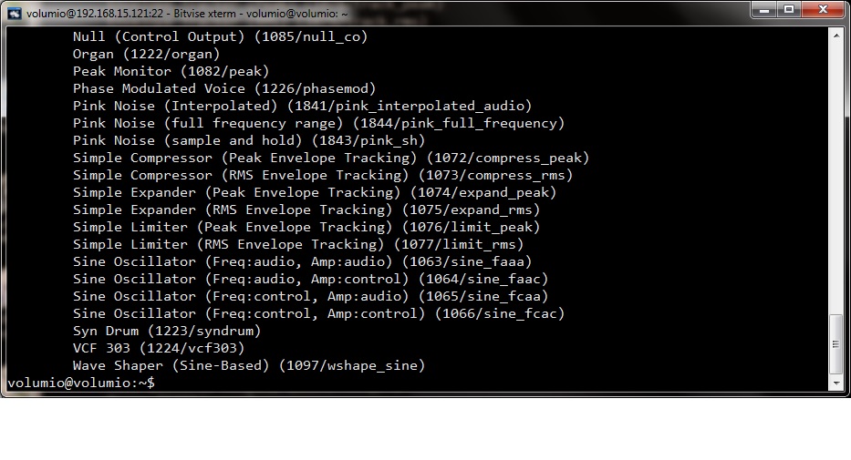

Step#4 Check to see what plugins you have, list the plugins. There should be approx 90 of them.
"listplugins"
Locating plugins + list
Forgot a step in the last post.
The system needs to find the plugins.
And for completeness the list of plugins from "listplugins".

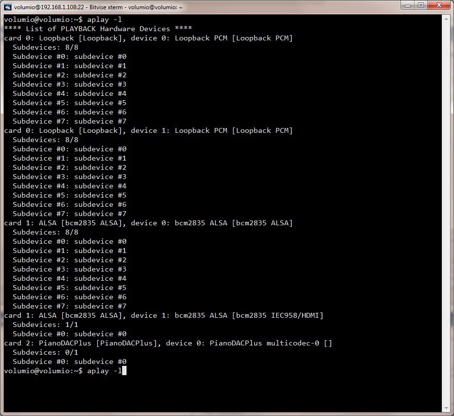

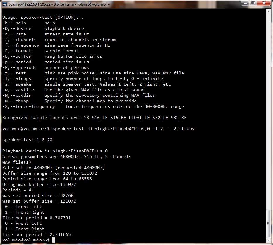

Checking the soundcard, ecasound, plugins
We should check if things are installed and working at this point.
To see how the Piano2.1 is named use the following. You should see a listing like pic#1.
To test the soundcard using a built in test file (says "right-left-right...") use the following. It has l=2 (2 loops) and c=2 (2 channel stereo) and use the test files (-t). Should look like pic#2.
To test ecasound is installed and working using some built in functions ecasound - manned.org . I've included a short sample file that can be placed at /home/volumio or you can use any wav for mp3 file. There are ton of options and this is stripped with only file input (-i
and alsa output (-o
. Should look like pic#3
To hear a difference, that processing is being done. This adds reverb 120ms, with amplification 150%
This adds reverb 120ms with a pitch shift down of 90%.
To test ecasound with a LADSPA plugin. I found this at Ecasound Examples and it produces a metronome. Use [ctrl][c] to stop it.

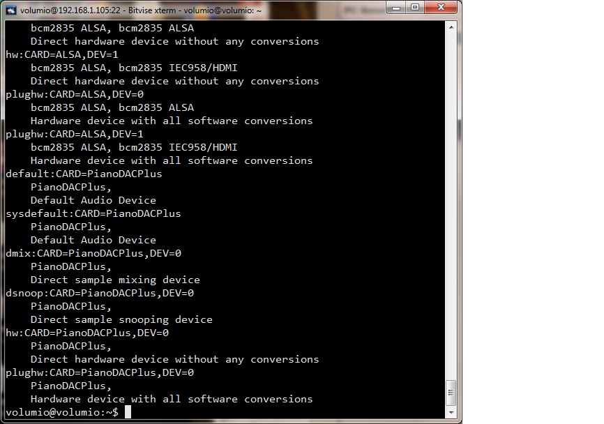

"aplay -L"
"speaker-test -D plughw
ianoDACPlus,0 -l 2 -c 2 -t wav"

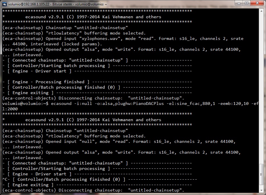

"ecasound -i:null -o:alsa,plughw
ianoDACPlus -el:sine_fcac,880,1 -eemb:120,10 -efl:2000"

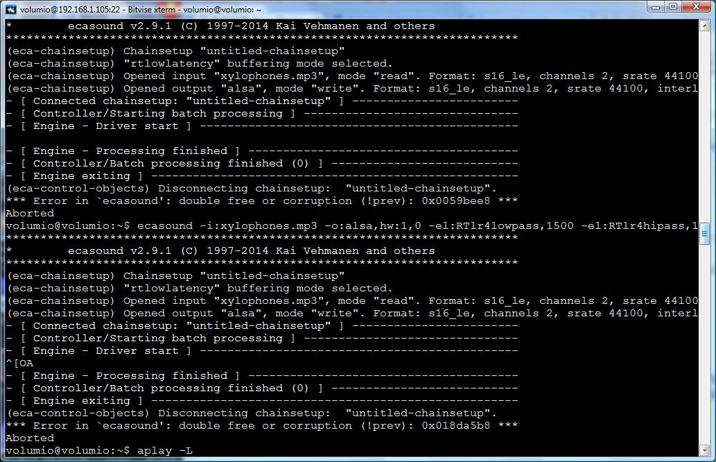

conflicts RT filters and sine.so causing "double free error"
I trying more of RT's filters, they worked but I was getting a "double free corruption" error (see pic). Its a known issue listed in RT's site Richard Taylor -- Thompson Rivers University and the solution is to remove sine.so
Then you can play something like this error free.
Code:
sudo -rm -f /usr/lib/ladspa/sine.so
Code:
"ecasound -i:xylophones.wav -eadb:3 -el:RTlr4lowpass,1500 -o:alsa,hw:PianoDACPlus

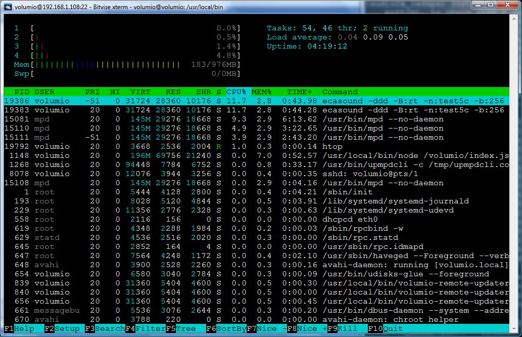

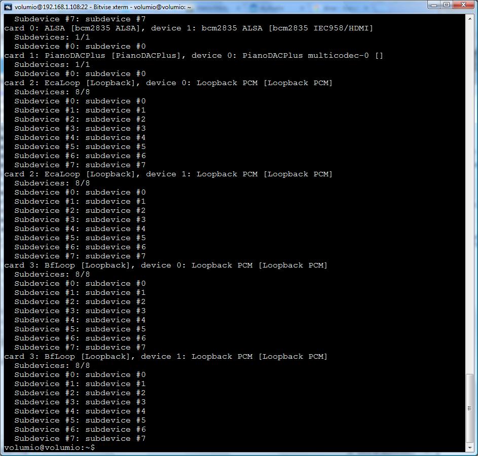

Adding loopback and ecasound script files
It seems that whenever you touch the Volumio Playback options, it will auto generate a new /etc/mpd.conf file. So anything placed in that file could be overwritten, so if you mod it, make a copy.
There are many threads like ecasound in MPD - problem of Device or resource busy and NEW: the Active Crossover Designer for ecasound/LADSPA (ACD-L) - Techtalk Speaker Building, Audio, Video Discussion Forum, most of these are sourced by Charlie Laub (CL), that recommend an ALSA loopback and that looks reasonable. The strategy being [MPD]->[Loopback]->[Ecasound]->PianoDAC.
In the edit (nano) file "/etc/modules" and add line "snd-aloop" and it should look like this. Then reboot Volumio, and you will have another sound card called "Loopback" that you can select in the Volumio Playback menu, or you can pick "Piano2.1" as before. However, the soundcard numbering has changed as shown in the pic below. It still plays as normal via the Piano2.1 at this stage.
My /etc/mpd.conf after reboot contains this. Notice the Piano2.1 is still selected but this time its soundcard#2 :
The ecasound files are getting more complex than a single line and you can put them in an executable file. These scripts exist at /usr/local/bin and must be executable (chmod 777 file). Ecasound's parser is picky, so I use windows Notepad++ editor to see all the spaces and hidden characters. A space in the wrong spot causes it to spew error messages, sometimes not related to source of the problem.
The following is a simple ecasound file. Its located at /usr/local/bin/ecatest4. It's a single chain called "test4", that bandwidth limits 20Hz-16Khz, and 3 parametric equalizers. From the command line "ecatest4" will run it and you'll hear the xylophones. It's easy to change the parameters to check that its working.

Connecting loopback ...... and we're stuck
I selected Loopback in Volumio playback options and checked the /etc/mpd.conf which looked what I expected. My Loopback is card#0, and Volumio takes device#0 as loopback input.
Then check the output of Volumio by capturing the loopback output with Volumio playback off, then on again. When playback is off I get a file of "nulls" , and when playback is on I get a file of random stuff. So The loopback appears to work.
Then I stopped Volumio playback, and tested access to the piano with this and it worked fine.
Then switched ecasound input to use the loopback output using this.
Turned on Volumio playback, started ecasound and "nothing" except an audio blip that hints of something being connected. Checked ecasound using interactive mode with debug option (-c -ddd) and there are no errors. Checked aio-status and the buffers seem to be working / moving / delay variations.
So I'm stumped (with limited Linux knowledge) and could use another set of eyes on this and some suggestions.
Code:
arecord -f S32_LE -c2 -r48000 -v -d 5 -D hw:0,1 check.wav

-el:RTlr4hipass,20 \
-el:RTlr4lowpass,16000 \
-el:RTparaeq,3,30,2.8 \
-el:RTparaeq,2,1000,2.8 \

I added some CPU loading snaps for webradio and mp3 over NAS. Lots of capacity left.

... adding more loopbacks
Now that ecasound is connected, I need another loopback. After much googling and reading.
The signal flow plan is [mpd] -> loopback -> [ecasound] -> loopback -> [brutefir] -> PianoDAC. The speaker is equalized using ecasound (done), then once the FR is flat, the phase (or room) is corrected using a rephase FIR filter with brutefir. I realize it can all be done in one step with the convolution engine, I just find it easier to separate the amplitude correction from the phase / room correction. It also lets me listen to incremental improvements.
It always seems that there are many places to do anything in Linux. I found that adding a line to /etc/modprobe.d/alsa-base.conf does the trick. You get the following soundcard list. I now have 2 loopback soundcards and I changed the index# to be after the physical soundcards.
Code:
options snd_aloop enable=1,1 index=2,3 id=EcaLoop,BfLoop

I have a working path [mpd]->loopback->[ecasound]->loopback->[brutefir]. Loopback#1 is selected via Volumio as playback device. I'm using web radio as a source.
I'm still messing with settings on Brutefir but using a known working FIR filter for phase correction. The filter is a mono 32b float, 16384 taps, at 48Khz using on both the right and left channels.
Ecasound now has 8 * para eqs + 1 * LR4 HP + 1 * LR4 LP running.
The RPI + Piano2.1 are in plastic box, cpu_temp=61C steady state. The CPU load is still reasonable, shown in the pic. There are also 4 Bitvise SSH +SFTP sessions running as I need 4 console windows to manually start and monitor at this stage.
