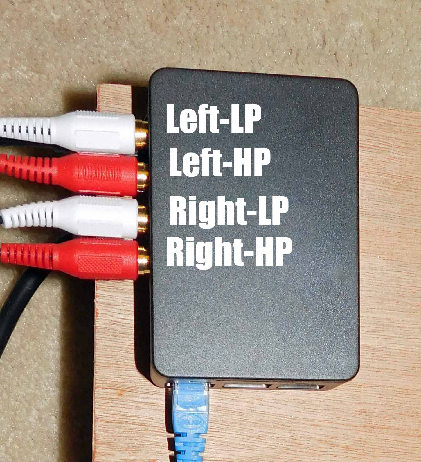

I used the stock Volumio (v2.457) and replaced its firmware directory (/lib/firmware/allo/piano/2.2) with one that provides left speaker on DAC#0 and right speaker on DAC#1 as shown in the pic below. The zip file with the new firmware is below, all sample freq are supported, but most of my testing was using 48KHz sampling. The rest of Volumio is functionally unaffected. Volumio hardcodes the filenames so I just reused them and Volumio will load them via its 2.2 mode configurations. This also carries the risk that Volumio may overwrite the 2.2 firmware so you need to check this after updates. This is the translation table to select the XO point you want using the existing Volumio 2.2 menus.

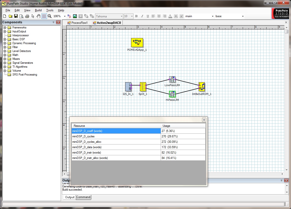

TI PurePath GDE was used to create the the filters and the configuration files for the DSPs. I provided a screenshot of the "schematic" and resources used for DAC#0 (left speaker). My preference would be to use the DAC DSP for static things like XO and the RPI be used for endless tinkering of EQ and room corrections. Ideally this would all be a Volumio plugin, but that would take more work, and require me to learn JS.
