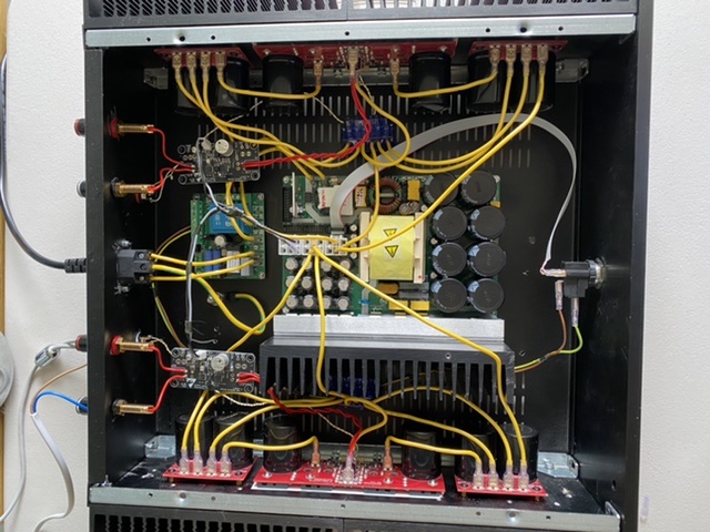

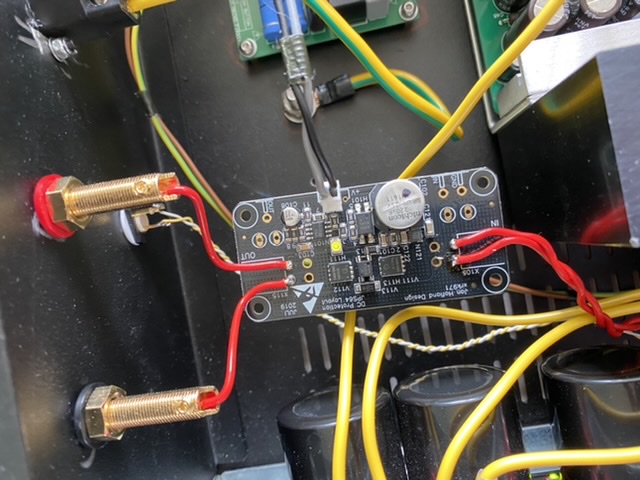

Great job xrk - many thanks. Finally my amplifier is complete! Safe to say this was the easiest part of the project. Bit of a learning curve for me as I’ve never built an amplifier before.

Nice work Stretch! What amp is that? Looks very compact and very high power. Make sure you put some insulator tape on back wide of the RTR SSR board if not mounted on standoffs.
:cheers:
Yep FirstOne Large amplifier with additional cap banks and 3KA400 power supply. The speaker wire is solid OCC copper, so the xrk SSR speaker protection modules are held very tightly floating in free air.
