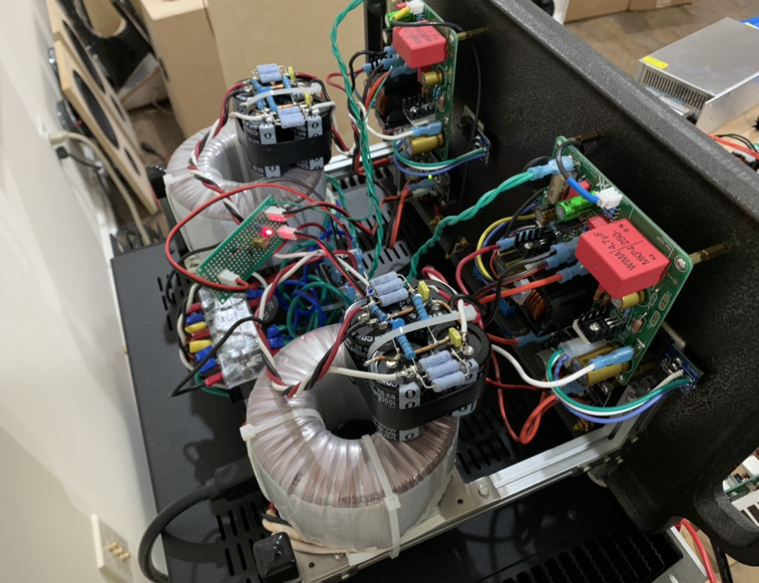

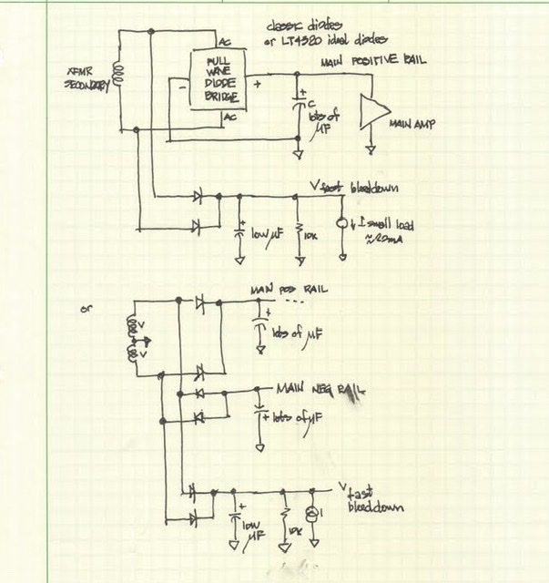

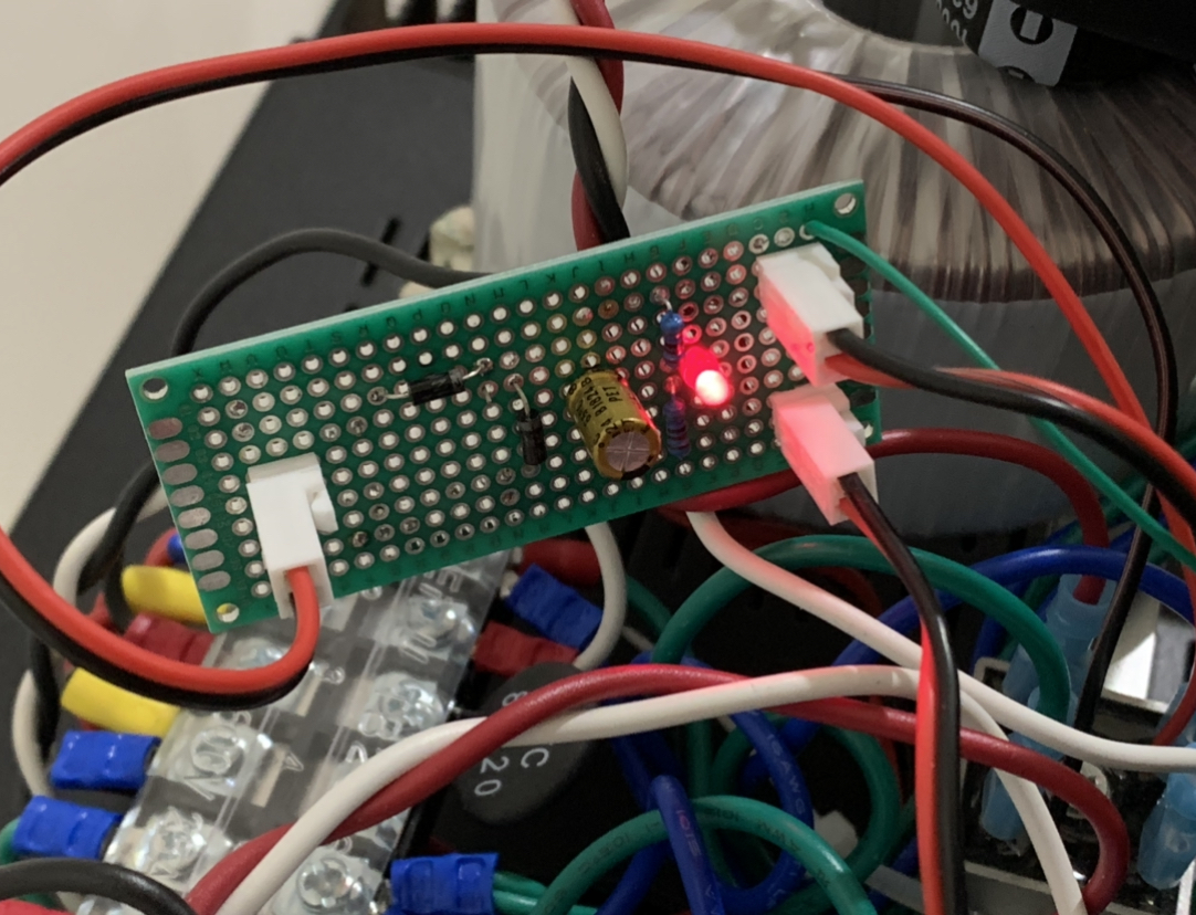

We have come up with a low cost and easy way to mod your RTR SSR to enable instant shutoff of the speaker connection to prevent turn off thump (or even could be used as a mute switch). The idea is simple - use a very low capacitance power supply so that when the main power switch is cut off, the power supply to the SSR is removed within a few cycles of mains 50/60Hz. We are using a half wave rectifier with a few 1N400x diodes connected to the amp power trafo secondaries. This feeds a circa 47uF capacitor with a 10k bleed resistor (I added a series LED to know when it is powered up). This supply has enough juice to power the SSRs which draw 20mA each. Here is a sketch of how to connect the low capacitance SSR PSU up (diagram courtesy jhofland). Make sure you connect the ground and AC input from the same trafo if using a dual monoblock setup.
So I tested it out and it works amazingly well. Literally, instant off on the sound when power switch is cut. Before it would take 10 seconds for the bulk rail caps to wind down and music would keep playing or in some amps, a turn off thump.
Diagram of how to connect the low capacitance PSU for the SSR:
attachment.php
Not much to this mod, maybe $1 worth of parts:
attachment.php
Installed on my FH9HVX:
attachment.php

I should mention that if you are running dual mono with two separate power transformers, make a separate low capacitance PSU board for each amp. That will avoid ground loops. I did as a quick test both SSRs powered from one side and luckily it works without hum. But I can’t guarantee that. It’s so cheap and easy to make there is no reason why not to make two separate ones.

In thinking about it more, I don’t think putting a low capacitance supply on board is such a great idea as it requires certain wiring and grounding considerations that the user needs to be very familiar with to work correctly. Not plug and play.
But anyone can build a half wave rectifier with a 22uF cap on a small vero board and try this out.
In effect, the low cap power supply with 2 diodes and a 22uF cap is an AC sense circuit as it is designed to cut off quickly - just the opposite of a real power supply meant to be stable and have reserves.
But an AC sense that trips the digital logic could be made as we have a digital enable already on the gen 2.

The reason I fear it is not easy is that it took me several tries to connect the compact PSU to the right ground location.

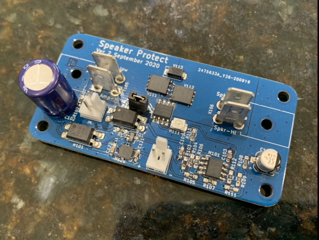

Prototype of Gen 2 RTR SSR
I just received a set of prototypes from Jhofland for the Gen 2. Features:
-150v MOSFETs so capable of handling almost any DIY amplifier power within reason (350w into 8ohms max)
-DC offset sense circuit isolated from speaker negative so bridged amps can be used
-remote enable via optically isolated open collector logic (bypass with jumper)
-remote enable can switch off instantly to prevent turn off thump using included (DIY) daughter board to generate quick shutoff signal from power transformer secondary
-same footprint as gen 1 board to allow upgrading.
