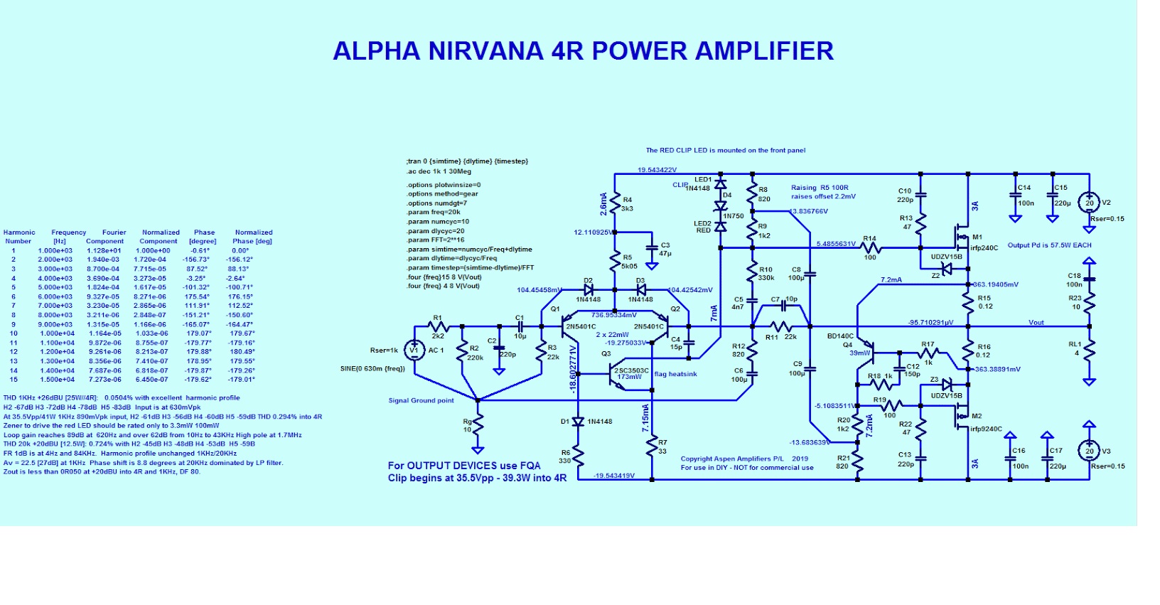

If R18 burns out it’s not because of oscillation but because of a bad or intermittent connection on your main pass BJT transistor. If you forget to connect the transistor Flying lead (or have a loose connection), the only path for the current is through R18. I burned one out when I once forgot to connect the flying leads Molex. Did you crimp the Molex connector properly? Try soldering the wires permanently to see if the problem goes away.

btw, I think it is R15 which blows if you don't have the transistor flying leads connected - at least, that's what happened the first time I fired up an SLB.

When you have a loose connection on the BJT the current passes through both R15 and R18, and either may burn out. Have you verified that you don’t have a cold solder joint on the board somewhere? The PCB has a large ground plane and being 2oz copper and 2mm thick FRP, requires at least a 60w iron and big fat chisel tip to fully liquify the solder. Cold solder joint might cause intermittent connection leading to random melt downs. That’s about all I can think might be the problem as no one else seems to be having these issues. What value are you using for R18?

I've just fired up my 'problematic' AN 4R board - after increasing C4 in the attached AN 4R schematic from 15pF to 22pF (Hugh's suggestion, to stop the 4R cct from oscillating).
And it worked!
I also then found that my suspect SSR board is working fine! Yay! So I don't need another SSR board!
