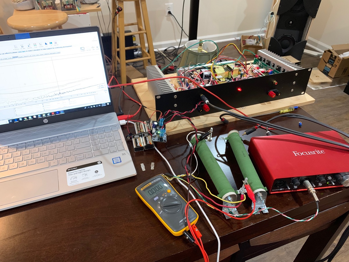

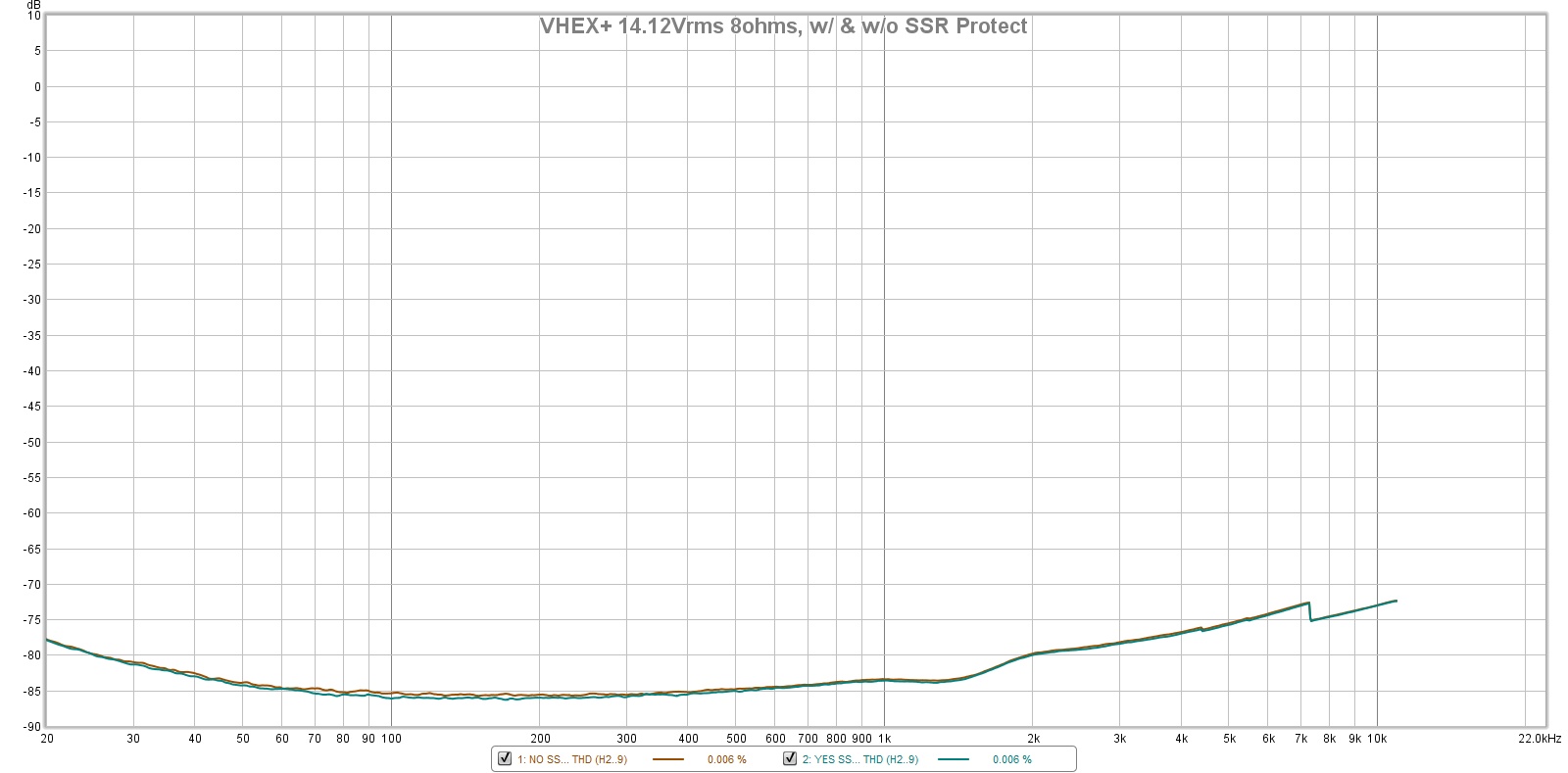

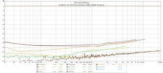

Dusting off my VHEX+ amp designed by Valery, I used it as perhaps one of my lowest distortion amp available to me at this time. The VHEX+ is powered by an Abletec +/-53v SMPS with a CRC filter for each channel. The VHEX+ is not considered an ultra-low distortion but I think quite representative of many amps in use by members in DIYA with specs here:
Here is a photo of the setup using a Focusrite 2i4 and a Fluke 101 for the Vrms measurement. The Focusrite is controlled by the REW software and provides the signal source as well to enable frequency sweeps.
The nominal condition for the test was 14.21Vrms (40.2Vpp) into 8ohms or 25w rms.

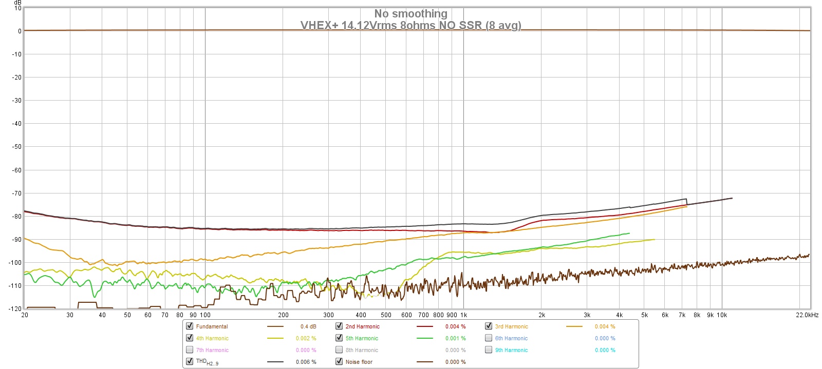

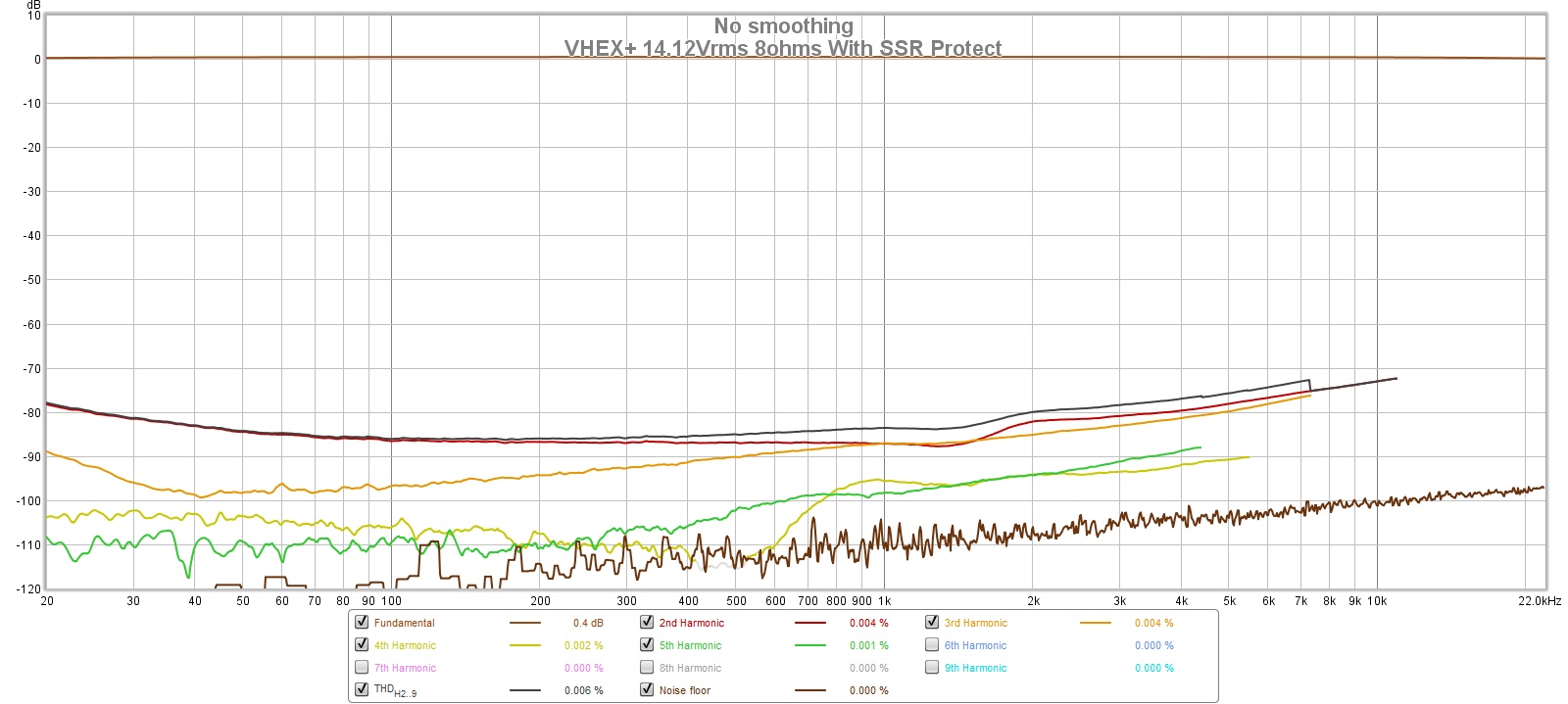

Here is the measured distortion components (H2, H3, H4, H5, THD) vs frequency for the case without the SSR Protection in place. These are 1M point data sets and an average of 8 sweeps was used:
Here is the measured distortion components vs frequency for the case WITH the SSR Protection in place, again 1M points and average of 8 sweeps:
Here is an overlay plot showing the THD of both cases:

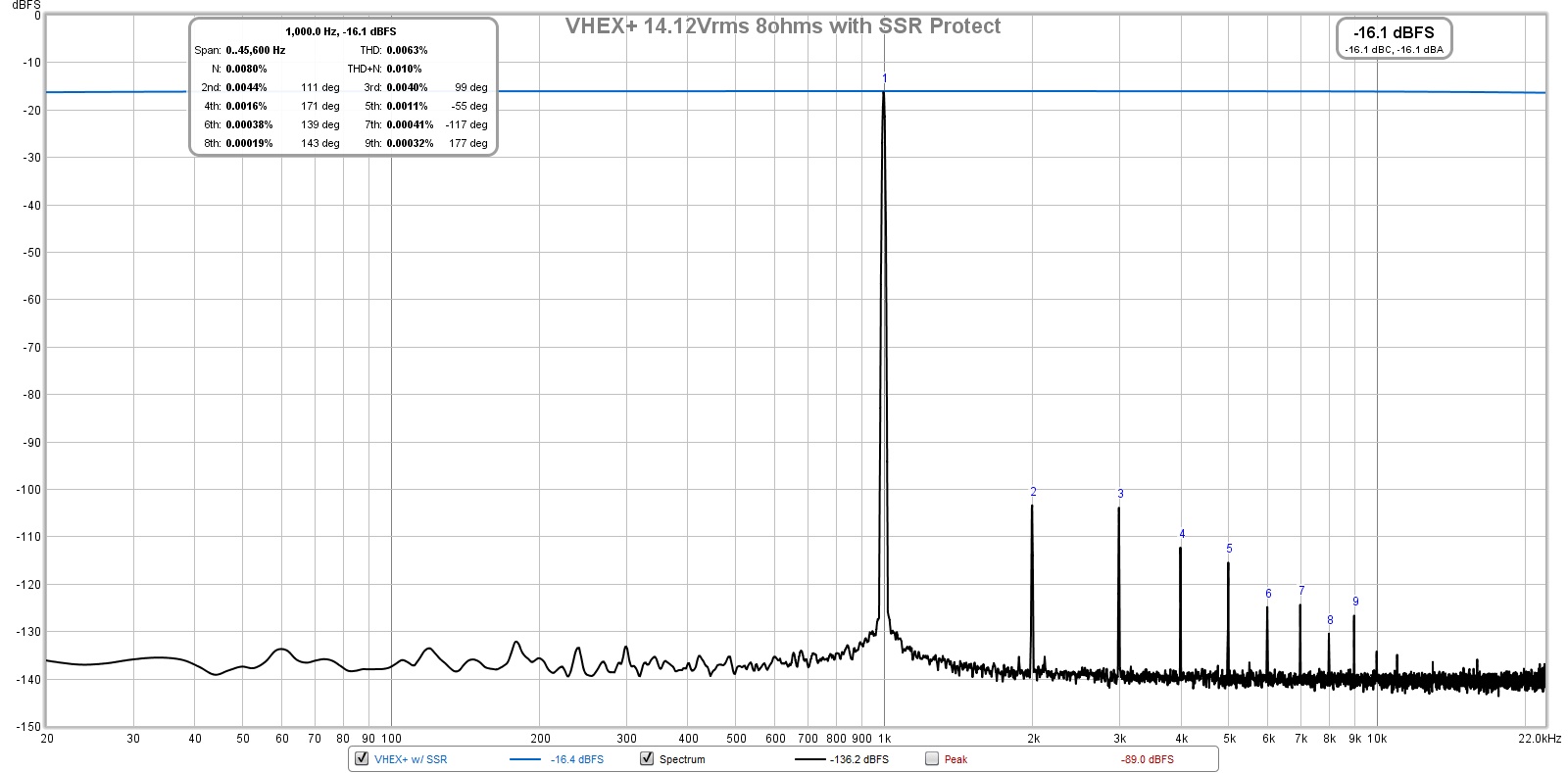

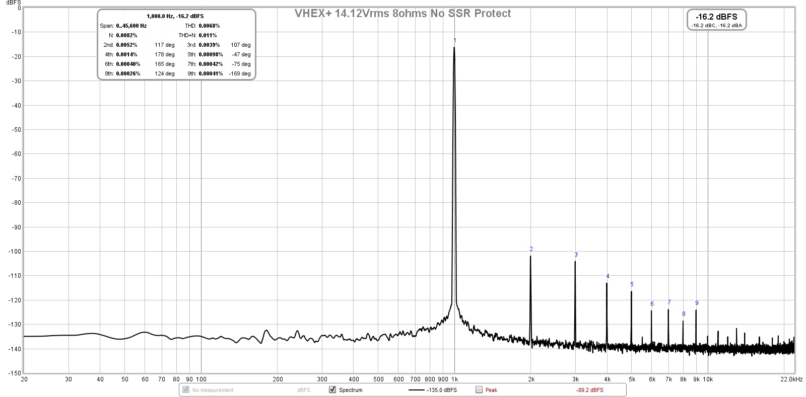

Here is a representative FFT for 1kHz excitation at 21.21 Vrms (40.2Vpp) into 8ohms for the case without the SSR Protection in place. Settings were 32k points, Blackman-Harris 7 window, 0.88 exponential averaging:
Here is a representtive FFT for the same WITH the SSR Protection in place:

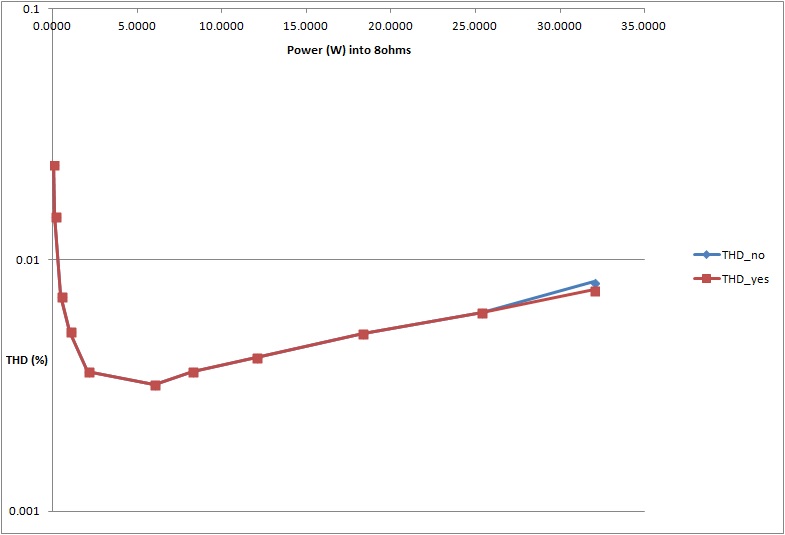

And finally, here is the THD vs the Power in watts delivered to an 8ohm dummy load over a range from 65mW to about 32w. The power was adjusted and I manually connected/disconnected the SRR Protection circuit and replaced connection with a double-ended male-male Faston spade connector. The power setting was untouched to ensure identical conditions:
At the highest power setting, the THD actually was a tad less with the SRR Protection in place. That is not a typo.
I won't add any editorial comments to the above data, and I feel they speak for themselves.
I agree that this is a representative sample of a low distortion (but not ultra-low distortion) amp similar to what many DIY Audio folks would have. Excellent!
I've seen that as well in some of my measurements. I suspect the MOSFET switches add a little extra capacitance, which shaves off a pico-bell of bandwidth, which lowers the harmonics. I have no hard science to back up this claim. It's just my handwaving explanation for why that might be.
