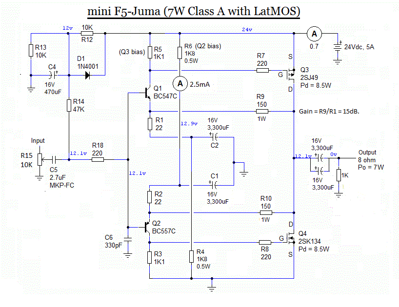

I have a quick question ; why do most amplifier have their VAS BJT or JFET tied together with a tie-wrap and some thermal paste...both BJT being at the same temp what does that do to the amp...is it to improve thermal stability or improve sound. I'm using some LatMOS so I think thermal stability is no issue because of their negative temp coefficient.
On my PCB, my 2 x BJT are a bit far but if I replace them and I leave the legs long enough I could manage to have them thermo coupled...the question remains...is it worthed ?

Are you referring to Q1 and Q2 in the circuit from post 187 (or post 8)? If so, then it makes no difference. Leaving them neatly soldered with short legs is probably better.
Tying two input transistors together as you can describe can offer a tiny advantage in some circuits. By keeping them at the same temperature, it avoids any small changes in DC offset that would be caused by differences in temperature between the two transistors.
Reasons not to worry about it:
a) We're talking about a very small change, maybe a couple of millivolts, which is insignificant.
b) The normal DC offset is likely to be much higher than that.
c) DC offset is going to change slightly with changes in ambient temperature anyway.
d) The output of this circuit is AC coupled, so the DC offset doesn't appear at the speaker.
Q1 & Q2 are input transistors.
The current flowing in each determines the output currents.
If the currents in each are identical and all the other resistances are identical then the output offset will be zero.
If the current in one input transistor drifts slightly way from it's complement then the output offset drifts.
If you can Thermally Couple the two input transistors so that each drift by the same amount, then the output offset is virtually zero over a range of temperatures.

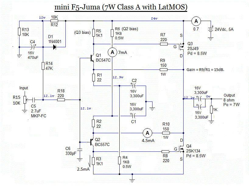

Hi Eric,
looking at the sch. (post #214) it seems to me that you misunderstood few things.
You wrote that the current through R6, R4 is 2.5mA but it's not. There is about 7mA flowing through R6, R4 (I=V/R=12.9 V / 1800 Ω)
Those 7mA branches on R9, R10 (about 4.5mA) and the rest (about 2.5mA) goes through Q1, Q2, R3, R5.

Thanks Juma,
You had mentioned the 2.5mA at the beginning and I never understood where that value came from, now I know ;)
Is the attached schematic more realistic ?
