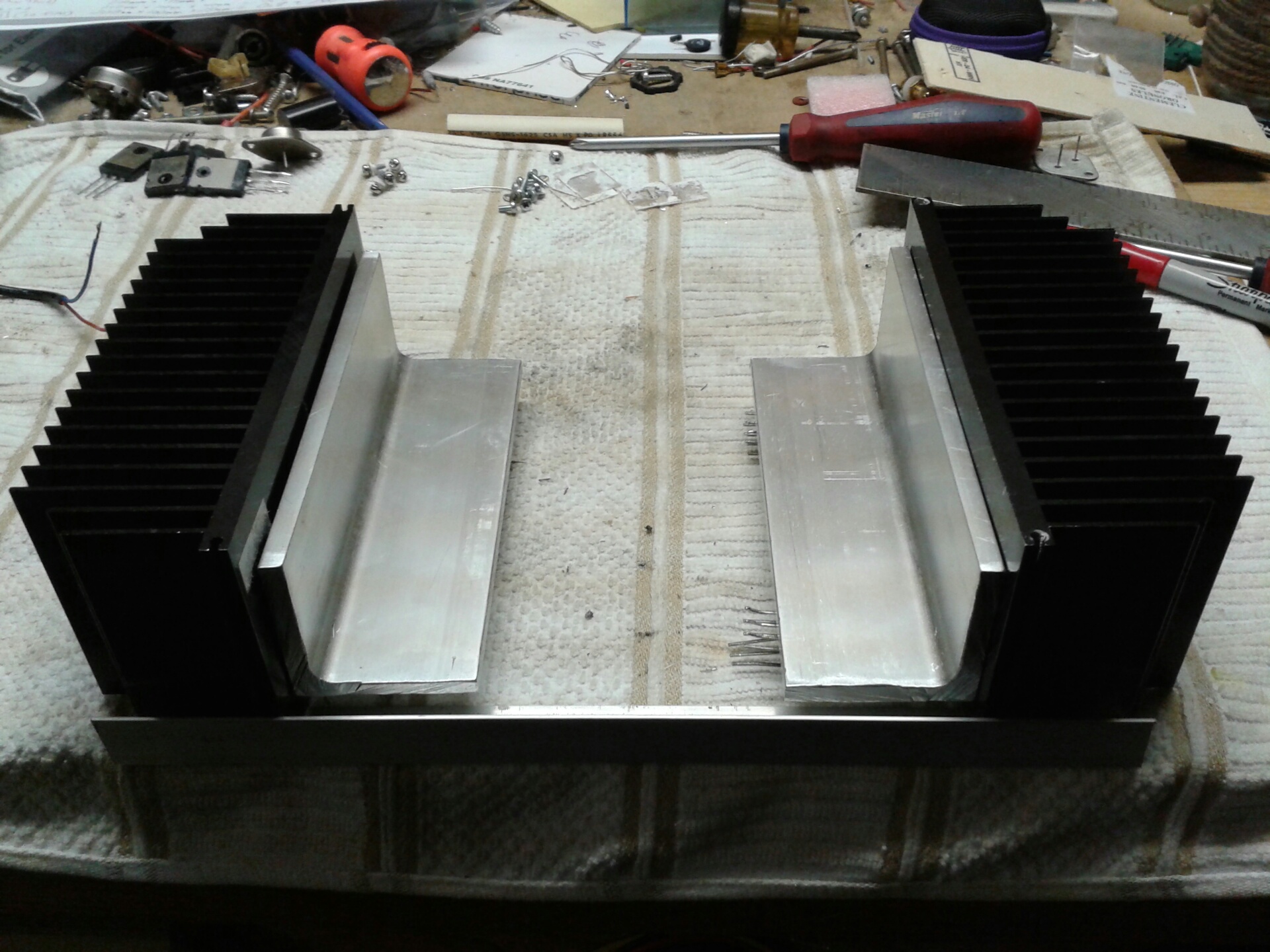

Well after using the amp. I now consider that 54C is slightly too hot for me, I ran some test and much prefer a heatsink around 40-43 C therefore I have invested in a pair of heatsink and some 2 inches right angle bracket. Each heatsink is rated 1 C/W therefore final temp should be around 42C..perfect for MY taste.
Here is a few pic of the work being done.

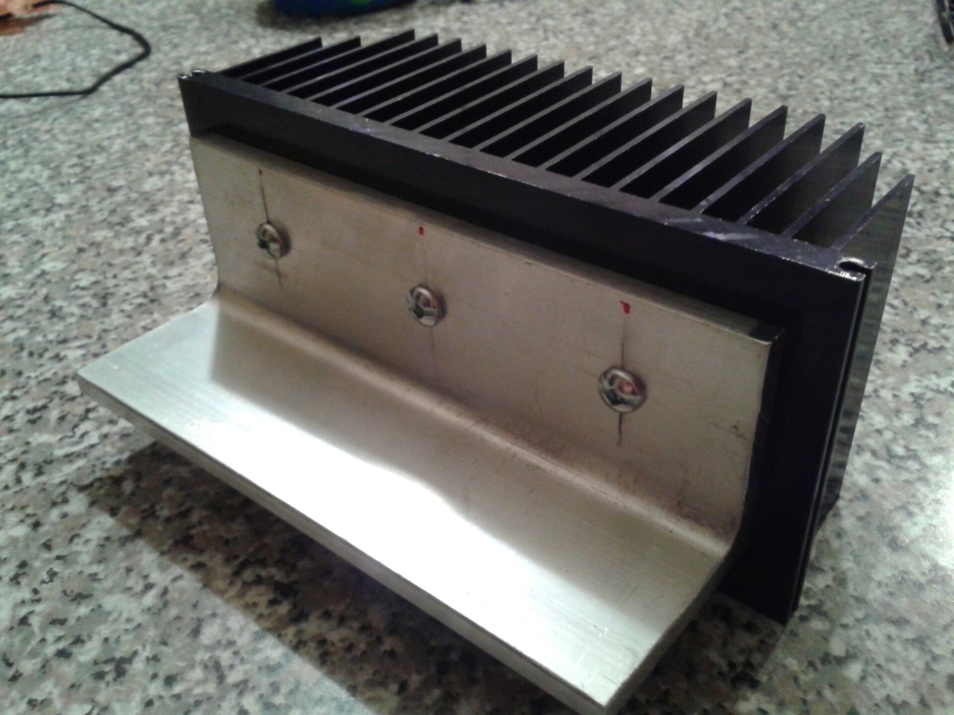

Nice thick angle bracket.Well after using the amp. I now consider that 54C is slightly too hot for me, I ran some test and much prefer a heatsink around 40-43 C therefore I have invested in a pair of heatsink and some 2 inches right angle bracket. Each heatsink is rated 1 C/W therefore final temp should be around 42C..perfect for MY taste.
Rgds,
Eric
Double (or more) the number of bolts to fix to heatsink.
Mount the devices as close to the heatsink as possible, even if it means sawing a bit off the outstanding leg.
All to maximise the heat flow to the sink backplate.
Indeed it's 6mm thick.
The heatsink is 150mm (6 inches), are you suggesting to put a bolt every inch ?
I have never used a L bracket so your comments are welcome.
Thanks,
Eric

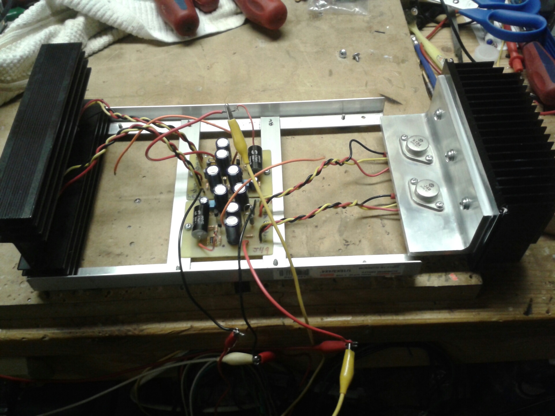

I now have the left channel as before and the right one is set with the new heatsink + L bracket. The left one is still at 54C and the right one is at 43C. This is perfect. The Mosfet + L bracket + heatsink are all about the same temperature, more or less 1-2 degree. I have used a thin coat of heatsink compound to remove the air between both surface and the L bracket is held by 3 screws (10-24) + lock washer. The heat transfer from the Mosfet to the heatsink via the L bracket is working great so it will stay as is.
I'm a happy guy, I'll try to work on the left channel tomorrow.

locate the extra bolts down near the knee.
Place them between the transistors so that you can get a big screw driver in through the gap to the head of the posidrive screw.
A bolt would be better since you can torque it up with a spanner.
Instead a much too long screw with a nut put on next to the head.
Then insert the screw until it bottoms and then tighten the nut with a spanner.
This is to try to get as good thermal contact along the edge where the L bracket is hottest.
You have the To3s fairly close to the knee. Any closer and they might ride up the radius of the extrusion and ruin the thermal coupling.
The To3s on the other side cannot ride up the radius, there is none, and the packages can be even closer.

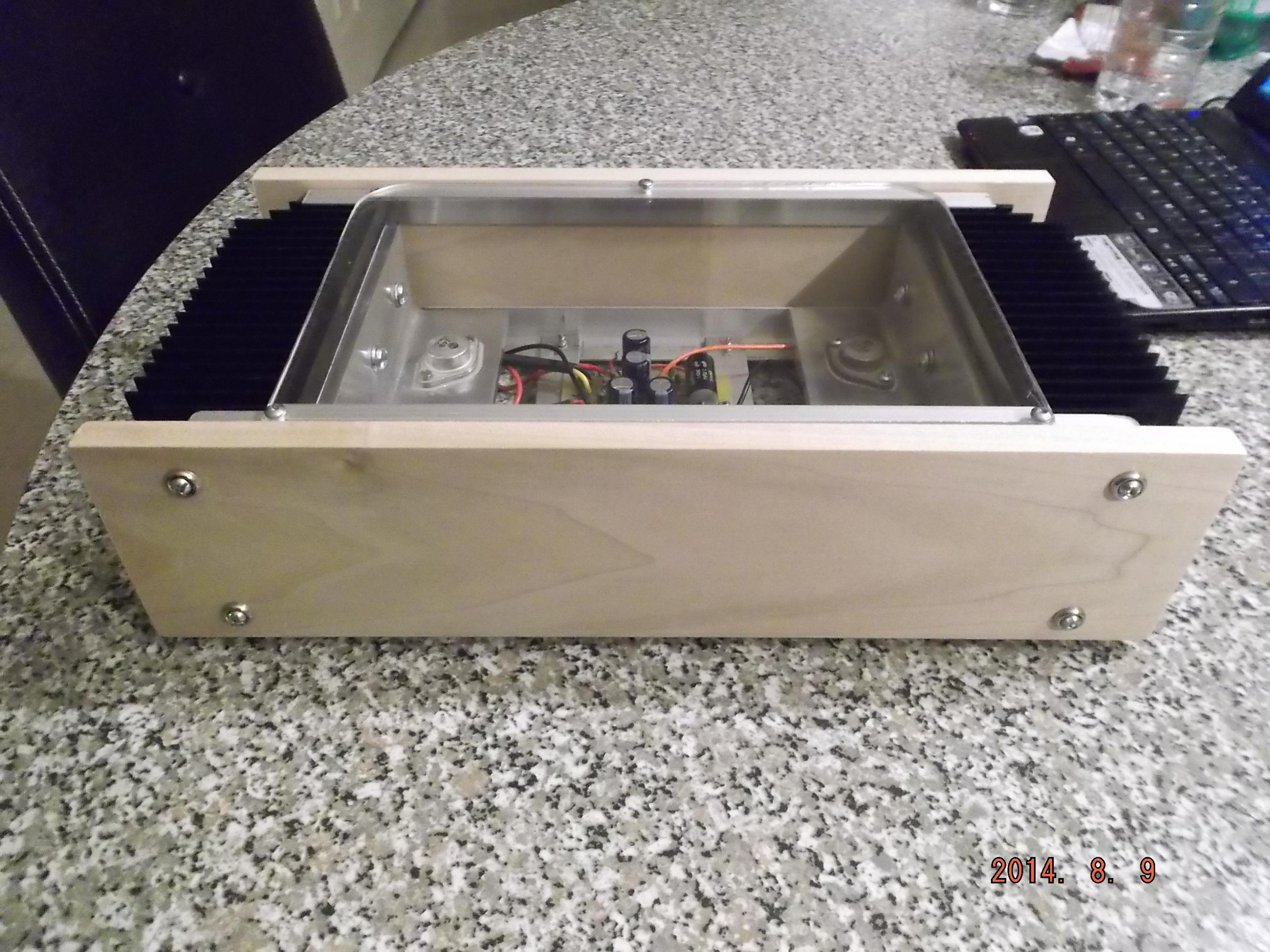

Well I made some progress over the past few days, both channels are in working order and I'm almost done with the enclosure.
I really enjoy the look of a metal and wood enclosure, this is what I did for this amp. Soon I will add the power switch, RCA, Spkr connector and the DC in connector, wiring everything and as a last step...I will have to varnish the wood. Only then I'll be able to enjoy a new great sounding amp.
Thanks Juma ! Hope your move is going smooth.
I will add a led on the front. I added a 6mm thick Plexiglas on top.
Overall size is 14'' W x 8'' D x 4'' H.
Here is a pic for fun.
BR,
Eric
