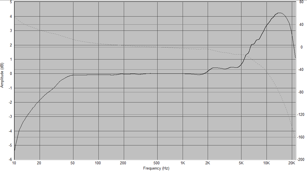

If it alleviates your concern... here is my UMIK-1 calibration file. Although the curve looks wild - please bear in mind the SPL axis:

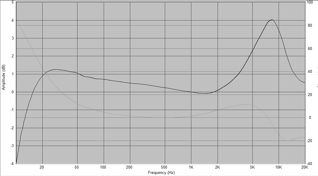

Here is my ECM8000 response (self calibrated) - which I did before I got the UMIK-1 and results compared nicely with the UMIK-1
Most of these capsule based mics, probably use the same capsule and have the same rising response above 2KHz.
Since measurement software like REW allows you to load the microphone calibration file and apply it automatically to each measurement, you get a "flat" response. What I am not guaranteeing is the accuracy of the supplied calibration files, but I believe they are good enough for our DIY efforts.
