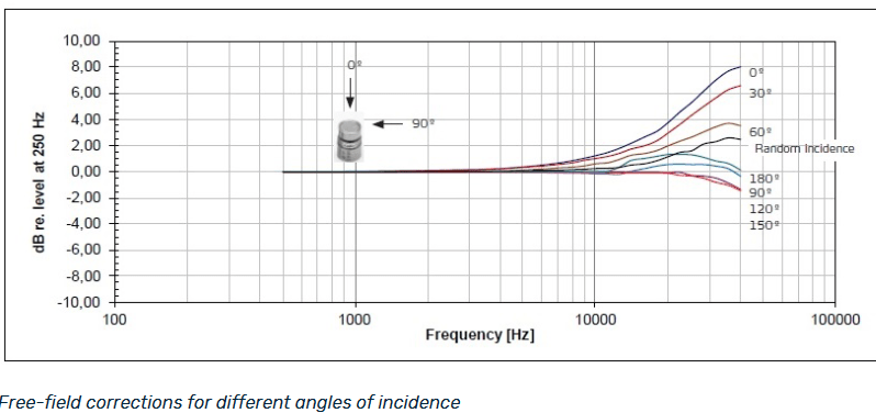

Something to consider: most of these small capsule mikes are very linear, due to their size. Even the ECM8000 is. The main consideration is: is the mike free field corrected or diffuse field corrected. The latter correction (found on the Beyerdynamic and the Behringer) leads to a rising response on-axis (we speaker designers need on axis response). Mind you, they all measure flat up to 4-5kHz, so for crossover design all these mikes mostly do fine.
The diffuse field correction can easily be corrected (sort of) by tilting the mike and measure on about 45 degrees. You keep deviations above about 10kHz, but these are small and certainly negligible for starters and occasional users.

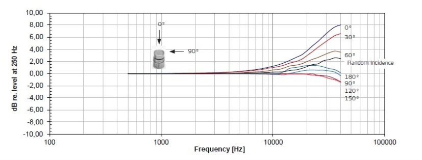

"The diffuse field correction can easily be corrected (sort of) by tilting the mike and measure on about 45 degrees. "
I think the standard is actually 90°. Ideally it should be specified in the datasheet, but that's too much to ask often...

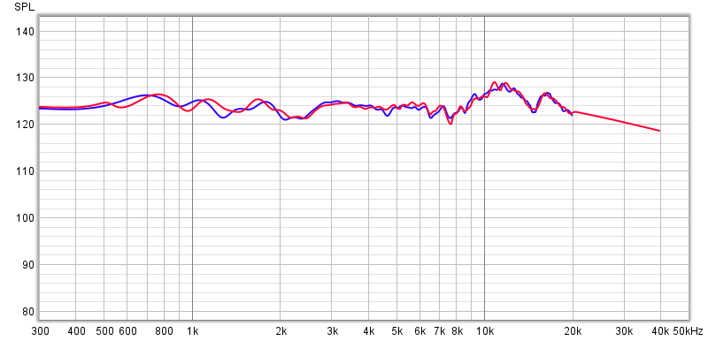

You can assume that most of the cheap mikes do have a rising response, but you don’t know how much. I have an ECM here that only deviates about 2dB at 15k free field. So if you don’t know what you have, don’t go for full diffuse field correction.
Mind you, in the above curve the deviation at 10kHz is about 1dB. A lot of people will not be able to tell the difference.
