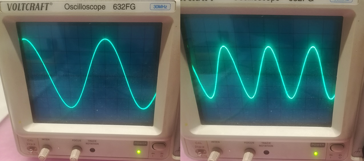

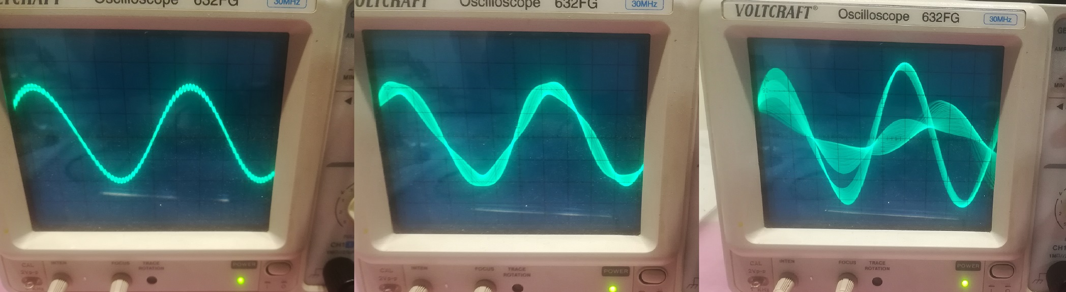

Why is at SOFT filter at firmware 1.19 frequency response rising till 20khz ? Is it deemphasis in script?
In comparisson i put pictures of 1khz, 10khz and 20khz SOFT sine wave and 10khz vs 20khz MINIMUM filter sine wave where we see normal falling response at that frequency.

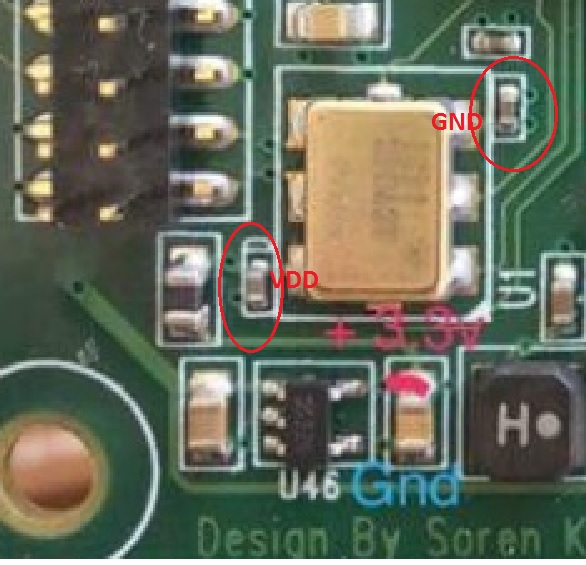

Any expalnation why Soren use on all designs smd decoupling caps also on GND pin?
So near VDD 3,3V on dam1021 uses 4,7uf smd and near gnd pin 0.1uf? Why 100nf so far away on the other side of clock?
Picture is from dam 1121 but similar as dam1021.
