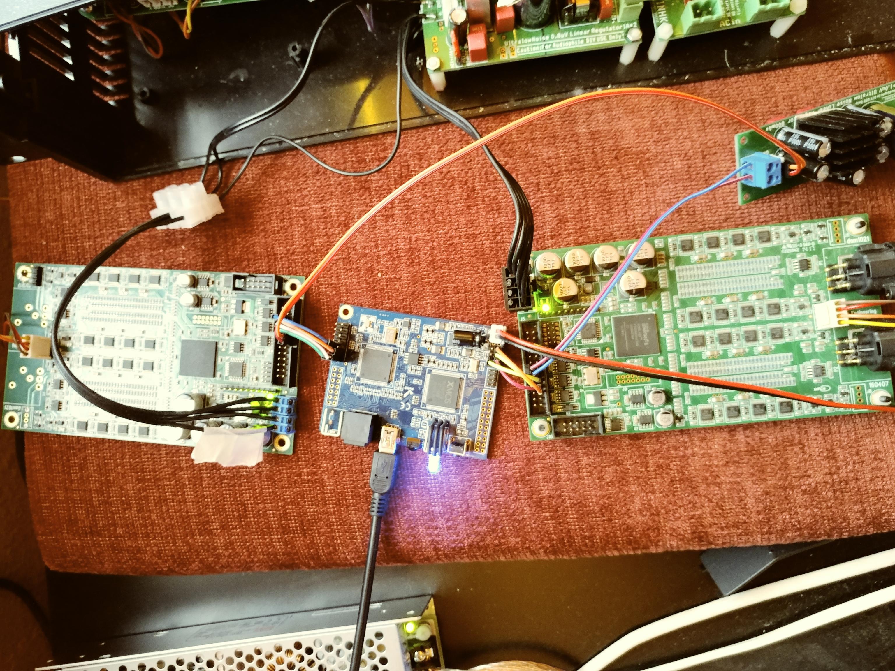

DSP and two DAM 1021
I have until now used one dam1021 followed by an electronic crossover. I have however been intrigued by trying two dam2021 with a Minidsp Nanosharc. It works flawlessly. I have not had time yet to check out the sound quality, but I have high expectations, also now having the option to easily play with different filter options.
