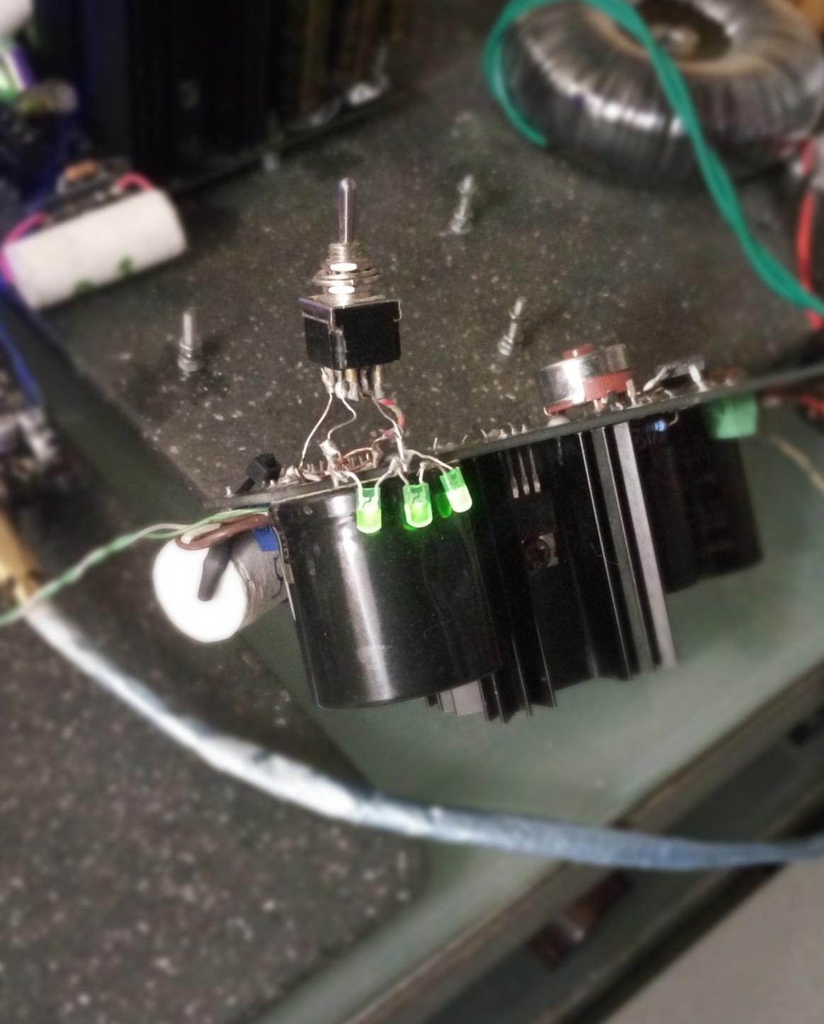

JOIMONF, can you also try to use the 4-pol just like a normal cap.
In+ shorted to Out+ and In- to Out-.
I also tried different ways and for me this was best.
Would like to hear your opinion.
It's just two bridges you have to solder in.
Hi jptz, very interesting, I placed a copper switch for quick test while music is on play, maybe frist test was dificult to hear, but then as much as I changed the toggle position, the differences become more and more audible, sure the system is warming up, but not only, also the brain need to settle. By now I am astounded how well it performs, that's great difference here bridged in and out. And for BEST! better timbre, coherent image projection, solid and detailed bass notes, punch battery, and so on. Is no way return. So exhilarating I can't prevent upload new pic, forgive me!

In such case why not just use regular 2 pin Mundorf 1000uf/100V which is smaller and cheaper ...
You still have one combination to compare however: Out (-) to ground. In (+) to transistors. LEDs between In(-) and Out (+).
So we agree! 🙂
Got the same idea and tried. To my surprise the 4-pole is better even if you connect it like a 2-pole.
Think the schematic on the right helps to find the best way how to connect C2.

I don't expect regular 2 pin performs the same, because of the internal constuction of 4 pin, anyway that comparison is worth a try, of course.
Concerning the combination, I remember having heard phase problems when wiring leds from one extreme of capacitor film to another.

Can you elaborate on the phase problem you met with 4 pin MLytic? What was exactly the problem?
I already posted -15th Feb ''... wiring leds from +IN to -OUT was.. how to tell... like reverse the phase on mains power supply. It's a loss on focusing, bass extension and overall coherence.''
And further elaborate -19th Feb ''...crossing leds this way from the begining to the end of capacitor film, seems great loss to me much more than IN to IN against OUT to OUT...''
But leds wiring, no concern anymore, now jptz great find at bridging IN to OUT, makes unsense to which pin were leds attached.
