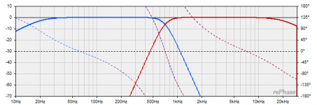

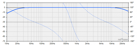

In general a difference is that for whatever real world minimum phase filters (IIR) we dial on amplitude response and then phase will always change with a certain pattern belonging to that amplitude and filters can be real time, for linear phase filters (FIR) we can choose dial only amplitude or dial only phase or a mix of both amplitude and phase and using the mix one can actual set a normal IIR filter using FIR tools, FIR filters have some more or less of time lag.

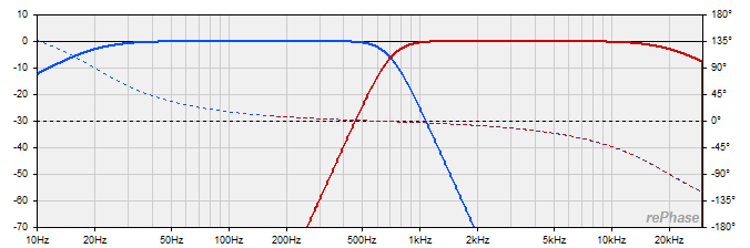

To understand domain of minimum phase see below how a 2nd order butterworth bandpass of 20Hz-20kHz amplitude would look like, phase change 90º per order so its a 180º turn down at zero Hz and exactly half way 90º at -3dB point for the 20Hz 2nd order slope, and same scheme is seen up at HF area for the 20kHz low pass slope, and for example the default flat amplitude and phase we see at start up Rephase is also of minimum phase its just that it has infinite bandwidth from DC (zero Hz) to lightspeed:
attachment.php

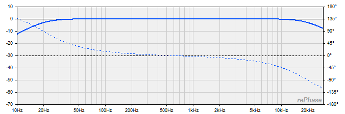

Same amplitude system band pass as above, but in its a sum of two transducers using IIR filtering in a 8th order Linkwitz Riley slope at 700Hz we end up add 720º of excess phase turn at 700Hz from that filter:
attachment.php

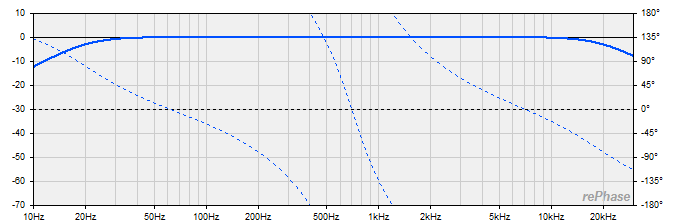

Same as above showing the two IIR band passes that sum to above system sum:
attachment.php

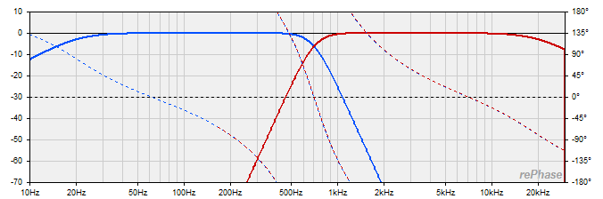

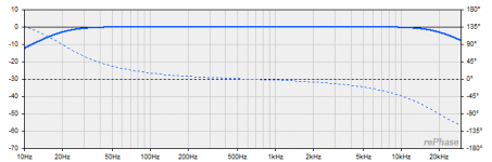

What Rephase is good at 🙂 same two band passes as above but now phase turn of XO point is linearized so total system phase and amplitude is same as in the very first example:
attachment.php

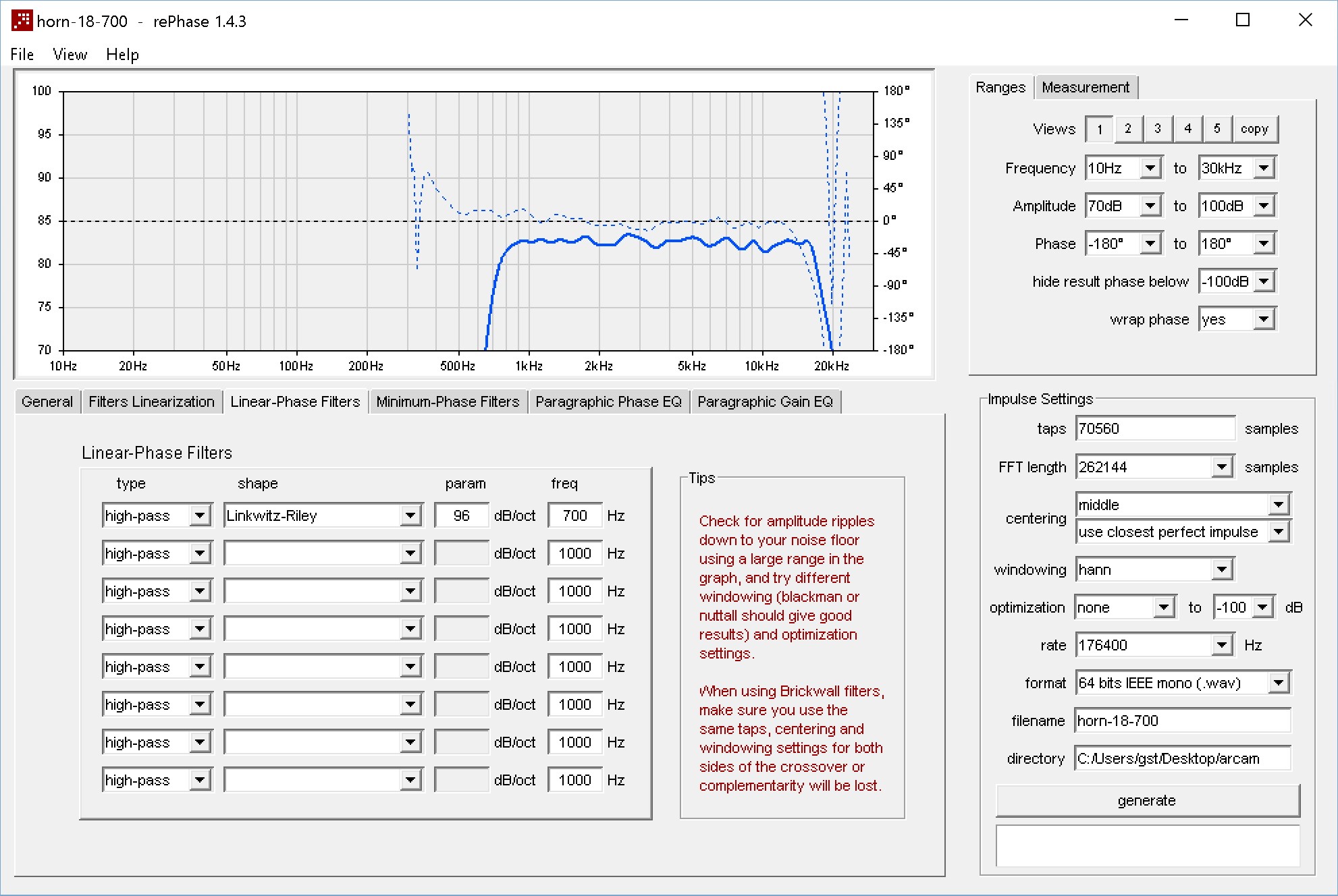

I wanted to ask about rephrase options. It allows to create minphase and linear phase filter slopes. Also, it allows to add phase corrections. Will there be any difference between 1) linear phase 24db LR filter and 2) minimum phase 24 db LR filter, created in rephrase, plus phase corrections. Assuming that we create filters using same amount of taps for both options. Both options are strictly fir-based with no iir involved.
I have a feeling that FIR-filters "oversharpens" to the sounds. It sounds like particular sounds have contours around them. Similar to what we see on oversharpenned photos from mobile phones. Similar but minimum-phase IIR-filters don't produce these artefacts.
Does anybody hear something similar?

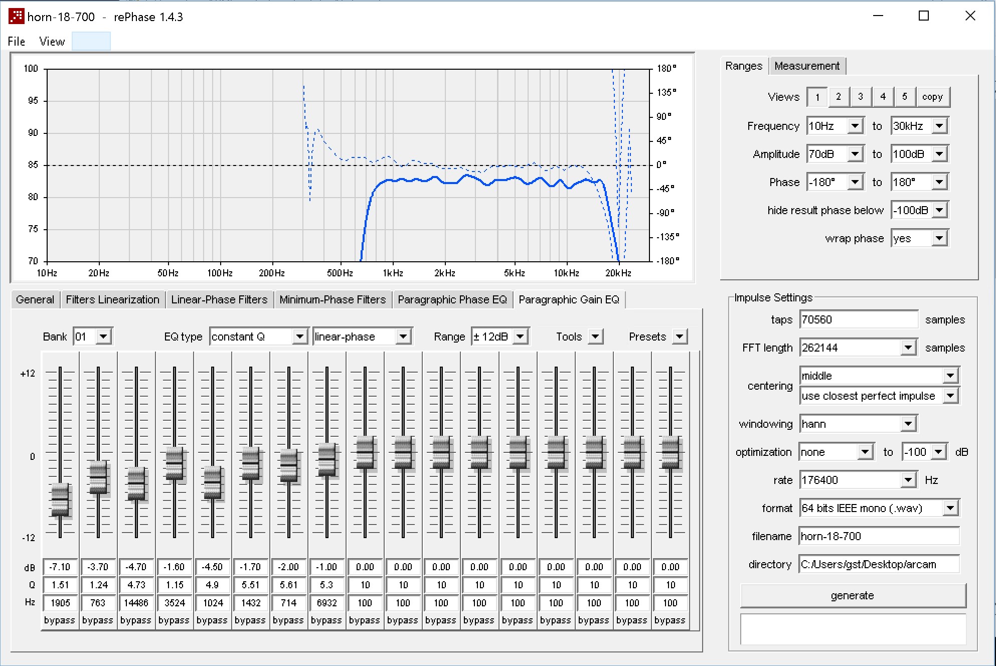

I use rePhase to generate FIR-filters. I suppose I may not be using it correctly. If it's only me hearing the issue, could you check my filter settings? I believe there may be something wrong with my configuration.

Try using rectangular window with exact centering.
That sounds the best for me.
I can’t tell you why (I am still a novice).
That metallic like sound I am familiar with.
Also I’m not sure you need that many taps????
(That I cant speak to but I don’t use more than 6144 because I can’t and can do just about anything I want)

I need that many taps because I'm processing sound with 176400 sampling rate. Actually, it's just 400ms filter. I don't feel it's long enough, because filter slopes at low frequencies aren't precise. Unfortunately, I cannot use longer filters, because the filters are used for home cinema and TV doesn't allow longer delays.
