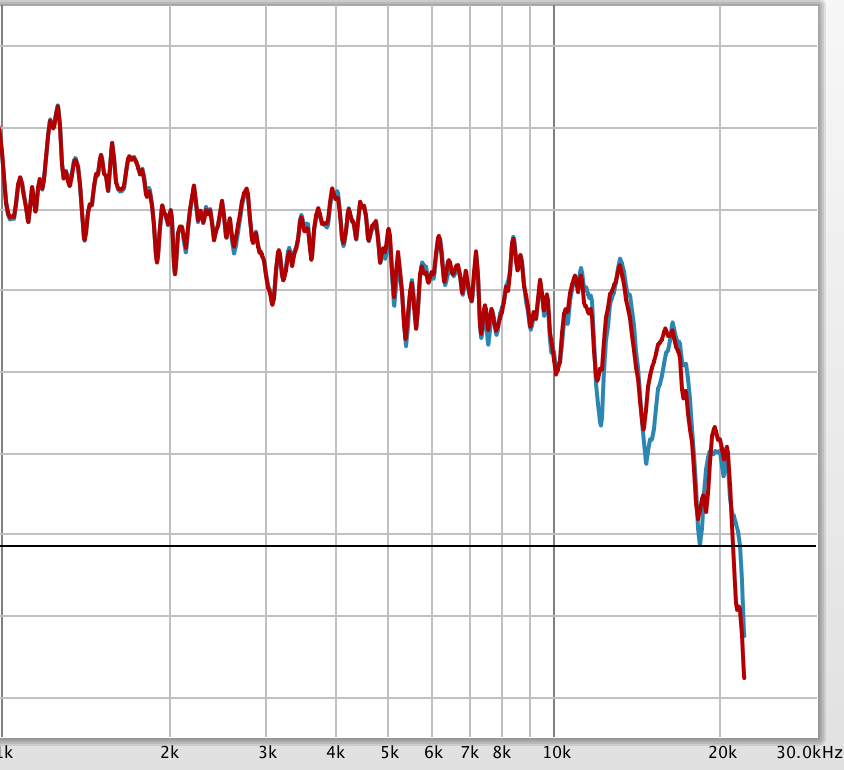

If you can take a screenshot of the differences in impulse timing it will be easier to help.
The time align function will usually get them within one sample delay, it is possible to get them closer but the difference only shows above 10Khz due to the wavelengths being so short. This shows the difference blue is REW alignment red is manual. 5dB per grey line. Not really anything to worry about.
