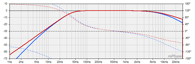

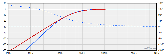

If you ask me one should never linearize phase for systems stopbands, they are natural because amplitude falls off then phase also starts it turning (90º per order) and so behave natural sounds in real world inviroment, you free to do it but it should not sound natural and more or less ruin original timing in music (harmonics line up).
So if you ask me only linearize that LR4@80Hz filter for your subwoofer but as we talked about in past remember also add stopband from subwoofer to HP section of your midbass bandpass and linearize for LR4@80Hz filter but not linerize that @45Hz natural system stopband of Q0,83 2nd order butterworth, difference for slope is not small seen in below where red is a clean linear phase filter HP LR4@80Hz and blue is the cascaded linear phase LR4@80Hz filter plus that @45Hz stopband minimum phase filter of Q0,83 2nd order butterworth : )
attachment.php
:) Hard thing if you ask me is get a system with a natural HP stopband of @45Hz Q0,83 2nd order butterworth to sound natural when inside a real room, it should maybe sound exelent outdoor or out in space but inside a real room response most often gets a huge bit hotter and ragged as in below example for raw room gain in red curve and blue is that red curve times a system having a HP stopband of @45Hz Q0,83 2nd order butterworth. In my experience blue curve below is really much too hot ragged and unnatural, can one get it smoother and high passed somewhere around 20Hz point then sound quality will improve to natural.
attachment.php

Hi Oabeieo,

Thank you BYRTT! That makes sense. So the closed box linearization, from what your saying maybe should be used with prudence, depending on the environment. Your room gain charts really help at a lot, and in a car the cabin gain is upwards of +25db at 38hz. So even more intense of a room.
The in room graph says a lot. And I do agree that using one linearization (weather it be the box linearization or the filter linearization) sound the best but wasn’t sure, the amount of room gain I think is screwing me up.
Thanks a ton :)

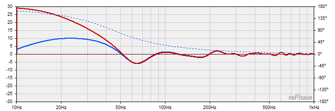

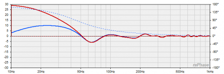

Here are my "initial" (after a few tries) results using REW's AutoEQ (cuts only, not boosts) and RePhase's "Filters Linearization" tabs. I had to estimate some XO's and then slightly change them to get the predicted phase plots to bend accordingly. I did not use the phase sliders, only the "Filters Linearization" tab.
These plots are of a stereo 3-way active XO to integrate stereo OB/dipole subs, bi-amp planar/ribbon speakers and to correct their passive internal mid/tweeter XO.
Constructive critique, criticism and suggestions is very much welcomed.
My main question is the left side (blue line) of the after Step Response. Is this downward dip before 0 expected/correct ???
Here is the before(green) and after(blue) frequency response with "cuts only".
Here is the before(diagonal/blue) and after(horizontal) phase correction for the left, right and combined channels.
Here is the before(green) and after(blue) Impulse Response.
Here is the before(green) and after(blue) Step Response.
Here is the before(green) and after(blue) Group Delay.
Here is the before(green) and after(blue) Impulse Response reflection peaks.

For main quistion will say that is normal and expected because when we manipulate some typical excess phase lag in time domain it has to be a pre operation view into impulse or step response graphs that would cost some overall processing systen lag to repair.
In general looks you have a good feel on stuff :)
As some general tip for where you are now say everything is really perfect based, then remember than any wish for other house curve adjustment or left verse right channel calibrations has to be global adjustments. What i mean is stay away any house curve adjustments per selective band pass unlesh you really happen find some errors there, because even small EQ changes per pass band will often or probably need a new time allignment setting and that operation can often be a big workload.

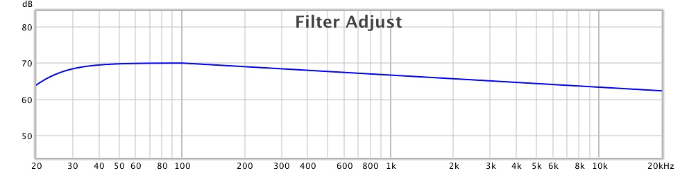

Are these in room averaged listening positions measurements like in SwissBears tutorial?
If so a flat room response will tend to be too bright. You could try adding in a room curve in REW to see how you like it. By using minimum phase EQ at that stage you should not upset the rest of the phase correction too much as you only used filters linearization,
Here is an example to start with
attachment.php

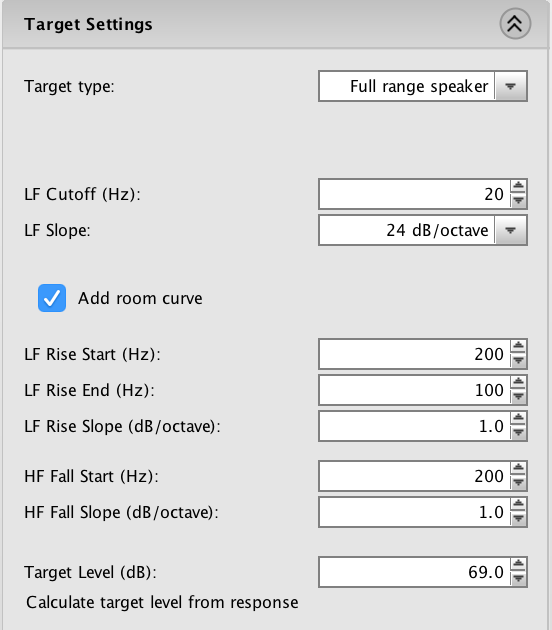

REW settings to get that curve, change the target level to suit your measurement
attachment.php
