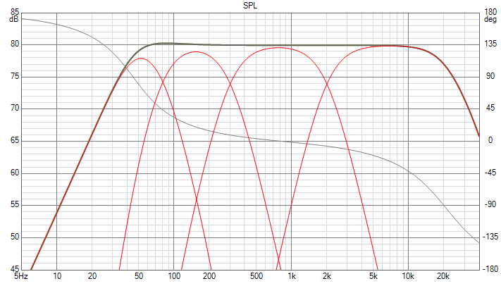

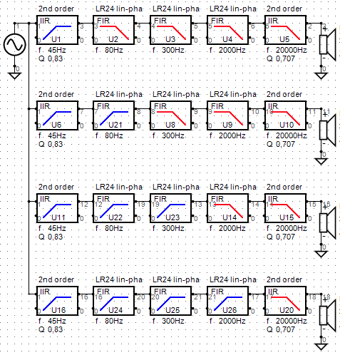

Hi Fluid,
It sounds quite good. I previously tried DRC Designer and would get good and bad sounding results most assuredly due to the pilot's ignorance use of the tool.
I have stereo OB/Dipole subs and 3-way planar/ribbon speakers (8 channels) and a stereo 3-way active XO (6 channels) and 2 passive unknown internal XOs.
There is an active known 40Hz XO between the sub and bass.
There is an active known 250Hz XO between the sub and (mid/tweet) combo.
There is a passive internal XO between the (mid/tweet) combo that the factory suggests is @ 3,000Hz, but doesn't elaborate on slopes. That is the unknown that I approximated by braille.
I currently have no way of adding delays with the current XOs. I am waiting on an 8 channel DAC and then I can time align the drivers. I will then need to know what to use in REW to gauge delays. I see REW has an "estimate IR delay" function, a "time align" function and a "IR align" function and need to learn the differences. I can also switch to linear XO's at that point.
If I get the 8 channel DAC and switch to linear XO's, there should be less phase issues to correct if I understand them correctly.
Not yet, I haven't moved the mic. I wanted to verify [before/after], [measured baseline/predicted results/measured results] without adding any additional variables into the equation while learning the software. It is hard to reliably repeat 9 different measurements at different X,Y,Z locations.
I have quite a bit of absorption and diffusion in the room and the current filters sound good at the sweet spot as well walking around the room.

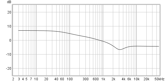

I personally prefer a flat "house curve". If my ears were 30 years younger, that maybe another story.

Those graphs look goodRemember to listen to the correction and see if you like it, I have made many graphs that look great and sound terrible.

As Byrrt said the change in the step response before the peak and the increased preringing in the impulse is the result of the phase manipulation. You have gone from 1700 degrees of phase turn to 360 degrees 20-20k so something has to give.
Are these in room averaged listening positions measurements like in SwissBears tutorial?
If so a flat room response will tend to be too bright. You could try adding in a room curve in REW to see how you like it.

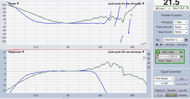

You would be better to use the acoustic timing reference in REW
This is a page from minidsp, explaining the use of it, just ignore the minidsp stuff that doesn't apply
Measuring Time Delay
If you use a linear phase crossover properly time aligned with drivers EQ'd flat either side there should be nothing to correct. You will still get the same wobble in the step and IR.If I get the 8 channel DAC and switch to linear XO's, there should be less phase issues to correct if I understand them correctly.
I would suggest making a version of the correction without the phase linearization (just bypass those parts in Rephase and generate another filter) but keeping the same EQ from REW and see if you can tell the difference between them and then whether you actually have a preference either way.
This is one area where the graph will look significantly better with the correction but the sound may not reflect what you are seeing. Or it might

The trace below shows the normal phase lag on one of my favorite sub designs, a push-push slot loaded double 18" reflex. Green raw. Blue processed obviously.

No box linearization for the Q0,83 @45Hz stopband only linerize subs LP filter : )
Here is a block diagram example of 4-way system where i used numbers for your sub because you told those numbers, the rest is for example. As we were around pages back to hinder destructive ripple calculate final target slope per transducer to be a cascade that includes the side band transducers slopes plus stopbands exactly as in block diagram. As you see stopbands are of minimum phase and not linearized so we end up a true system sum minimum phase curve as was it a single point wide band transducer 45Hz(Q0,83)-20kHz(Q0,707).
Curves for above block diagram, lows stopband will extend enormous into your car so find out that probably bit ragged curve and smooth it best you can, probably also you need set a highpass in 15-20Hz area to get it musical or use a linkwitz transform to transfer Q0,83 @45Hz up or down to whatever better stopband that blend smoother with the car cabin, all the room gain corrections should be global and of minimum phase.

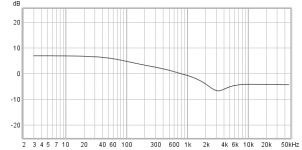

Hi Oabeieo now in reality principles are easier said than done, 2 way probably a okay workload but 3 or 4 ways are a big mouthfull of work in reality to get the acoustic right with tons of measurements and quality checks verse textbook targets.
Had below target curve laying around : ) and as far i remember its a car cabin target house curve, i hang it on below in a zip folder, but please research if its true use is for car cabin. House curves can be dialed in as a final act using global EQ, but can also be incorparated in per pass band target curves and a tip to create one is in Rephase set the string of all the cascaded filters and save as frd file and when imported in REW you now have a overlay target to live measurement sweeps and if you want to incorate the hanged on target curve to per passband target curve then go on "ALL SPL" tab "Controls" in REW and times to two curves each other (A x B).
Thanks again BYRTT,
Wow that target is almost identical to my Dirac live target that sounds the best in the car, I’m not not using Dirac live and have grown out of it, I can beat what it can do manually in the car with rephase in most aspects. (I could go on and on why I live Dirac but the things I didn’t like as few as they are were dealbreakers for me and I like the freedom over the impulse so I can break the rules as I wish)
That target is pretty much exactly what I’m using. Especially using horns in the car that play down to 1k that have a two axis flare that Dirac has a hard time resolving.
