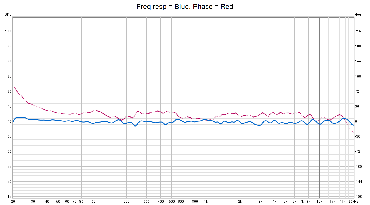

Now do off axisrePhase is a great tool. Love it.

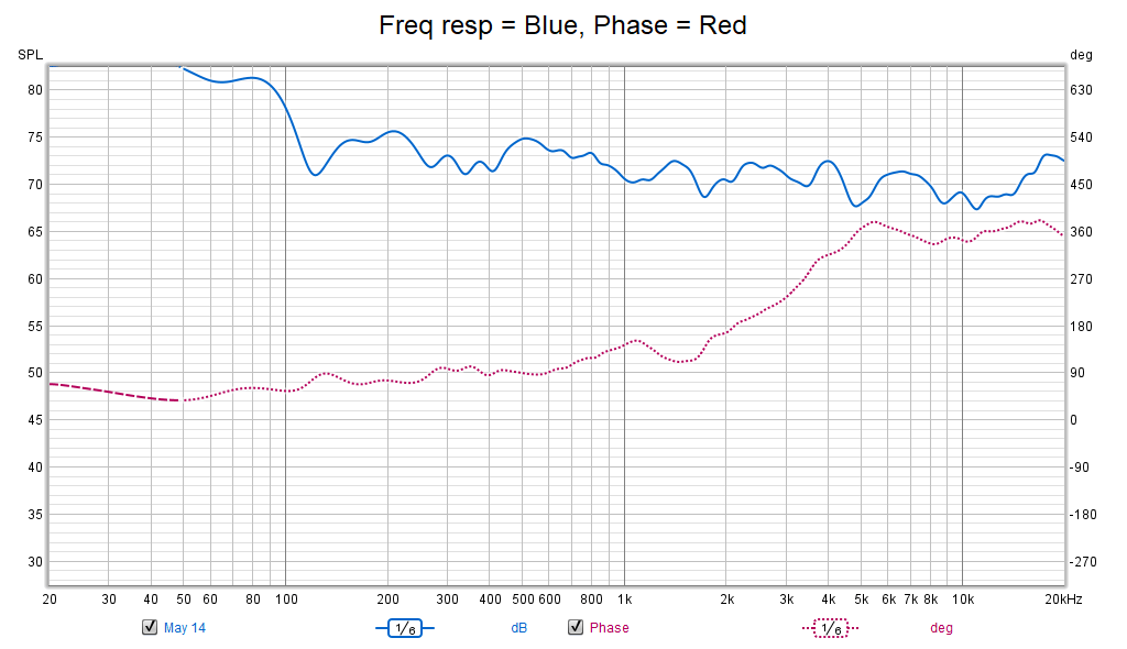

And by using it, I was able to get a result as good as this with my 5-way system and a MiniDSP Flex. Can you spot the four XO points? (I guess not...)
45 degrees off-axis. Bass is exaggerated because the mic is closer to the front subwoofer array. And the phase shifts at higher frequencies because the mic will be farther away from the mid and tweeter. The speaker system is a Magnepan 3.7 with the tweeter on the outside. There is also two Magnepan 1.6 acting as bass panels.
So here is a video I made on a tune I quickly put together for a video
So it wasn’t refined at all so keep that in mind…
My objective with this video is to show how easy it is to get a fantastic correction in RePhase , but most importantly using a dual channel fft analyzer for measurements…

In my video I demonstrate that the data in smaart is exact… easily to capture , and the results are fantastic and sound great!
With smaart I do believe it puts RePhase at the very top of Fir convolution programs as it’s not automated which we all know leads to errors
I understand why pos won’t go automated now… this is so much better…. It’s dead on balls accurate and the video shows it’s accuracy…

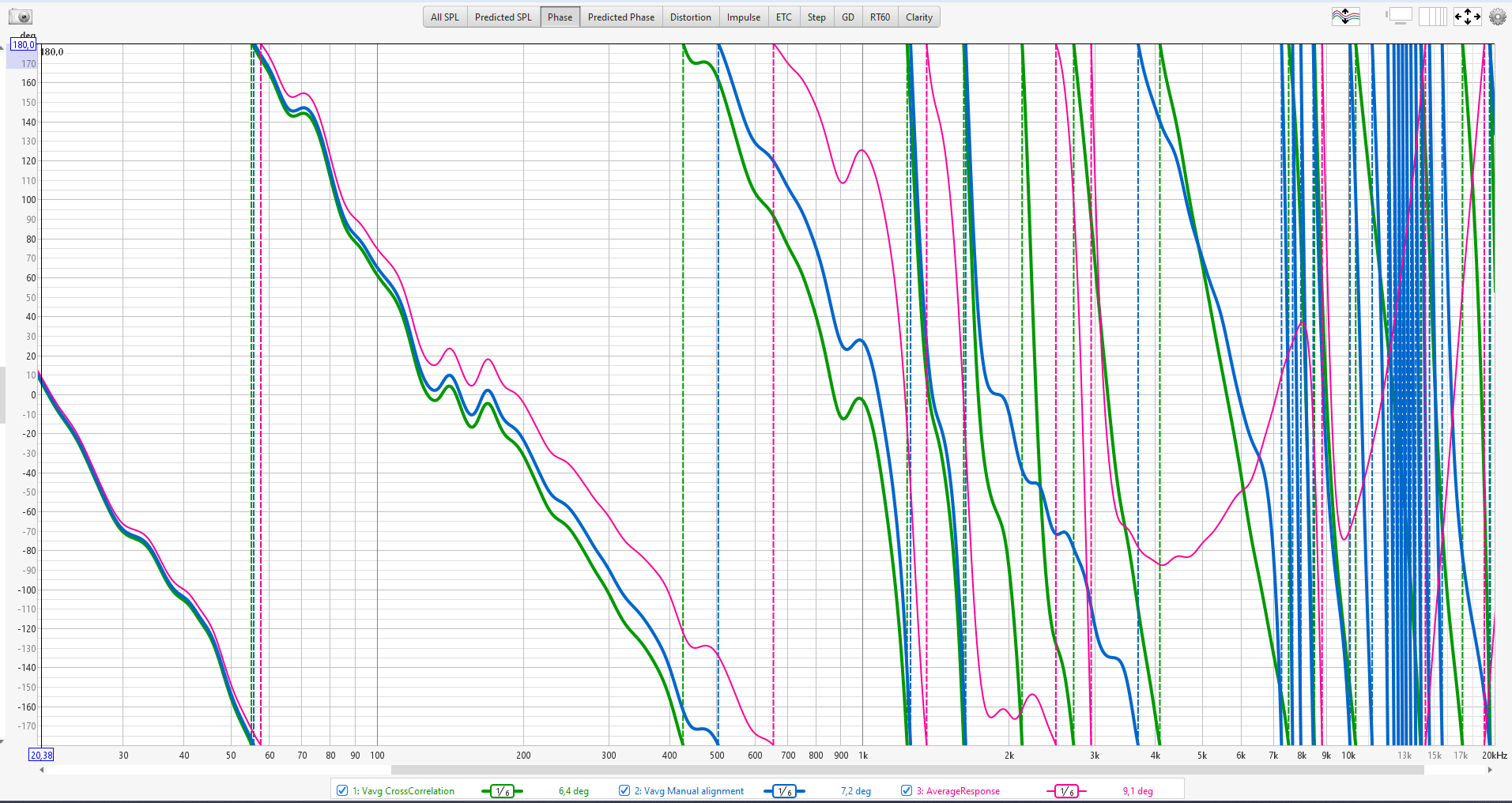

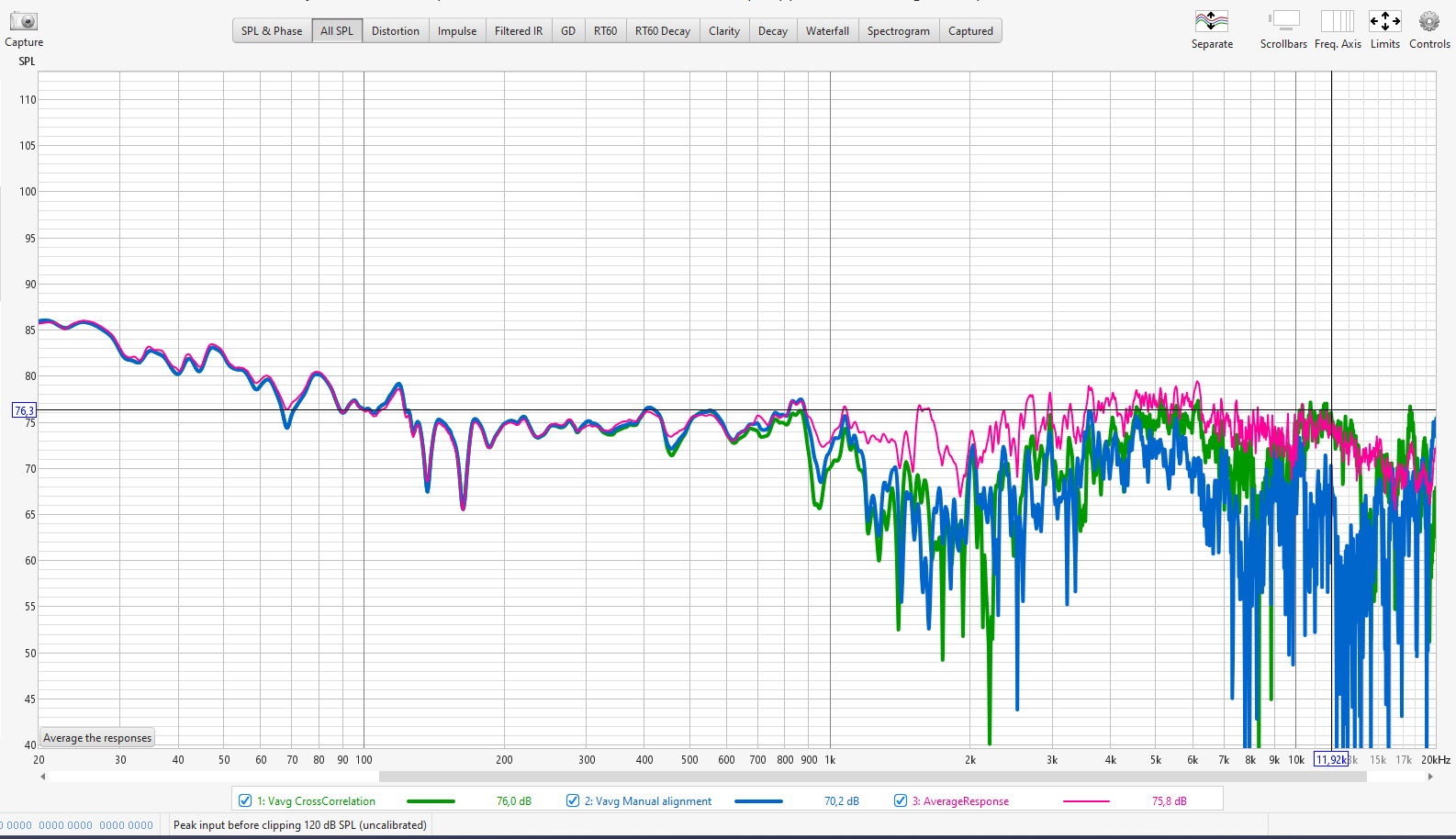

Does this automate the process of manual alignment of the impulse responses of different measurements?It means that REW will compare the impulse responses of the individual measurements and adjust them so that they all line up as well as possible with the first measurement in the set chosen. They can then be vector averaged with good results. It is a little like an automated form of the manual delay finder tweaking you mentioned in your video.
If yes, it's not doing what Smaart or Eclipse Software Averager is doing with the power/complex averages.
Blue is with CrossCorrelation, Green with manual alignment of impulse responses and red imported from Averager. I only had a trial of Smaart, but from what i remember the power average from Smaart was within +-1dB of the Averager program.
![1684996669711.png 1684996669711.png](https://www.diyaudio.com/community/data/attachments/1085/1085322-8f9a23a129192061c44142c23f1d9a35.jpg)
Phase averages are different, too.
![1684996786509.png 1684996786509.png](https://www.diyaudio.com/community/data/attachments/1085/1085323-74950ac4ce313795b5449bf4277f9e35.jpg)
So for Oabeio i would still recommend to do the averages in Smaart as they better align with what's actually happening in a car.
