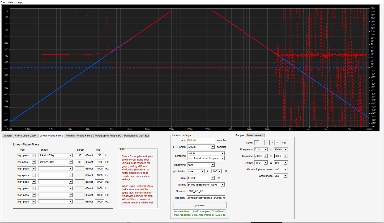

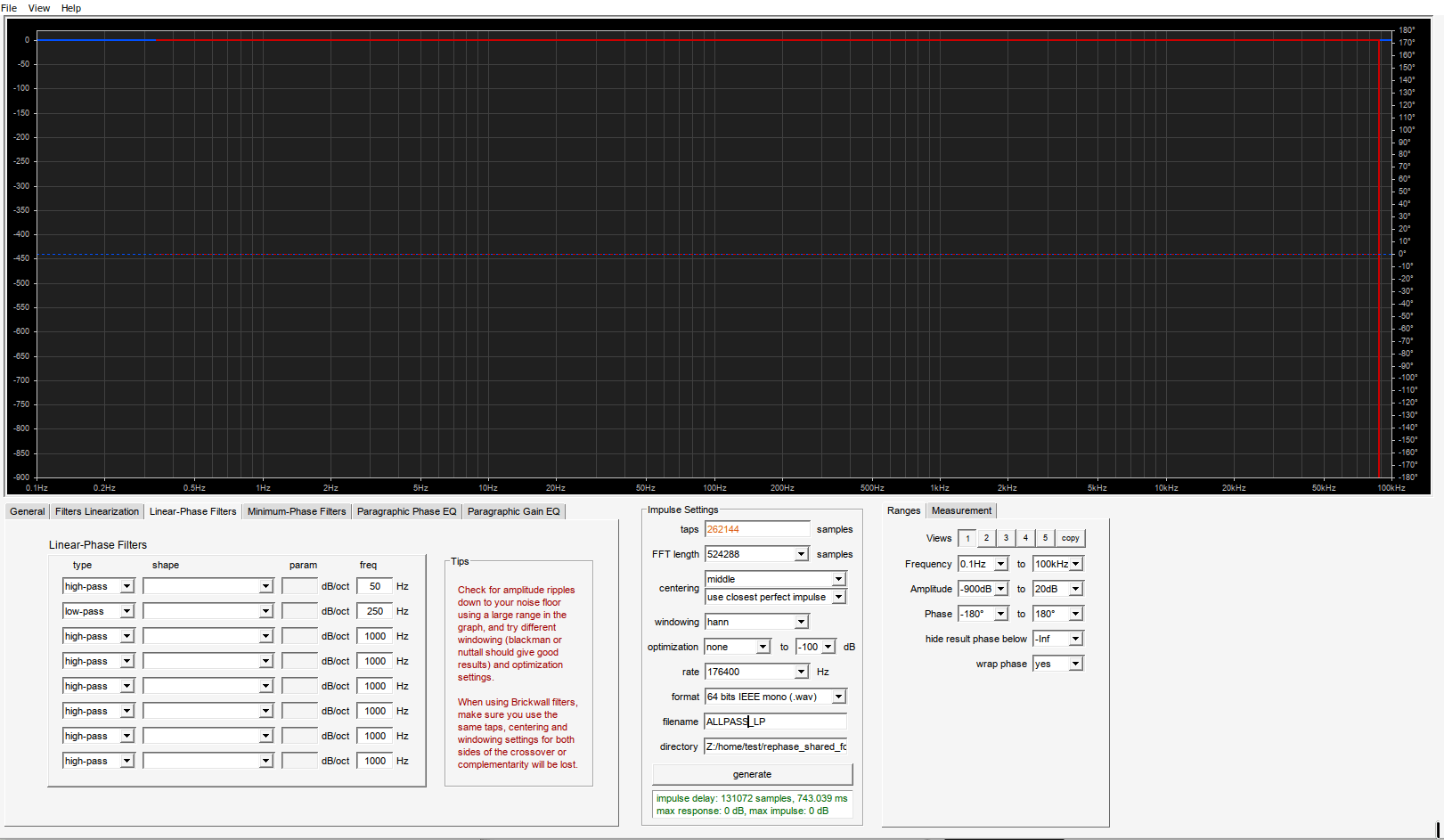

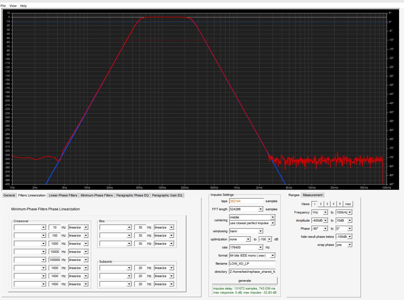

I have a Linear Phase width question if someone would be so gracious to answer.
Using 64-bit IEEE floats, the roll offs appear to extend down to over -300dB, but the corresponding valid liner phase width appears to only extend down a third of that.
Should the valid linear phase width be the same as the valid roll off width on a 64-bit band pass filter ?
Thanks much.
You need to set "hide result phase below" to a lower value, but you might face precision issues.
In any case, the phase at -100dB will not have any impact on your crossover.
Reactions: 1 user
Thanks @pos .
I thought the options in the rightmost panel were for display purposes only, not affecting the filter generation. They do not appear to make any change on the binary data.
I am using the "extended" phase width for some computational purposes. I noticed if I convolve a linear phase all pass filter against a linear phase band pass XO in FFTW, I get some linear phase extension on the low side of the band pass XO, but that maybe an artifact in REW's display.
The "hide result phase below" option gives a better picture of what is going on.
It looks like the phase is defined down 300dB within the band pass.
Is there any reason why phase on the low side jumps 180 degrees and then bounces around 180 degrees instead of bouncing around 0 degrees ?
This explains the extra low side phase extension when convolving the LP All Pass against the LP band pass.
Reactions: 1 user

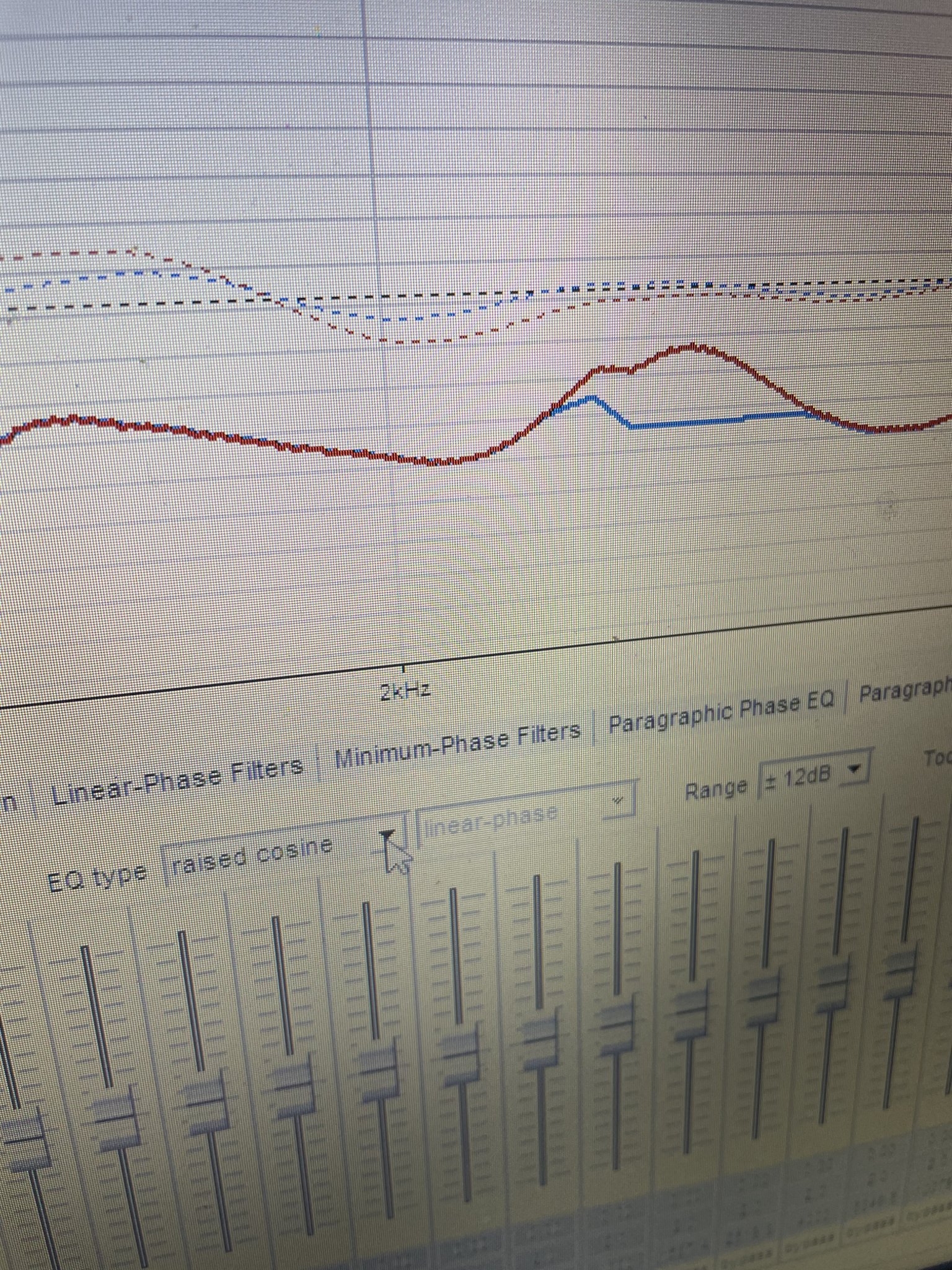

@pos , I have a question on boost eq
If the max amplitude is above 0db , (like using eq boost) and you don’t use the master volume to lower it and use the fir with a positive value …. What happens?
I ask because sometimes I have dips that I would like to add boost to …. And would be easier to do it in fir and keep all channels the same relative volume…
Does it drive it into clipping immediately?
Because of my upstream source has a volume control and I never go to max wouldn’t leave the head room that way?
Thanks in advance
Andrew
If the DSP is floating point you can exceed 0dB and bring the volume down later, if it is fixed point you cannot as it will clip straight away and then bringing the volume down later will just make the clipping quieter :)
Easy to test as any digital DSP clipping sounds like crunch crunch crunch and is truly horrible.
  • Thank You
Reactions: 1 users
Okay yeah just tried it … disaster and for the first time on minidsp I could hear pre ringing
It sounded weird …. Like short echoes…
Okay it’s cool , would be really handy if that bell shape could be done in minimum phase
I added some boost filters in and a whole .84db above the 0db line
Turned it on waiting for the nasties and it sounds good still … whooo hooo … this is going to make things much easier now
The main selling point of raised cosine EQs is that you get a flat response when adjusting adjacent frequencies to the same gain, when Q and frequency spacing are chosen accordingly, eg Q=2.0 for 2/3 octave (the default configuration) and Q=4.0 for 1/3 octave.
I must confess I have never used them in any project myself :D
