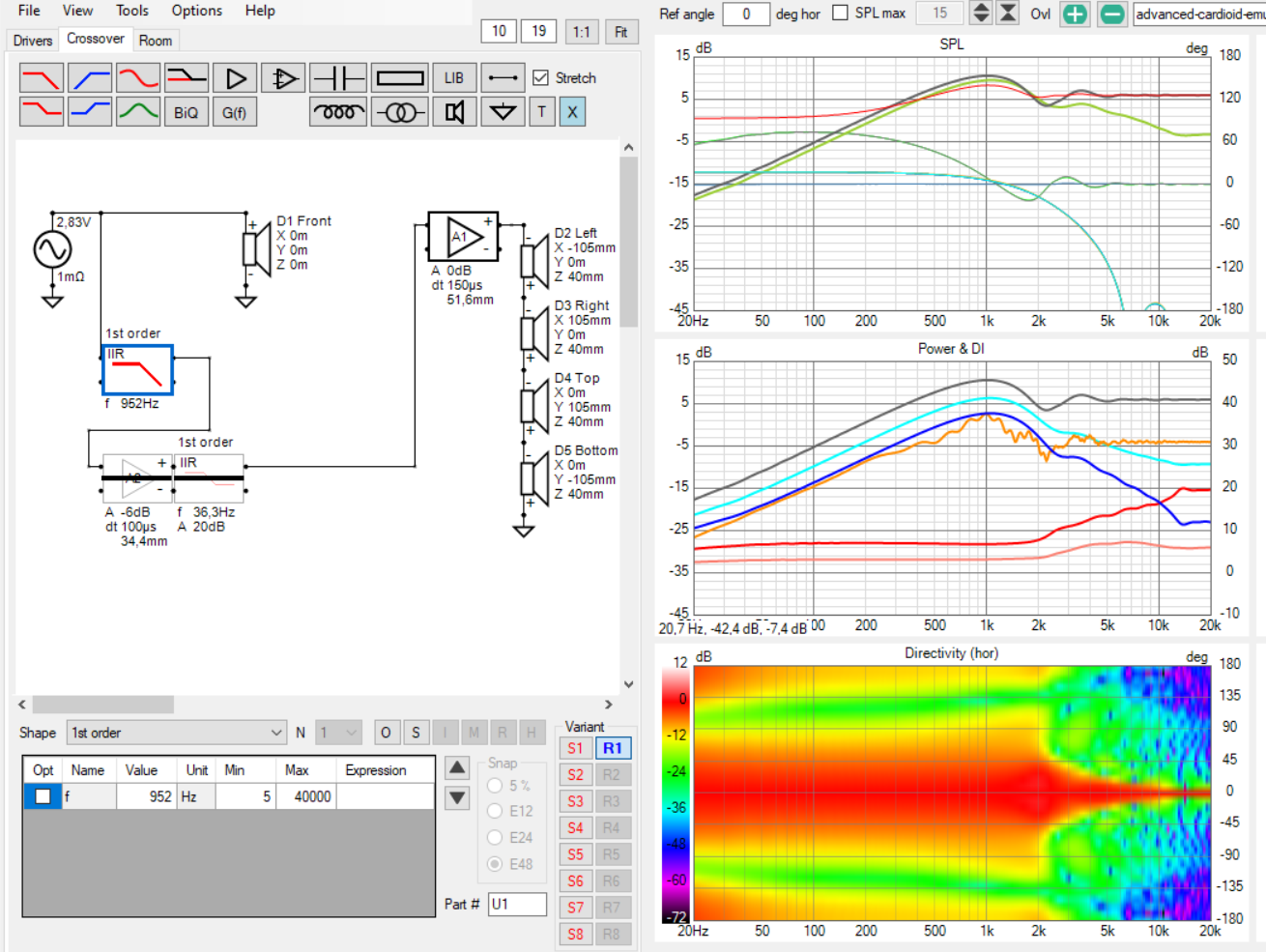

Allright, playing with emulator says I could tighten the pattern of the prototype (higher DI) by compensating the delay due to the inner workings by elongating the path length outside of the box, like 8c does. Wider baffle and port a bit more back. This makes outside path length longer than the inside while keeping square box, also mounting the driver back of the baffle instead of front would make a bit difference here. Both are more difficult to manufacture, but might be necessary to do to narrow the response down.

Ugh, lost lenghty response to power cut.
In short: yes the response is pretty good now, gotta be happy.
I've been talking the pattern names with -ish postfix since the actual name is not very important for practical application. I've got the speakers near wall and toed in 45 degrees so best location for deepest null for least reflections would be somewhere between 90 - 135 degrees.
Dipole response with nulls at 90 degrees has zero attenuation and delay on the back signal and to widen this a bit to hypercardioidish, move the null > 90 degrees, we need a little delay on the back signal but not much. Too much delay (or attenuation) and the response gets wide pretty fast. Cardioidish seems to be pretty easy to get but hypercardioidish I'm not so sure.
It is possible to steer the null in the emulation anywhere from 90 to 180 degrees at will by tuning the delay of the back wave. Hence the attempt to achieve DI > 6dB.
Another advantage of higher DI would be to achieve constant directivity with a waveguide. Most waveguides are about 100 degrees nominal dispersion or less. 8c seems to have waveguide something above 100 degrees. I'm using 80x60 tractrix horn (faital STH100) currently and the system DI is rising, about 8dB where the crossover happens. I'm happy with it but the DI is not constant which would be nice to try out if it is worth the trouble. Exchange to a wider pattern CD waveguide and narrow the cardioid mid pattern a bit and bam, constant directivity to Schroeder
So, it could yield better performance for a given system if we were able to adjust the pattern at will, get the DI above 6dB.
Attached emulation example is simplified ideal model of the bigger measured box with only "acoustic low pass" applied to the back side signal to provide some delay along with approximation of the path lengths in and outside the box. The example is ignoring all other effects like the damping material. The response has DI about 7dB, null ~-25dB is at 120 degrees, 180 degrees is about -10dB down. Nominal dispersion is about ~100 degrees which is off the shelf waveguide territory. This would have about 10dB less sound to the first reflection on the frontwall than the prototype with DI a bit shy of 6dB, quite a difference in numbers, not sure how different it would be in reality
I can manipulate the null angle easily in the emulation. Null changes with acoustic low pass fc, path length difference between the in / outside, and approximation of absorption coefficients ( shelving filter ) and attenuation. Not every phenomenon can be emulated in the VituixCAD with my skills, and not all emulation settings are possible in reality. Emulation was posted around post #233 if you want to try. Change the side port emulating drivers in series configuration, the configuration in the project file is wrong I think.
