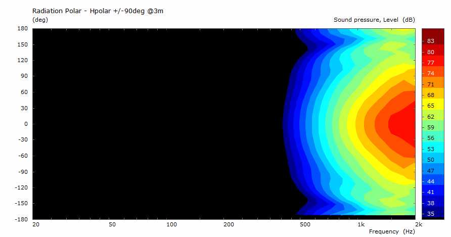

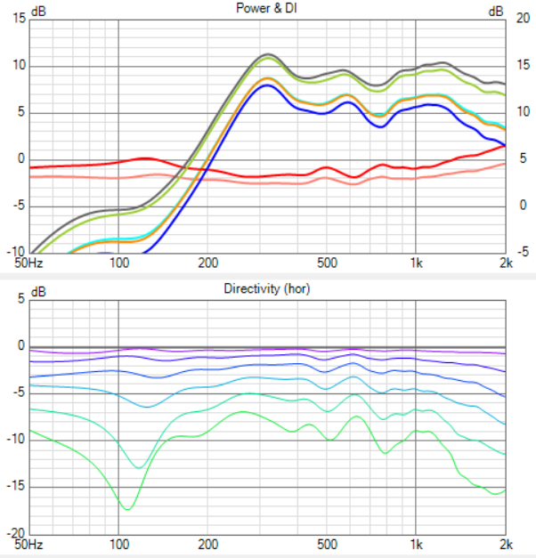

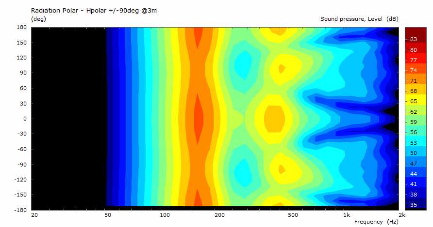

Did some changes on fiberglass stuffing. The waves is now crossing the fiber plates. See picture.
Attenunation at 90deg. is some better compared with post 182. DI is not impressive, but attenunation is now -8-10dB up to port working range about 450Hz.

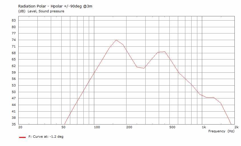

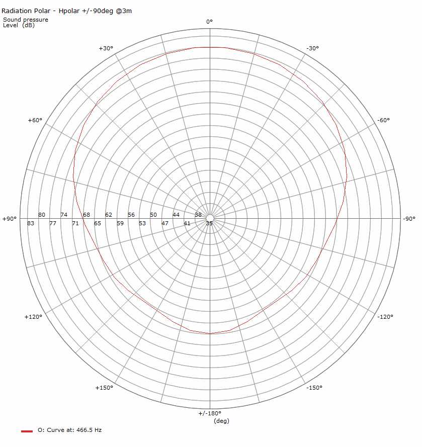

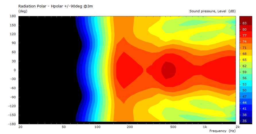

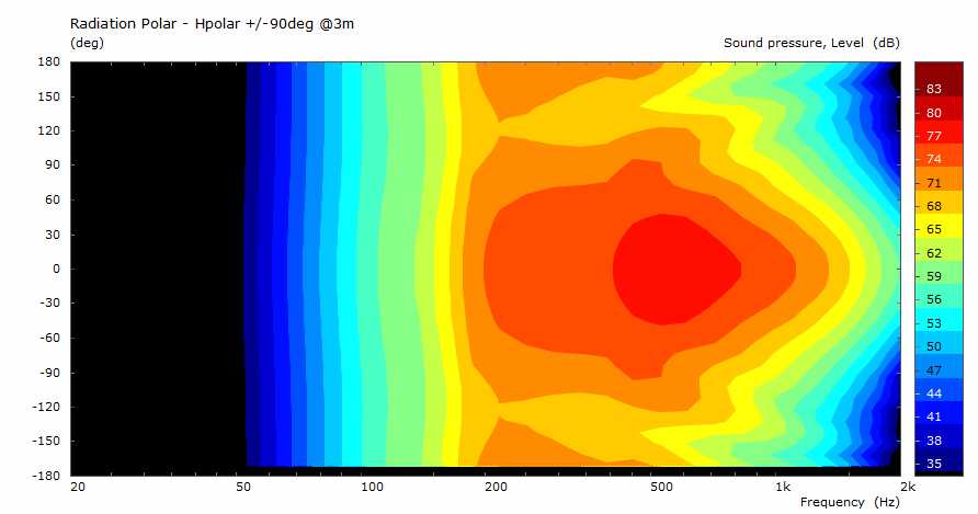

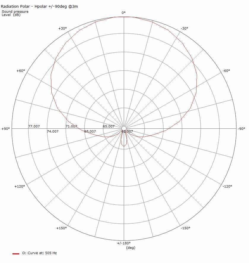

DD C8 V2 - tuning changed
The model subwoofers have been removed as they do not contribute to the midrange DI improvement.
Changes in V2 model. The woofer chamber was reduced to 12L and the port depth is reduced to 40mm in an attempt to raise the box Q and increase port output. The woofer XO has increased to 150Hz to help soften the "Q" bump however some minor EQ is still required. I have added a quick tweeter conic waveguide as I was interested in matching DI at the XO so it can be ignored for now. There is still no resistive material in the port for this model.
I think the model is now acting close enough to what I think is needed. In particular, there is enough port output, and the peaks/dips are close together to be able to smooth them (and add delay) with some resistive material in the port. The woofer will control its own DI >700HZ so we can acoustically close the ports @ >700Hz. That leaves resistive port requirement ~150Hz : ~700Hz. Using pic#8 it looks like 12dB difference between front and side/back at 500Hz.
Next model (V3) will have resistive material added to the ports. Then we can draw some conclusions about using it in a more generic way.

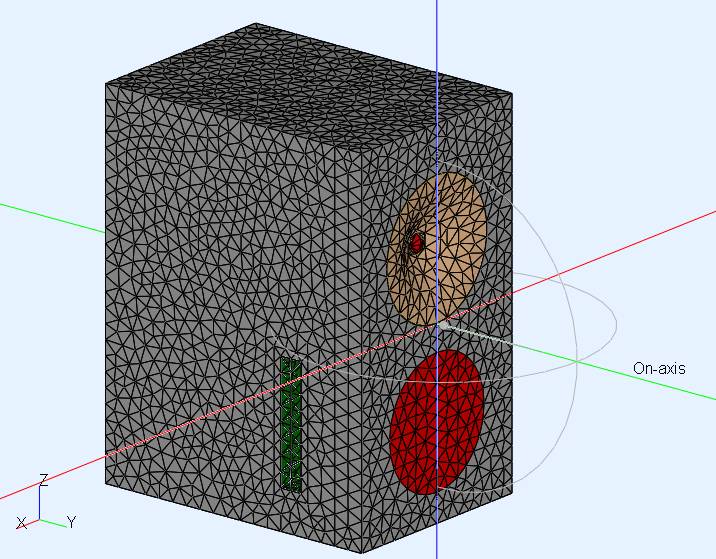

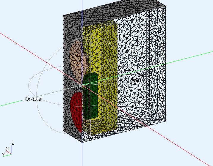

Pics 1,2 : BEM model
Pics 3 : woofer contribution
Pics 4,5 : port contribution, polar then speaker on axis response
Pics 6 : tweeter + WG contribution
Pics 7 : all outputs combined
PIcs 8 : polar radiation pattern @500Hz
Do you think it would be possible to augment the drooping lows with the Q bump? Can you raise it a bit higher in frequency still to the 150Hz region or above.
Hefty EQ boost is needed to get this low frequency output. Which is not that big of a deal in home SPL levels but if there is free output available in the system it should be exploited, unless it comes with worse trade-off.

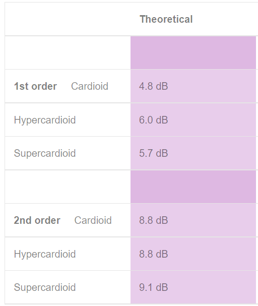

Kimmo has suggested that Hyper or super cardioid could be better patterns to aim for and they have higher theoretical DI.If you are looking for more DI, that wouldn't be "cardioid" and I don't see how it could result from a resistive material and provide constant directivity.
Here is a graph showing various theoretical DI's 1st order cardioid is the same as dipole 4.8 dB.
Interpreting the Directivity Index (DI) - The Hearing Review – a MEDQOR brand
@fluid
Handy table, thanks, and for the link. It's a much better reference than I found.
1st order:
Those are the same numbers I'd found with 6dB as the limit. For cardioid, I rounded 4.8dB to 5dB.
2nd order:
Fine with DSP and a second radiator yielding 8dB DI, or so - that's something I might have tried to match a shallow waveguide.
In the passive/single-driver case, I don't see how to do get more than 6dB DI over more than about an octave. Is there a practicable single-driver solution that can work in the band of interest?

1st order:
2nd order:

As some of you are aware, I'm pursuing an active cardioid in this thread showing Vituix simulation results
https://www.diyaudio.com/forums/full-range/337956-range-line-array-wall-corner-placement-152.html#post6785298
Above 500 Hz, directivity is provided by waveguide plus rim drivers. Someone recently pointed out that waveguide is best cardioid within its pattern control range.
I posted directivity charts this morning showing I'm getting nearly 10 db suppression to the sides and 20 db to the back, if Vituix can be believed. Its a benchmark against which these sims can be compared. I would love to repeat them in ABEC.
I struggle with abec but I've got some basic competence. If I could see your script, Don, I could use it as a template for doing my sims in Abec, thanks. I've got a 12 core Ryzen machine on order for this purpose. It will be fanless and able to run as long as necessary without annoying me.

Thanks for posting the directivity plots. There are a few ways to plot them and the shape depends on which is used (fixed range, data range). I've included the same graph I posted earlier in both formats.
I agree, and I'm just interested in "more out the front, less out the side and back". The precise shape is less important. It's enough just to try to shape it passively Active would be another story.
Very cool data you can pull out with the BEM, if that doesn't help to get the ins and outs of passive cardioid mid system I don't know what
edit. read the text again, the box Q bump appears at the port only? this can't be exploited to boost the lows i think. It will limit the pattern control bandwidth above the Q frequency, right?
Agreed, if you still want to keep XO=100Hz you would need some boost, just like the sealed subwoofers. In this experiment the XO point can vary as I need to understand the mechanism. After its working properly we can try to adjust the range up/down or see what its sensitive to. So XO at 100Hz or 150Hz is less of an issue to me now. The difference might even be related to the driver I picked.
The reason I'm looking at the box Q is that it seems to be the only mechanism to get more port output. If its tuned too low (driver+volume+port) then the wavelength is long and the output will be approx in phase with the driver like a traditional BR tuning.

I just had a look at your thread. I like the idea of active beam shaping as it has more flexibility than passive.
I get very good correlations between BEM models and what I've built and measured. VCAD seems very good but I've never used it.
Thanks for the offer but these models only take about 45min on a older i7-2700K PC. It looks like you have the right machine for Line Array models. If you need help with models, just ask, and it gets much easier after you do a few.

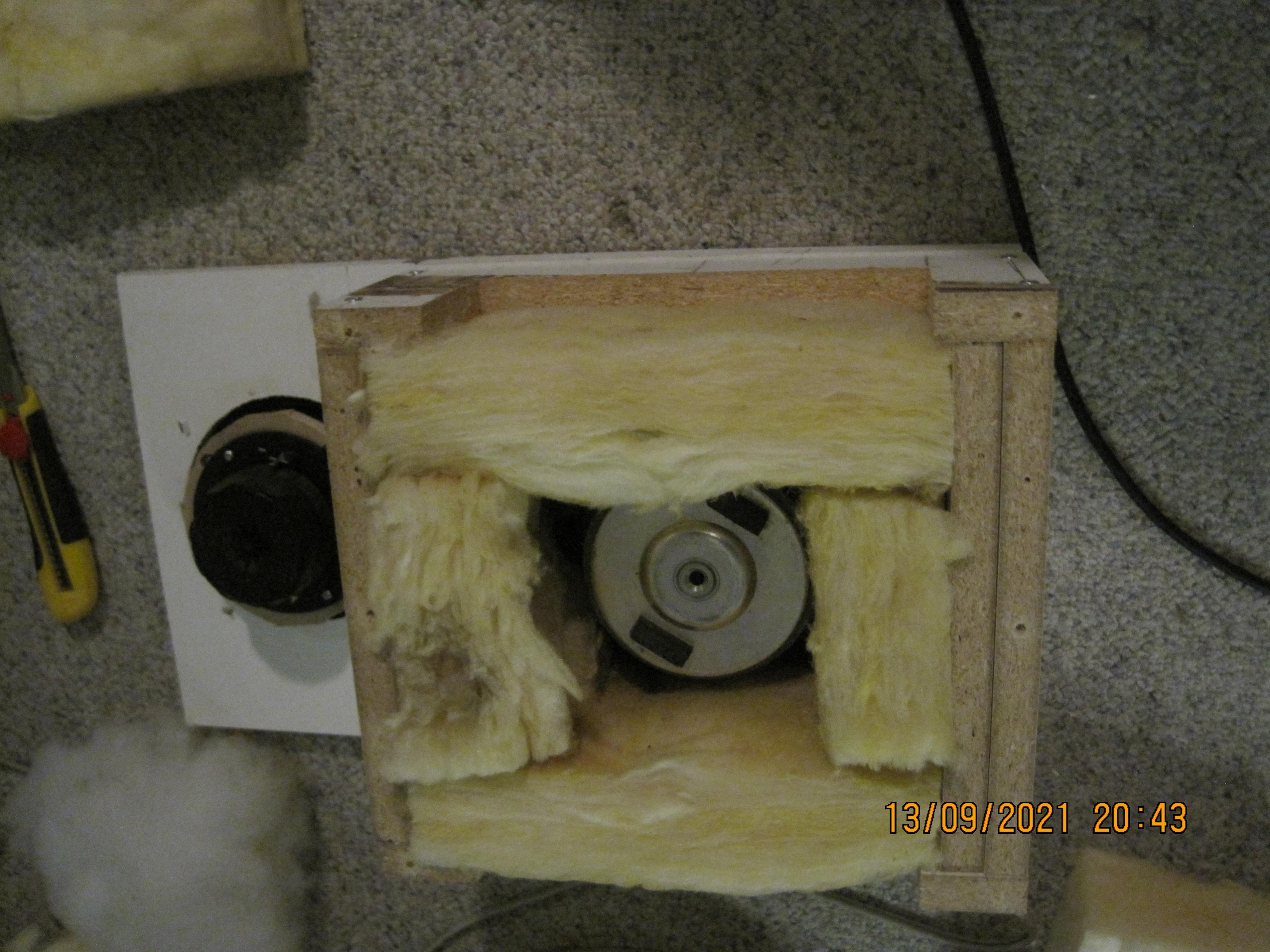

Yeah, main motivator for me to try the leaky box was to get rid of all sort of boxy effects off from the mid driver response, reflections are not good thing here I think. With bass they can be used for advantage but on the mid driver I'm not so sure if there is any benefit. Dipole would have least problems in this regard, but I've read it doesn't work well positioned near wall. Have to try some day though.
