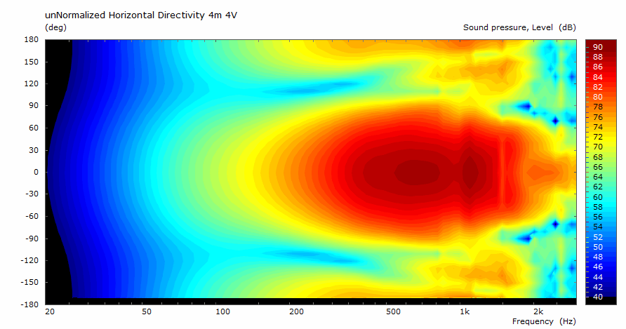

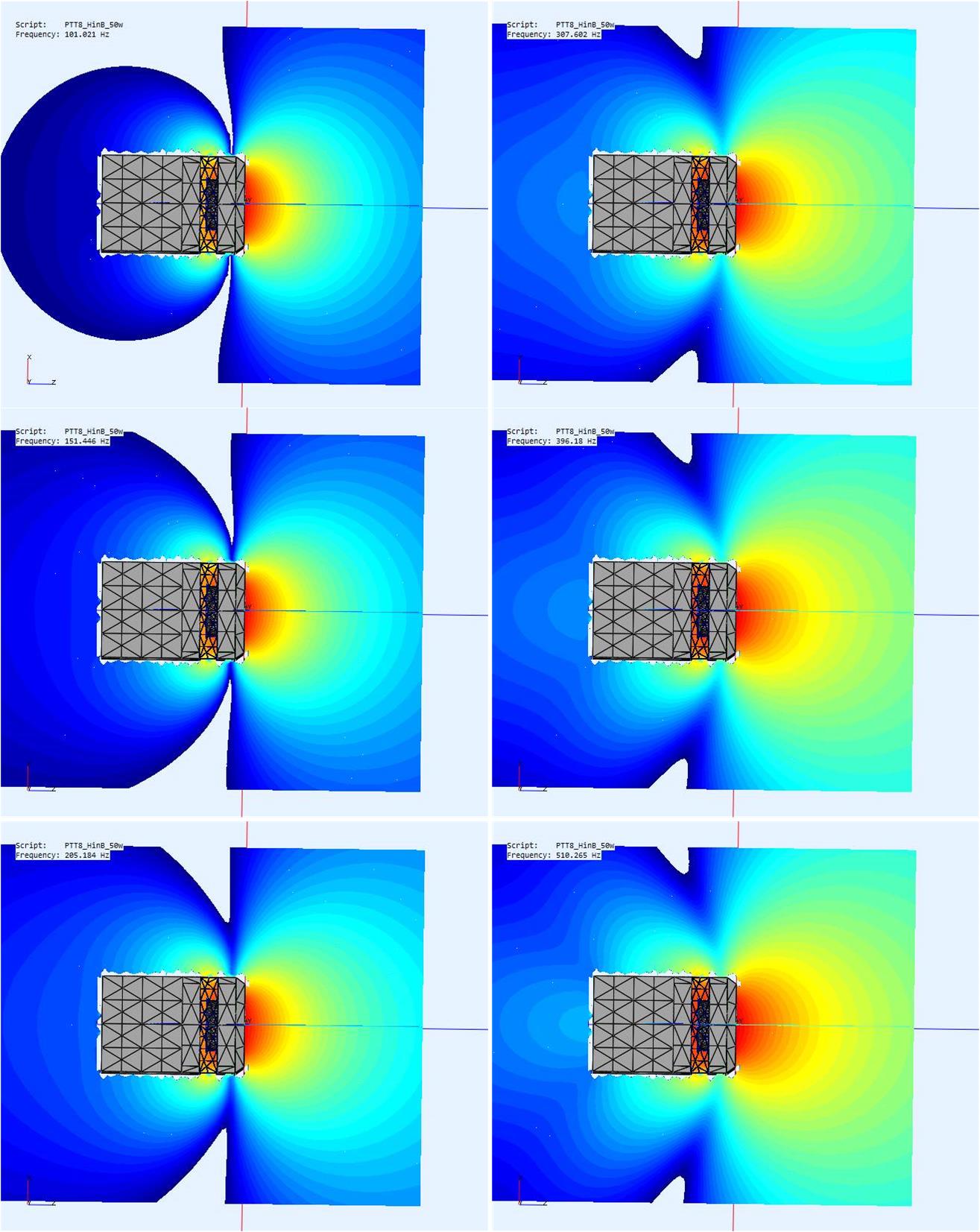

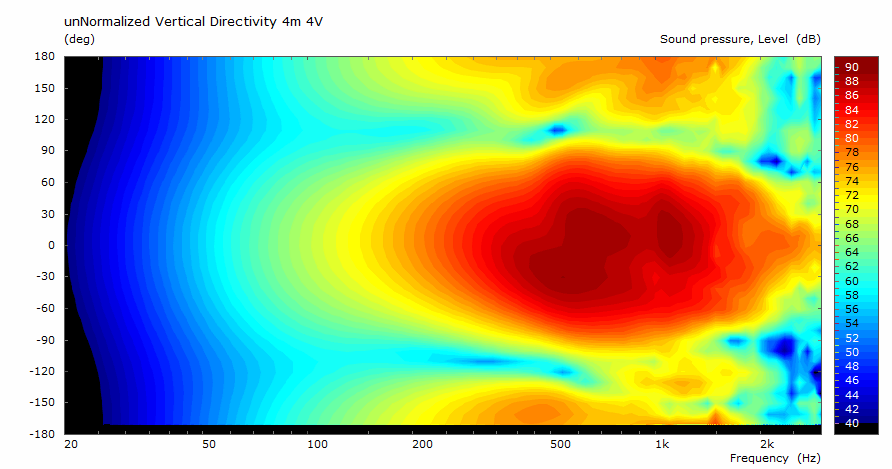

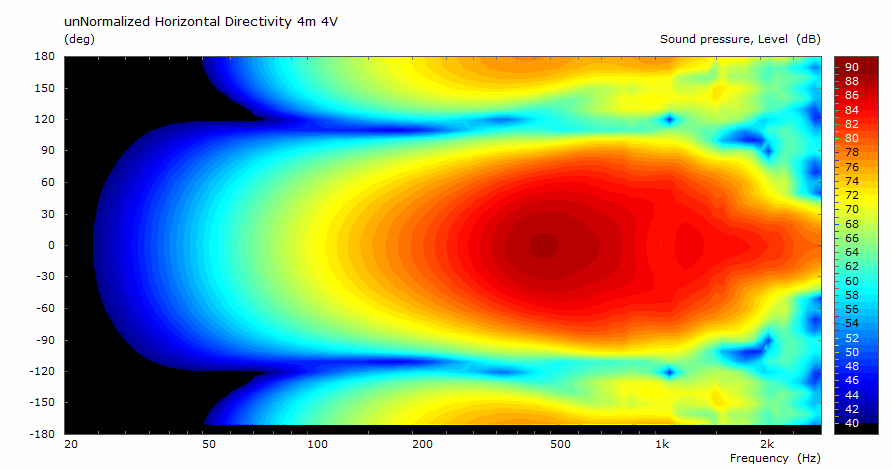

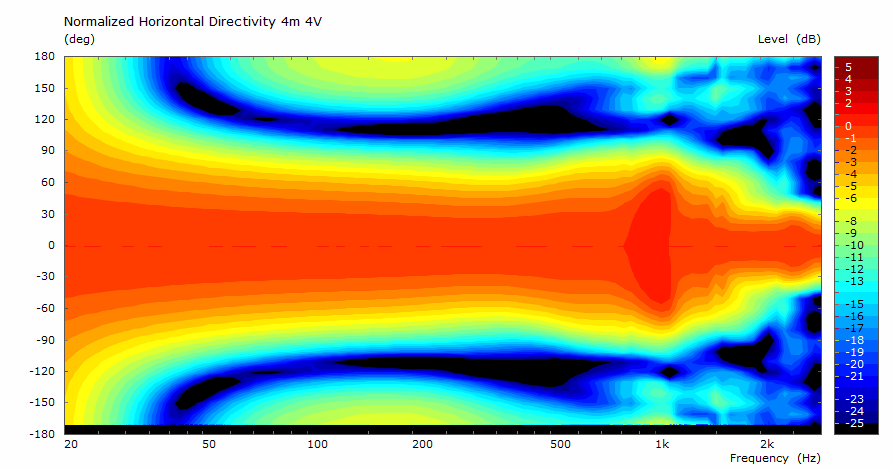

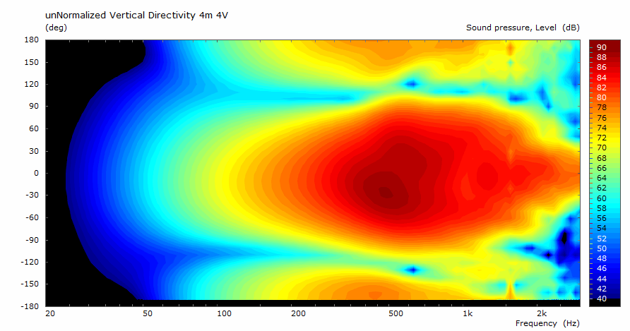

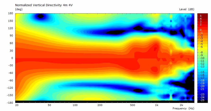

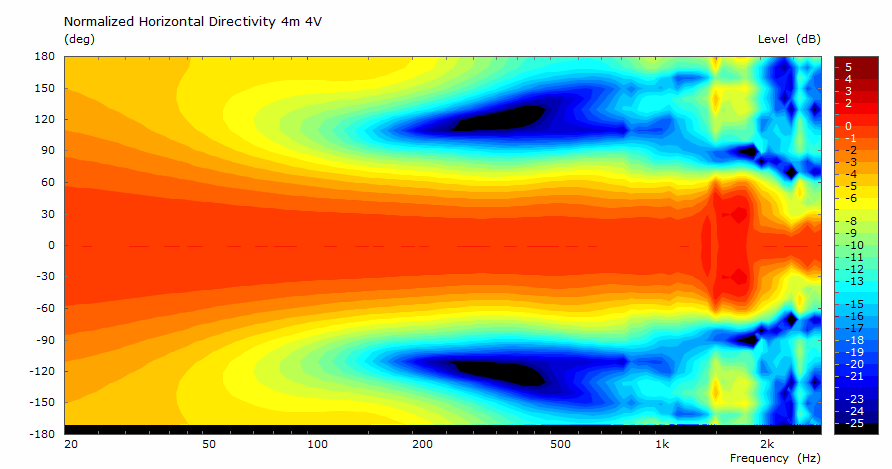

Even so, I have gotten interesting results computing and plotting the fields in addition to the usual polar maps. I started with the ATH round top model but moved to my own nodes-based parameterized model of a rectangular box. This model includes the driver magnet and T/S parameters and allows damping to be applied selectively to surfaces within the model. I followed DonVK's advice as to the damping value and frequency dependency.

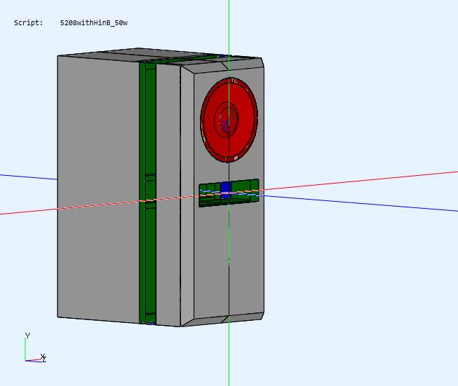

Here is a picture of my model. It will have a radian 5208C 8" coax in the top half, as shown, covering 400 to 1200Hz and a PTT8, not shown, in the bottom half covering 100 to 400 Hz. There will be a 10" subwoofer facing rear in back similar to the D8D 8C. There is a port hole in the baffle that keeps the vertical radiation pattern vertical. It is used by both drivers. The slots and HinB are 50 mm wide'

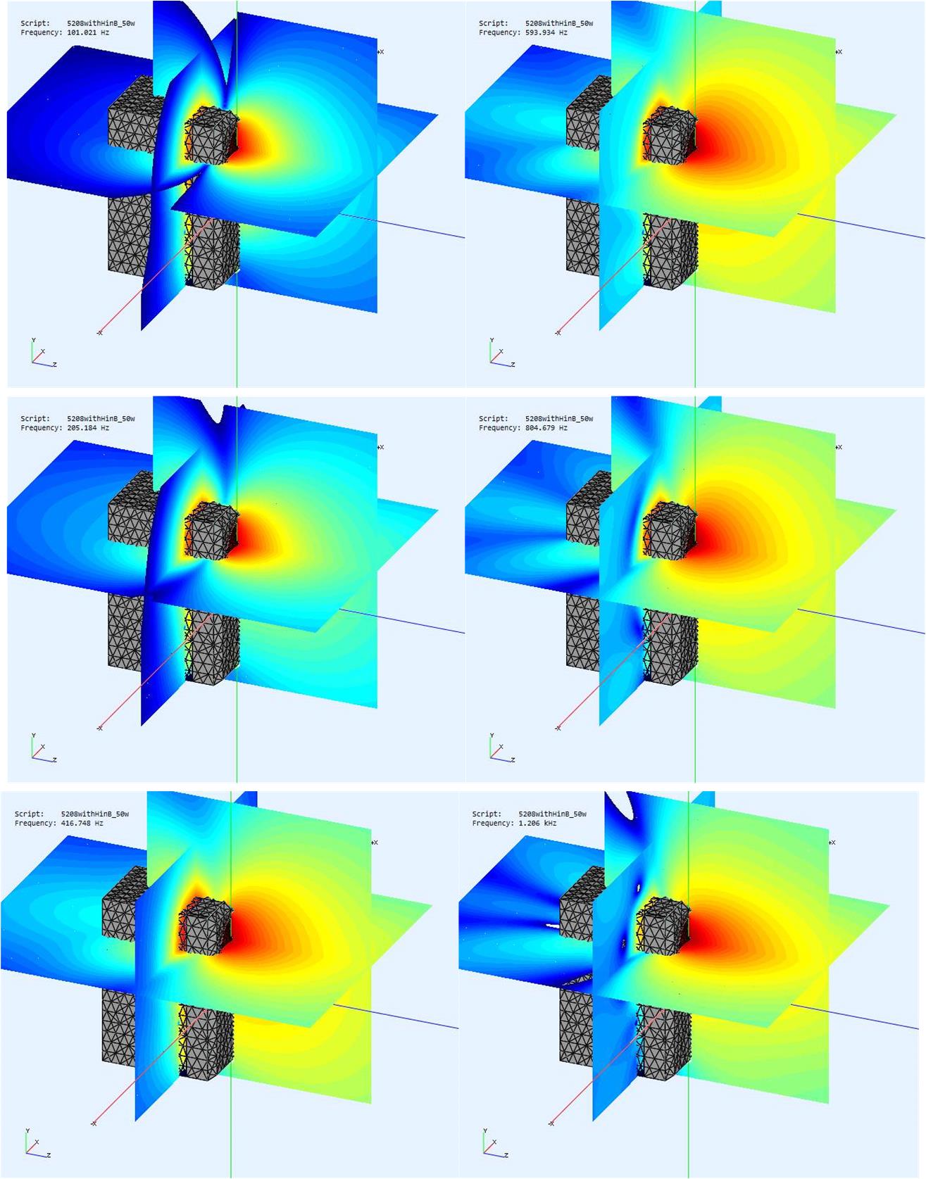

Here are the fields for the Radian 5208C
here are the fields for the PTT8 viewed from the top to show just the horizontal pattern. You can see its got good rear rejection as well as side nulls, probably due to the roll off of absorption with frequency. This isn't classic cardioid but I think its actually beneficial for reducing SBIR in the system simulation and the so-called real world.
These are very encouraging results for me but its still early in the game. One of the things I want to do is implement acoustic low pass filter modules that I can slide into and out of the slots for trimming. These modules will be simple sandwiches of Basotect between plywood and designed so that the only way sound can exit the box is through a fixed thickness of absorber. If this works, then we may get to the point of having predictable results going from simulation to implementation.
![OriginalElements.jpg OriginalElements.jpg](https://www.diyaudio.com/community/data/attachments/1172/1172795-70b9d8f64e047e006224a0ac7df1a798.jpg)
![5208_Fields.jpg 5208_Fields.jpg](https://www.diyaudio.com/community/data/attachments/1172/1172796-0f39a0c9ca7e914cd5023848bde53453.jpg)

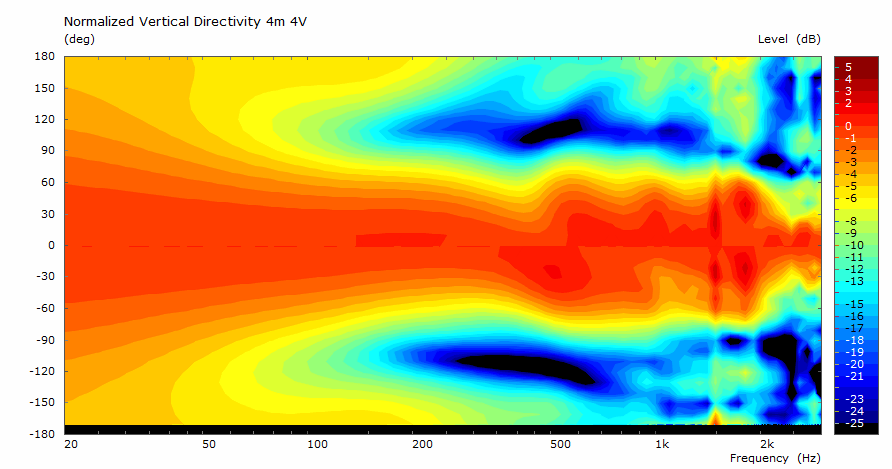

![PTT8_Fields.jpg PTT8_Fields.jpg](https://www.diyaudio.com/community/data/attachments/1172/1172797-80eb0ffc7b2d79a2ca112651b5f14fe0.jpg)
Could you upload its contour plot, please?Here is a picture of my model. It will have a radian 5208C 8" coax in the top half, as shown, covering 400 to 1200Hz and a PTT8, not shown, in the bottom half covering 100 to 400 Hz. There will be a 10" subwoofer facing rear in back similar to the D8D 8C. There is a port hole in the baffle that keeps the vertical radiation pattern vertical. It is used by both drivers. The slots and HinB are 50 mm wide'

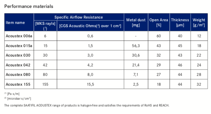

Haven't kept up on this thread to see what other resistive materials you or others may have used since the above.Not sure why enlargening the apertures killed the smooth response. The damping material was now in the apertures = further away from the driver frame with more space for driver to breathe past the melamine first. Less attenuation perhaps, maybe too high acoustic low pass, maybe change in path difference or any combination of various reasons. Anyway, shows that it is not all in the damping material. Hopefully everyone gets their projects tuned in, eventually![]()
David Gunness (Fulcrum Acoustic,LLC) has mentioned "Hydrophobic acoustically resistive cloth as used in cell phone mic protection helps make the calibrated resistive element process repeatable " (around 38:55) in this video:
Dave also wrote:
"The difference between an "aperiodic port" design and our passive cardioids is the acoustical mass of the ports and the amount of resistance. The acoustical mass in our passive cardioids puts a second-order low-pass filter a little below the frequency below which we want cardioid behavior. The resistance is just enough to damp the Helmholtz resonance to "slightly underdamped" (Q of about 1). An aperiodic port design has almost no acoustical mass and is dominated by resistance, so there is essentially no Helmholtz resonance and the resulting first-order low-pass corner is well above the passband; so it operates simply as a resistive leak that damps the sealed box resonance. If you look at the impedance of our passive cardioid subs, you'll see a trace of the double peaks of a ported box, but the dip between them doesn't go nearly as low. That's the effect of the port resistance.There is still significant reduction of excursion around the Helmholtz frequency, and the summation of the rear radiation and front radiation increases the output over about 1 1/2 octaves. If you try to stretch the cardioid behavior beyond 1 1/2 octave, there will be a penalty in low frequency extension and maximum output.
Adding "conventional" ports to the front of the cabinet would essentially short out the rear ports, which would destroy any cardioid behavior."
I don't know if the Fulcrum Acoustic passive subcardioid cabinets use the Saatifil "Acoustex" brand, but they list their list of main applications include mobile phones, microphones, headphones and loudspeakers.
The Acoustex materials specifications include the "Specific Airflow Resistance" in both MKS rayls [Pa s/m] (from 6 to 155) and[CGS Acoustic Ohms over 1 cm2] (microbar s/cm3) ranging from .06 to 15.5 ohms.
No idea how you might plug those numbers into simulation programs, but having heard how well the Fulcrum subcardioid subwoofers were able to control directivity at the 2017 Orlando InfoComm, thought it worth bringing up again.
