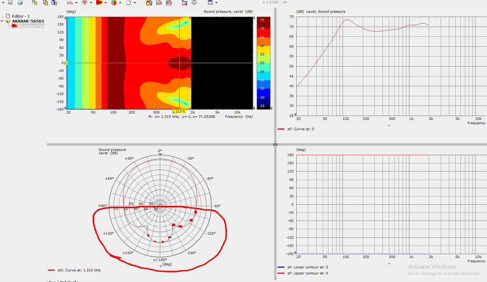

I want to show my experience with a picture. As you know, for an active cardioid speaker, the back driver must remove the back wave produced by the front driver. So, If the directivity plot of the antinoise-driver is the same as the front driver after 90 degrees the back effect will be removed. The plot shape is more complicated after 90 degrees. The reason why I recommend to get an accurate response is that.
If you simulate the projects with Akabak, you will find that the SPL must be equal at all points to get cardioid.

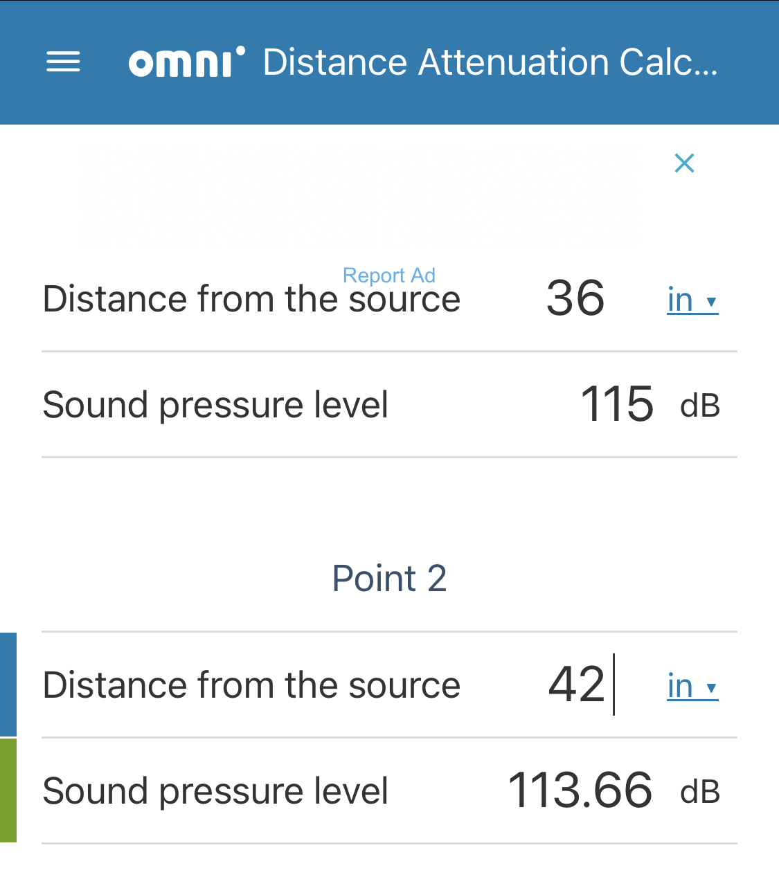

I've never personally came across any studies that were done in a way that I thought respectable can you point me to some please
I can create up to a 6 inch difference between me and the source without even entertaining whatever filter effects of attenuation the shape of my head will create to the farthest ear and you're telling me that I won't be able to hear the difference in about 1.4db.... I disagree
It is only where the room modes skew the distance relationship, that distance is not perceivable
