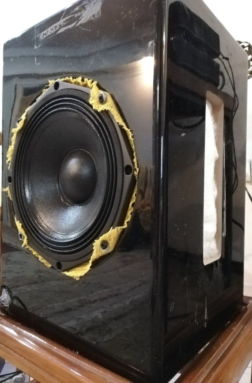

Resistive port cardioid active speaker insipired by D&D 8C
there are for sure old receipes that works !
300 hz circa cut-off is one of the known ones, see V. dickason book.

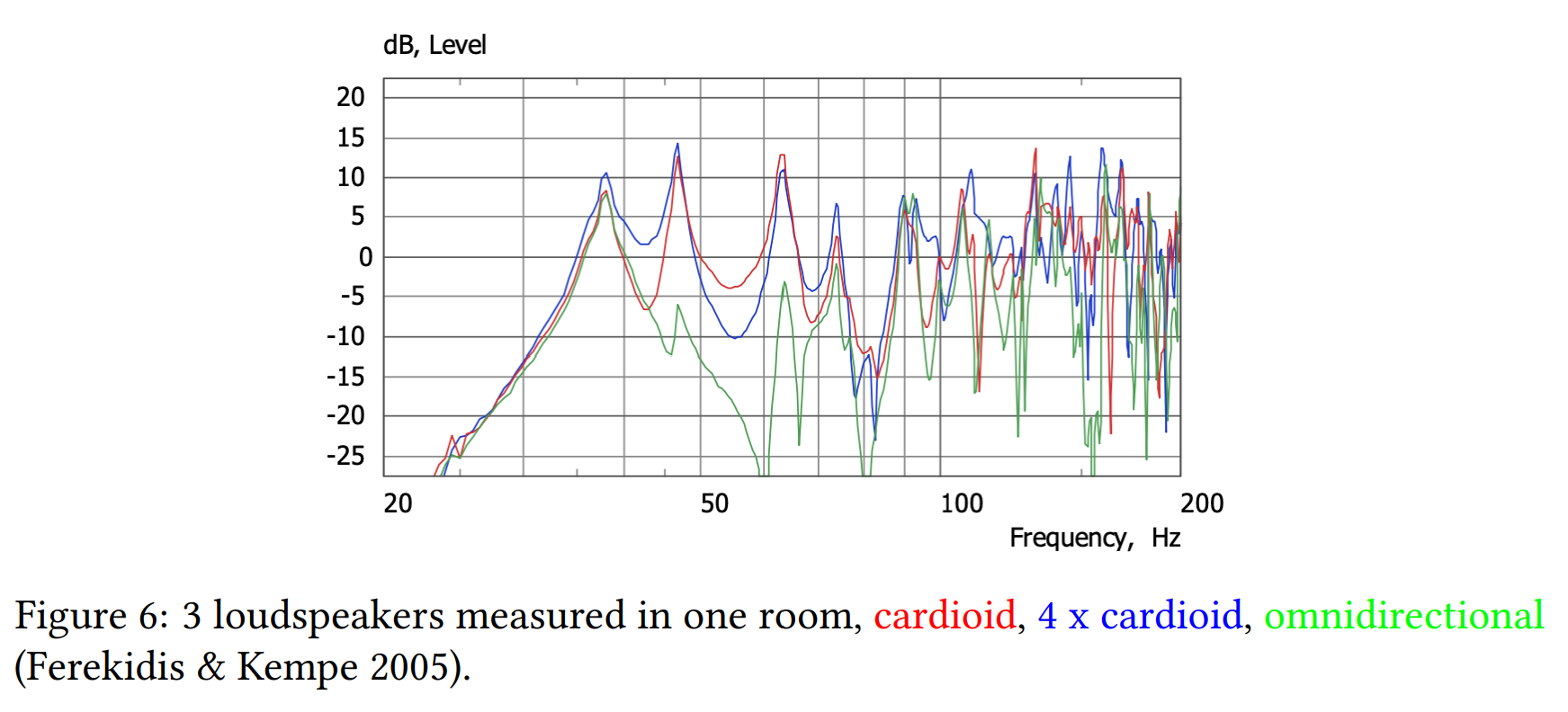

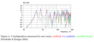

Here's an image containing frequency response from the Ferekidis, Kempe paper. Single monopole, single cardioid, multi-cardioid.
In contrast, companies make DIY products (measure yourself and let the computer do the work) using multi-subs that create a flat response.
I'm not saying bad bass is unacceptable. Humans lived with bad bass in small rooms for decades and no one died from it. But if you're building a D&D 8C then you want to know these things so you can make design choices. Do you try to extend the passive cardioid lower? Do you remove the low frequency drivers from the back and make them independent?
If there are specific use cases for cardioid bass or nearfield then a person might fit into one of those slots. It won't kill them.

https://www.diyaudio.com/forums/att...ioid-active-speaker-insipired-8c-photo_-_-jpg

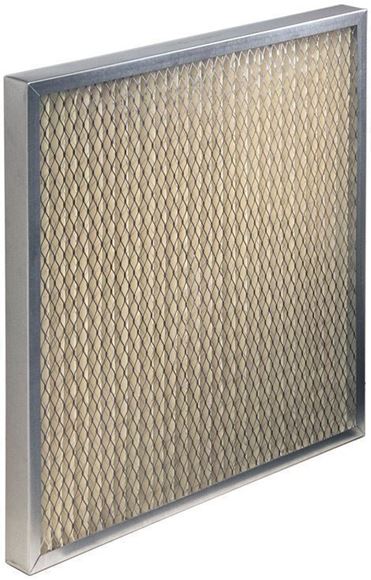

^ There is far to much volume here (and particularly the back of the volume isn't near the driver) and the flow resistance isn't "stiff" (more like just stuffing that's ready to "blow out" of the cabinet).
A good resistor often has wire- mesh on both sides (in cabinet and externally on side of cabinet), and is corrugated/pleated: think "return air filter"..
  • 0001400_multi-pleat-high-temp-pleated-air-filter-24x24x4-6-per-case_580.jpeg
Ex. (in volume (relative to the driver), in rear panel relative to driver (regarding depth), in lower ("rounded") baffle area, and with respect to the flow-resistor's construction)
