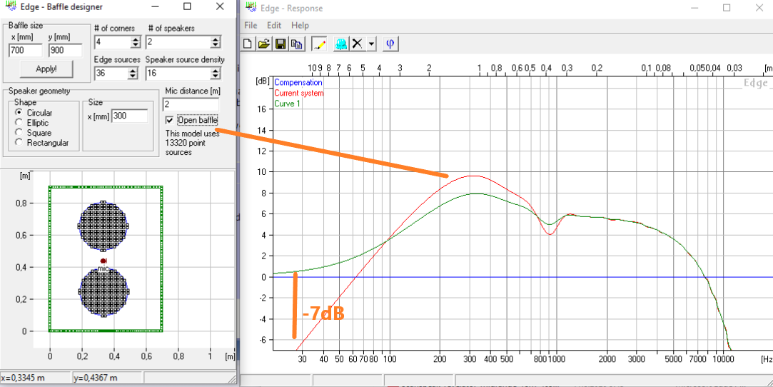

A dipole and cardioid transducer have roughly similar on-axis "dipole loss" of spl at low frequencies whre the baffle lets backwave to meet and interfere with forntal wavefront.
This loss must be equalized to get equivalent frontal spl curve, and at (sub)woofer frequencies this EQ need can be huge and leads to elevated distortion, up to tens of % easily, which is audible. We can see this problem arising in D%D8c's 8" measurements. In order to keep distortion inaudible even for home hifi listening (max 105dB at spot) one must use large high-excursion woofer(s) and hundreds of W amp power.
Here Erin's measurement Dutch & Dutch 8c Speaker Review
And an Edge sim of 2x15" attached

Doesn't have to be huge. For example width of 2x15" could be just 41 cm.

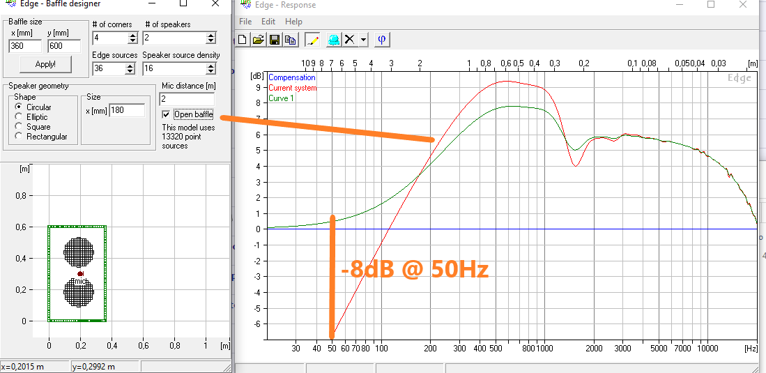

Kimmosto has good points there, multisub wiring is even more difficult than just placing the cabs! Dedicated HT installation is totally different story, and definitely the way I would do for a large HT room. My HT is only 3x6x2,7m (wxlxh) and a multifunction home office/guest room, so three subs was not practical. Two of them were commercial 8-10" BR subs that didn't even put out anything below 30Hz...
Here a 2x8" sim

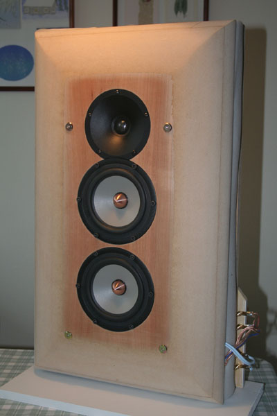

One of the first prototypes of that concept called Domino3. Baffle is obviously too wide for flat DI, but rounded edges help a bit at upped mid.

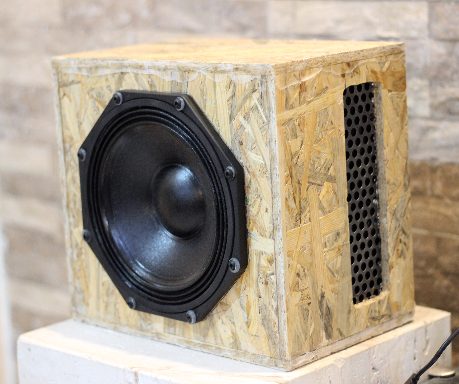

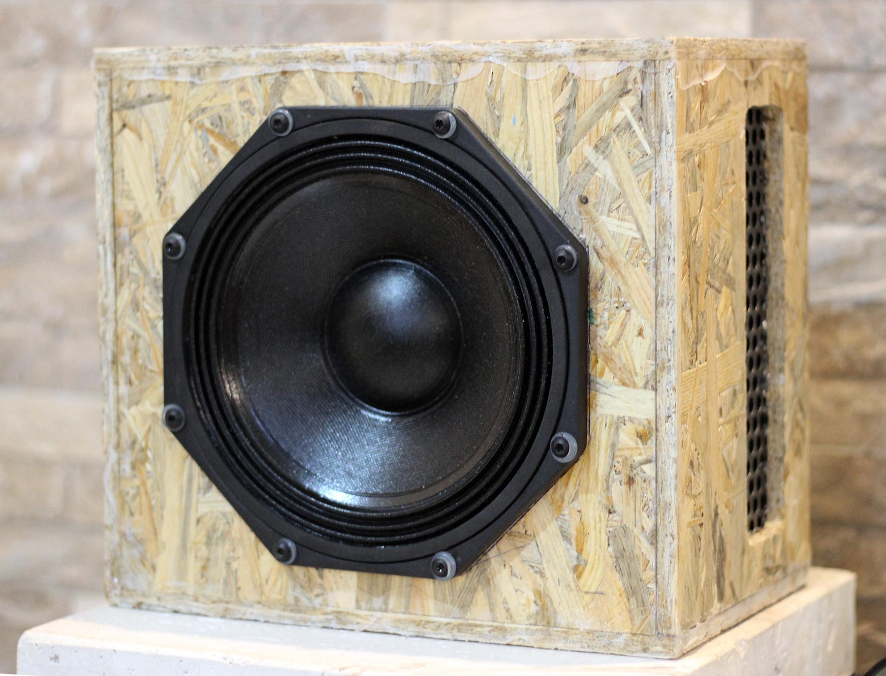

Actually what you see in the picture is outside of the box. I've restricted the internal volume of the cabinet with internal walls. the current dimension (internal) is 245mm height x 270mm width x 165mm depth.
yes, it is a tough job to measure something like this without the room reflections. I'm gonna build a big baffle to flush mount the speaker on it so I can measure both side's responses separately.
I wanted to do the first test using the cabinet I already had and then come up with a new cabinet when I have came to conclusion, so I'll build a new prototype cabinet within a few days.
Could you expand that thought a little? what is the relationship between baffle width and DI?
j.
Too long delay due to distance and not enough low pass in port signal compared to directivity of cone causes dip to axial response -> dip to directivity index.
Optimal position of port and low pass in port signal enable also compensation of too strong directivity of (too) large cone i.e. prevent too steep increase in DI.
I just built the new cabinet using some OSB that was collecting dust in the shop.

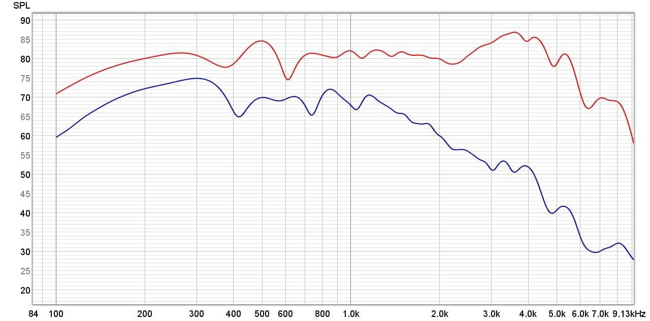

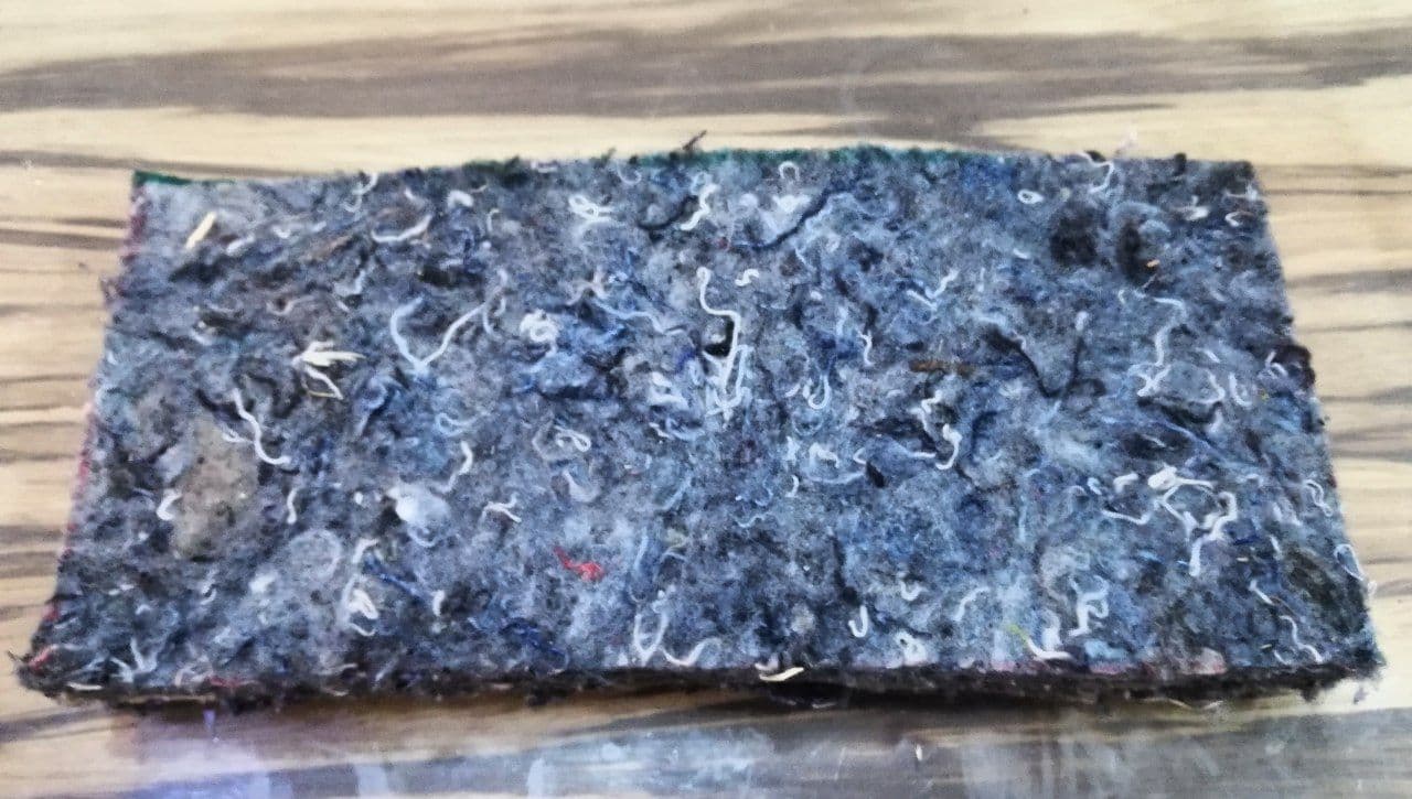

I'm getting better cancellation but I have a problem finding fibrous material with different densities. I used Acoustic Eco felt which is ~95kg/m3 which I think is denser than what I'm looking for. I need polyester fiber felt with a density of about 20kg to 40kg per cubic meter.
This is the result of this felt. on-axis and 180 degrees off-axis:
Edit: this is weird. at 135 degrees there is more cancellation than 180 degrees. it seems more like a supercardioid.

- Resistive port cardioid active speaker insipired by D&D 8C
