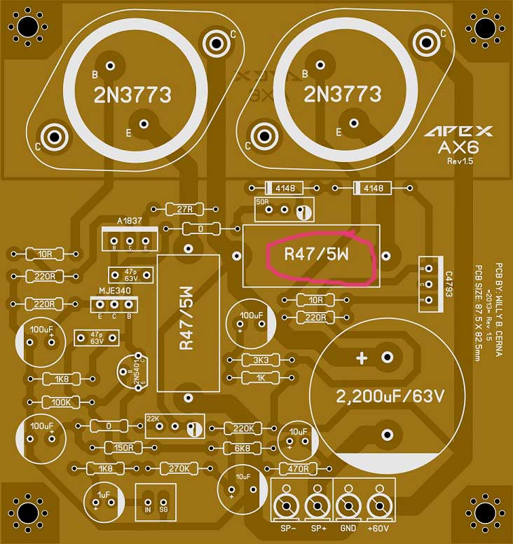

So what should I connect to the PGND of this amp ? My transformer has only + and - wires. I also dont have protective earthing at my wall socket

Per the schematic in post #1, pgnd goes to the main B+ filter cap minus, POS goes to the main filter cap +. I use a 3300 uf for two channels. The + of the main filter cap goes to the + of a 6 amp or bigger bridge rectifier (for two channels). The - of the main filter cap goes to the - of the bridge rectifier.So what should I connect to the PGND of this amp ? My transformer has only + and - wires. I also dont have protective earthing at my wall socket

Measure the voltage to ground on the bottom of the 0.47 Ohms, the side connected to the cap...it will probably be much less than 1/2 the rail voltage...if so the bottom power transistor might be turned on when it shouldn't, or shorted, of there might just be a solder bridge.
I have a 24-0-24 AC transformer. I connected The "0" to GND on the board and 24 to the "+" , then it gets very hot.(don't have time to measure the voltage cause I don't want to burn the resistor)
But when I only connect the positive wire and nothing to ground it doesn't get hot but I get only 0.20v on the resistor
May I'm misinterpreting something...but are you putting AC or DC on the supply rail? It should be only DC.
DC of course, The 0 to GND and 35v DC to +
Apparently it connects the transformer without rectification and filtering!May I'm misinterpreting something...but are you putting AC or DC on the supply rail? It should be only DC.
